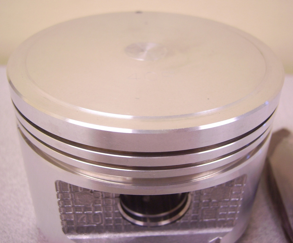

Ok, so I've decided it's going to be a single cam. We're going back to the basics. I've also decided NOT to turbocharge it. Mainly because I want the simplicity. What I'm going to try and do is get back to my original premise when I first had the truck of making a 170hp sohc KA. If I can get close to that power level with NA, I'll be happy. Figuring a camshaft, header, higher compression pistons and/or decking the head. I may do some porting also. Stock compression ratio is 8.6. I'm not going to go higher than 9.5 because I want pump gas.
Interestingly enough, all the stuff online says the early 240sx pistons were different and the CR was 9.1:1 instead of 8.6:1. I thought it was hooey until I looked on my old build thread on Ratsun and Datzenmike had posted a part number for the early piston. And wouldn't you know, I looked it up and found the unicorn. The only problem is I don't see any sets available except 1000-1400 sets on ebay that don't show the right piston anyway. Going to do some more looking, but here's what it is (12010 40F10) vs. the slight dish of the standard piston:
Re: Gracie II the D21
#98
So I looked some more, the unicorn pistons are just that. Arias makes some very nice forged pistons with a 10.8:1 compression ratio. It'd be great for a race motor (drag all motor intended), but it's too high for my use on the street. However, I was thinking if there's plenty of material, I could fly-cut some off the piston dome and lower the compression that way. It seems all the aftermarket pistons are either insanely high CR or low for turbo. I do still have the new turbo laying around that would work, but I'm just thinking non-turbo is the way to go for the truck. I suppose I can always mill the head and raise it that way, but I would prefer to do it via pistons. But with 8.6 + a .040" overbore, I won't be raising it enough to take advantage of the cam and header I don't think. Really, I'd like 9.5:1. It's right on the edge of using swill gas and still not detonating super easily.
