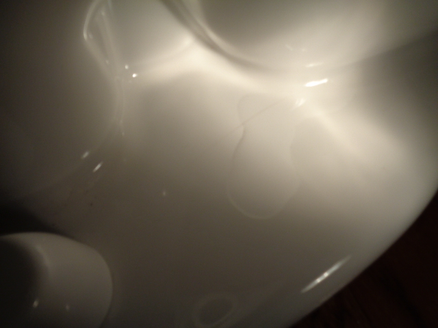

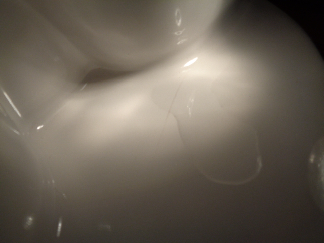

Well it appears the toilet I bought had this very small crack on the base right near the second water trap this kind of toilet had, it was a very slow leak but the crack appeared to go all the way thru and it was leaking under the toilet also, I could hardly get a photo of the crack, but water seeped thru it as you can see in the photos, it was very hard to get photos of the crack as the toilet is white and the camera was getting confused until I put the tape measure near it.
I took it back and got another one, they didn't have any more of the type I bought, so I got another type with only one water trap, hopefully this one will not have any issues, it appears to be good right now, but I didn't notice the leak till I installed the vinyl molding around the base of the wall/floor.

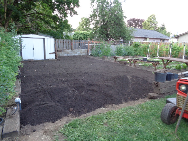

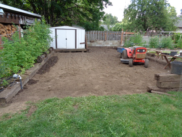

It is ready for the 3 way soil which 13 yards is supposed to be delivered tomorrow, I actually rototilled it after I took the first photo.
I made myself a small blade to level the dirt out in the pile I made that has been decomposing for a few years now, it was mostly dirt which kinda surprised me, I expected less than half to be dirt, so it does work, it would likely work faster if I turned the debris over a few times a year.

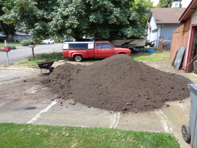

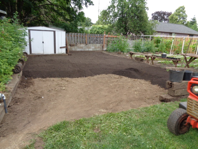

I received the 13 yards of 3 way soil this morning, I forgot to take a photo of the whole pile, you can see where the dirt was on the concrete.
It took a while to get to this point.
I was getting tired and starting to hurt all over, so I came in and looked at the weather forecast, then I went back out and finished getting it in the back yard, as they were calling for a chance of rain.
I piled it high near where the railroad ties will be, I am tired and my joints hurt, I will put the railroad ties in position tomorrow if it is not raining, I believe I started this morning at 10am and I finished up at 7pm, I had to wheel barrow all of it as the trailer would not dump the dirt out properly, it just doesn't tilt enough before it hits the ground, it needs to be higher which is not going to happen.
This was a lot of work, I am happy I don't have to start moving dirt in the morning, I wanted 20 yards but the truck would only hold 13 yards, and 13 yards was just right, I guess I don't understand how to measure when ordering, I thought it would take 22 yards.

This part is done.
Would corn grow fast enough to plant now?

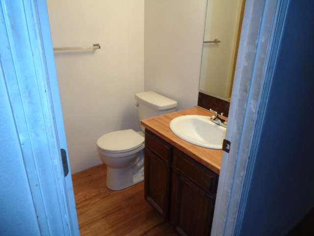

So I have been working on the main bathroom lately, was a lot more work but getting closer.
It's not perfect but good enough for me, I will be putting in a new toilet also, the sink will also be like my kitchen counter tops, hardwood flooring, more on that later.

Well the main bathroom is close to being done, I think I have the sink done and leak free, but only time will tell, I put butter containers under all the places that it can drip, hopefully they will stay dry.
I still need to clean the bath tub, it went unused for several years and is really dirty.

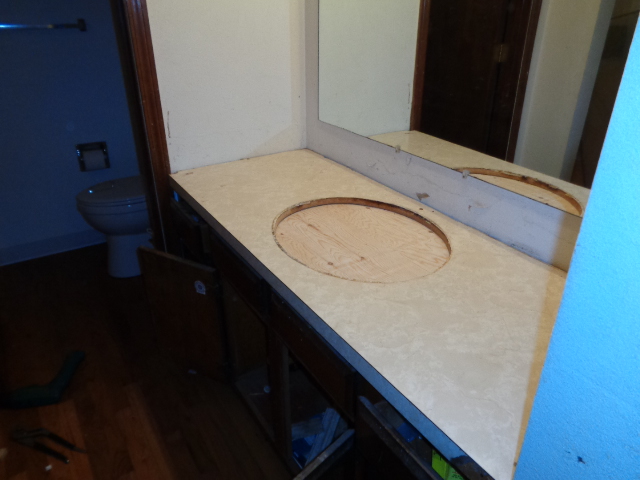

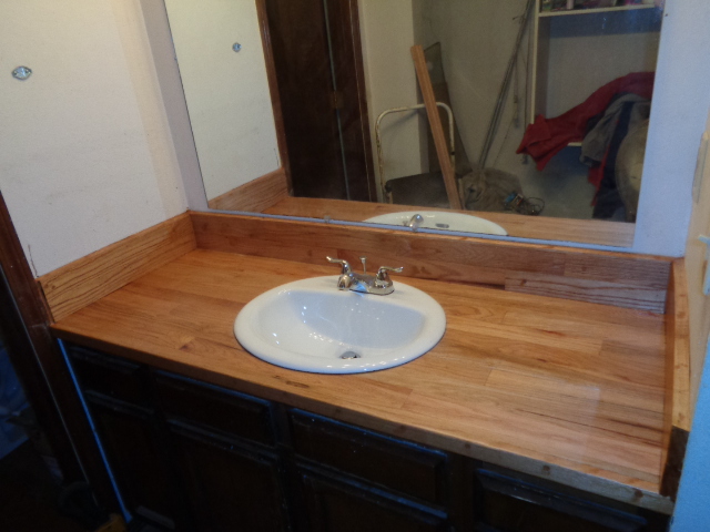

So today I did the master bedroom bathroom sink counter, it had a crusty Formica top that you will see in one of the photos.

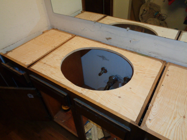

First I recessed 3/4" plywood into the top of the 3 counter sections, the plywood is level with the top of counters not sitting on top, I have to do this so the flooring has something to attach to, I install it the same way I installed the oak flooring on the floors(flooring stapler).
Next I put the old Formica top over what I did to trace the sink hole so it would be in exactly the same spot.
Then I cut the sink hole in the center section.
Then I put the oak flooring on top of the counter tops cutting each piece to match the sink hole, I also filled the holes along the face piece with oak color putty, then I went to the hardware store and bought everything I need to install a new sink like I did in the main bathroom.
I just now put the first coat of wood sealer on, I will get another coat on in 3 hours or so.
Tomorrow I have a job I have to do if it is dry, then I will install the sink and plumb everything, I expect no surprises as it appears to be exactly the same sink I had in the other bathroom, so I bought everything I needed when I did that one.
I also installed new valves, the old ones were hard to turn and didn't completely shut off the water when I closed them, it dripped pretty bad on one side, the other side quit dripping when I used big pliers to close the valve.

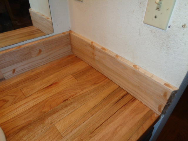

OK, I have been thinking about this since yesterday, I can likely make some kind of oak trim pieces to do the 3 sides around the sink counter, but I am starting to think it might be better with 4" square white tiles all the way around, same color as the sink, what do you guys think?

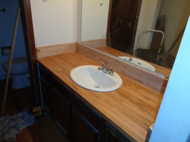

This is what I came up with, I went to Lowes, Home Depot and I could find only one 5" tall tile and it was a weird color, I could get 5" tall using a 3" and 2" tiles stacked one on top of the other but the measurements didn't work out without cutting tiles, so I spent over 4 hours making this and the top caps had to be one piece on each of the 3 sides and the back piece had to be perfect, I only had one more piece that long if I screwed up the first try.
I will likely seal it tomorrow afternoon as I need to have time for it to dry and air out the bedroom so I can sleep although I might sleep better breathing in them fumes.
When I started this I thought no big deal, but after I made the first piece I realized not one of the walls was flat across, not one!!!!, so I thought about it and remembered I had a stack of warped/bowed boards that were likely going to be burned, well they worked great on the sides, the wall under the mirror was a different story, I had to use smaller/shorter boards to follow the wall and the one piece cap was so thin it bent/bowed with the boards below it so everything worked out, if you guys remember I mentioned doing the entryway also, well I don't have enough wood to do that anymore, I will just live with the tile that is there now.

I finished that up last night, it is all sealed, I could not find white tile in 5" squares let alone 5" square with the top edge rounded, the issue is that giant mirror, I was not going to try and remove the mirror and raise it an inch so I could use 6" square tiles, it would likely get broken, and 4" was not high enough to cover the damage done removing the Formica splash guard that was on there 15/20 years ago when I removed the counter when I installed the hardwood floors in every room back then except the bathrooms, if I had done them then there would have been way fewer repairs.
They are done now, I suppose I should have just bought all new vanities but they would just get ruined by me, this way if the house ever goes up for sale new vanities can be bought, and I can use the hardwood floor top in the meantime, my kitchen tops still look fine.
