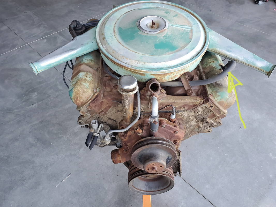

Got it home after a little drama. Got it mounted on a stand and stripped the accessories off of it. Pulled the plugs to spray some WD40 in the cylinders and it turned over immediately. No breakaway, no rough spots. I rotated it about 10 revolutions and it was smooth as can be. Looks like I might have a good starting point after all.

So that hose you have an arrow pointed at goes to the manifold?
Or does it go to the air filter housing?
Re: Grandpa Car
It goes to the carb base. The breather on the opposite side goes to the air cleaner.

Yup. That would be for the '55-67 engines that had the draft tube in the back and the fill tube up front. They didn't have holes in the valve covers until '68. My '66 327 has a PCV that screws into the fill tube but has a breatherless cap. The draft tube actually went to the air cleaner instead of down the back of the engine but I think that was because it was a California car and had A.I.R. too. There were exceptions to lots of rules in the mid 60s as they were adding emissions components depending on where you lived.
