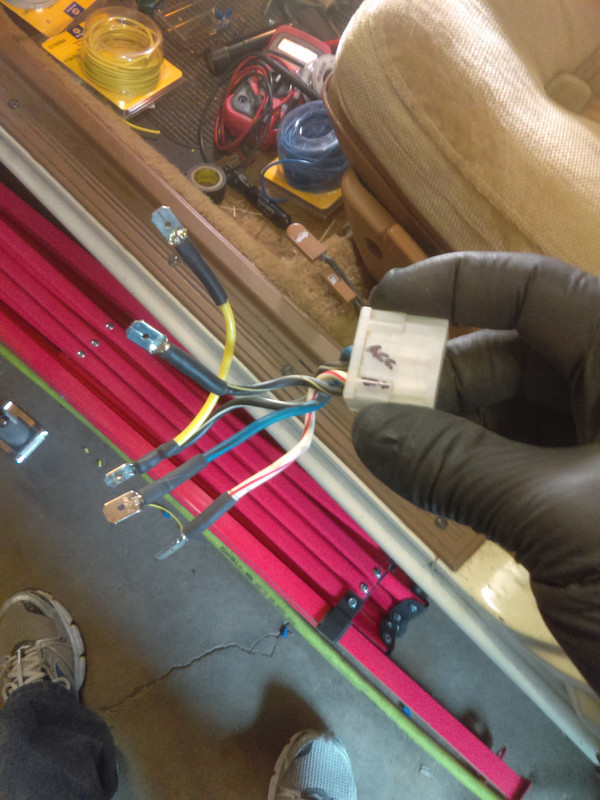

Made a jumper harness for the ignition switch so I can keep the original car wiring intact while supplying the new wiring specialties harness it's needed signals. This way I didn't have to cut or use scotch locks for the interface. Went to pull and save and robbed the connectors for the ignition switch and turn signal for a spare, then just added a spade onto the ends to plug into the original harness. The scotch lock in the picture was previous to my doing. I only use those damn things for initial testing, then it gets soldered, or at least heat shrink butt connected.
