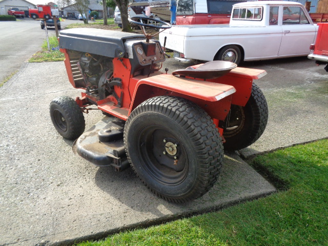

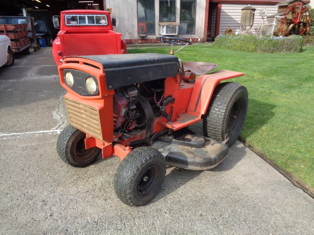

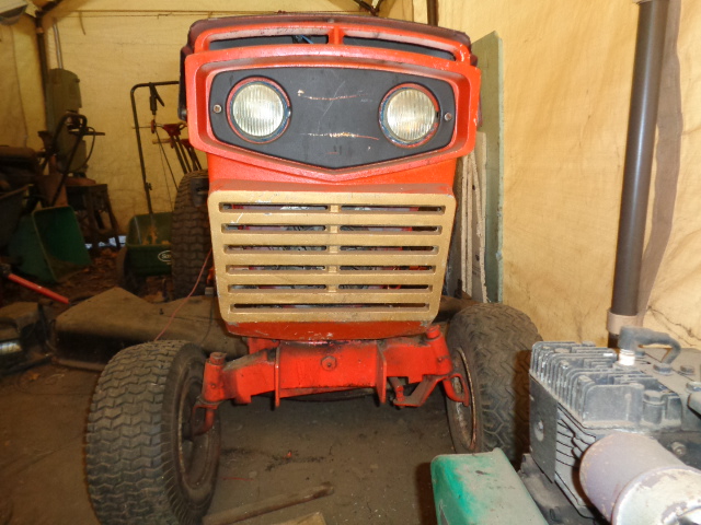

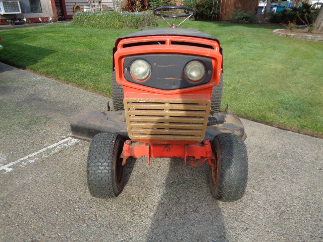

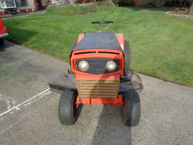

I got the engine part of the tractor finished today, I have it wired so I can start and stop it from the seat except the first cold start as I have not even looked at the choke, I am using what it has and likely will continue to do so as I have to lift the hood and turn on the fuel anyway, I have always turned off my fuel on my pressure washer engines because one time I found an empty tank when I knew it was not empty, it was in the crank case, I have turned it off since as the pressure washers bounce around a lot in the trailer.
I also figured out it was not charging, so I wired it so now it is charging, I have not really figured out what I wired wrong.
I likely will have to do other things but it starts and runs and I can move it, I also didn't change a thing on the engine, it can be removed and be put on a pressure washer, it had been sitting a few years and as time goes by it gets harder and harder to start, so now I can start it whenever I want and mow the lawn if I want to, well in the back as I cannot get it out front unless I move 2 vehicles.
Here it is, I will get better photos when it is outside one of these days.

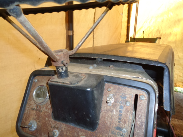

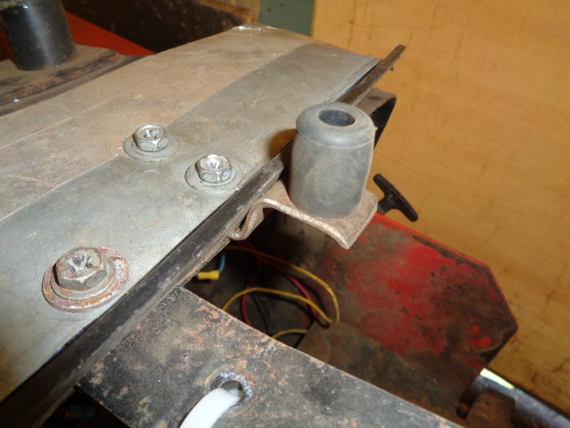

You can barely see the hood bumper I made in the closed hood.

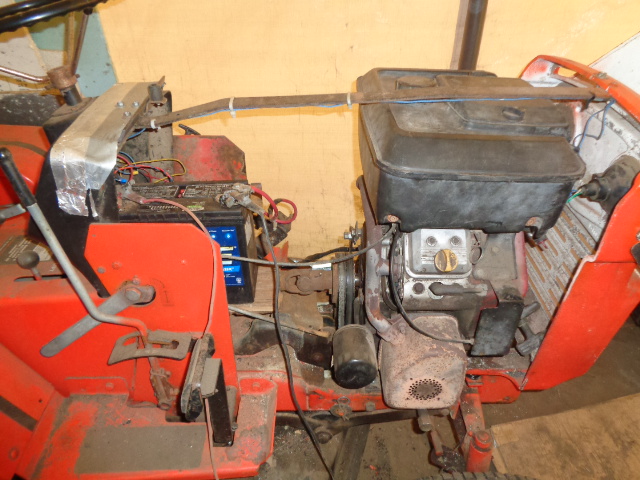

Here is the engine compartment.
Here is the guard I installed after a slight modification to clear the oil pump pedestal.

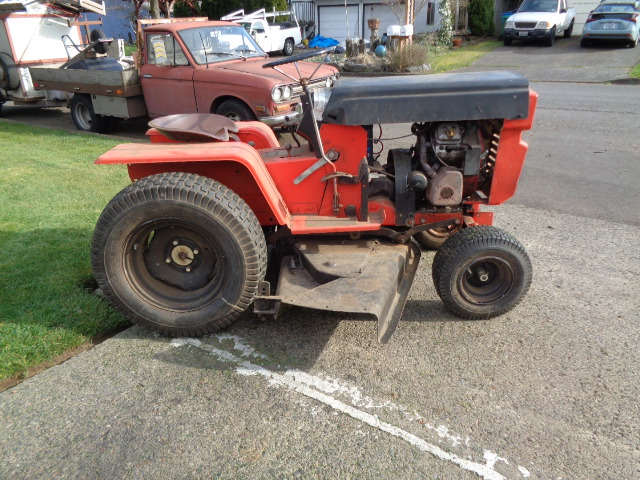

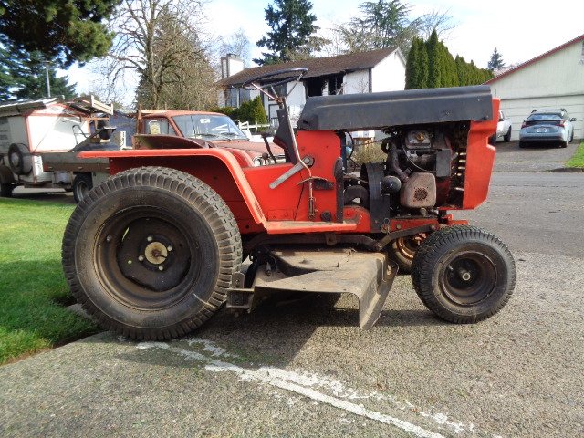

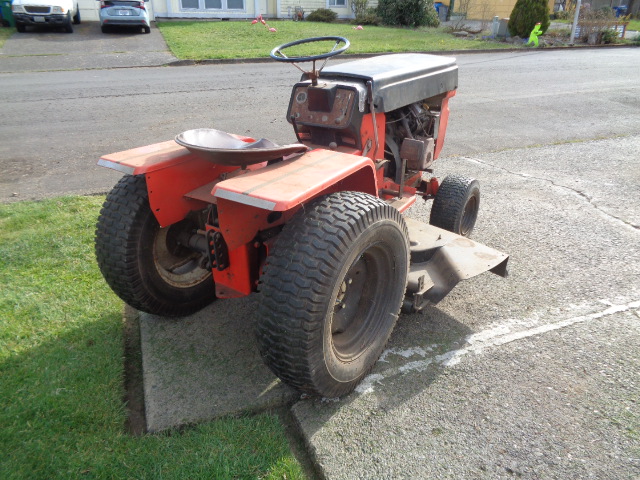

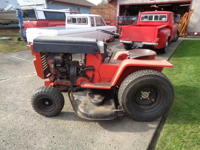

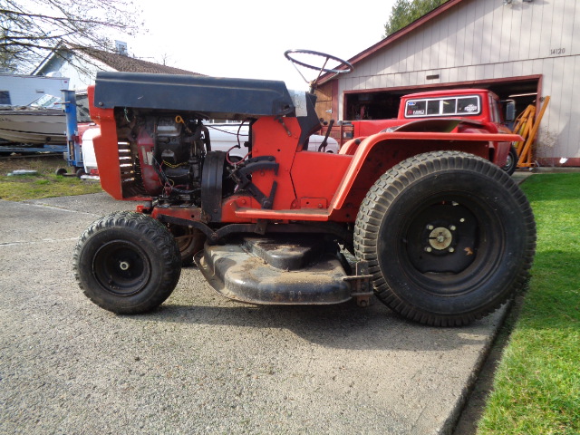

I mowed my lawn and my neighbors lawn today, I was not very good at selecting the height and ate into the ground a few times, while he and I were talking about how it would be nice if I had some kind of gauge to control the height of the deck he grabbed this mechanism I had tried moving before without successes and moved it with 2 fingers, I looked at it, started the engine up and moved the deck up and down and this finger hit that mechanism, that thing was the height control, problem solved by the neighbor.

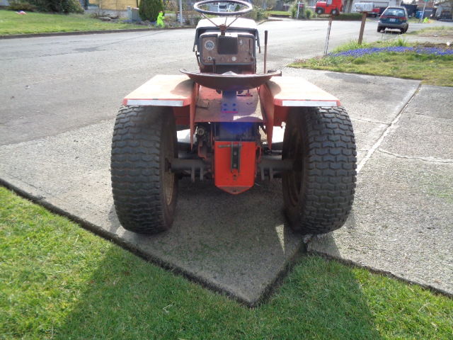

Here it is in the driveway, it's not the prettiest thing out there, but it will mow the lawn and move a vehicle around that doesn't run, I also have a trailer for it.

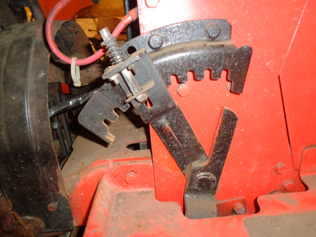

This is what controls the deck height when it is lowered, I tried once to move that thing with the spring but it would not move, he moved it with 2 fingers.
I could not get the blades to not turn when the engine was running, even though the drive was not engaged, it is likely a engine height issue, I have the engine mounted maybe an eighth inch too high, well I suppose I could lower it with a lot of effort, but there was a 1/4" hole in the deck so I dropped a long gutter nail thru the hole and now the blade on the right side rests against the nail and now none of the blades turn so that will work for me, remove the nail to mow stuff, maybe there is something on the tractor I have not seen yet that locks the blades, I will have to look closer when I get the chance, I am working tomorrow and it is supposed to rain, I don't want to lay in the mud, the nail works fine right now, it doesn't even effect the idle RPMs.

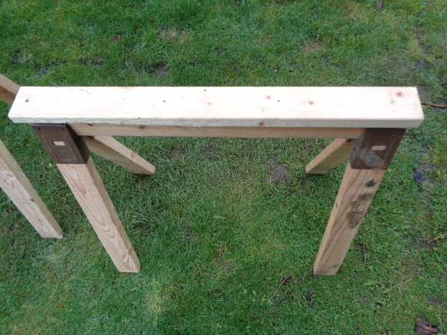

I picked up some scrap wood from a building site less than a month ago, decided to make a couple saw horses this morning/afternoon, I made them fold-able for easier storage.

I worked on the tractor again today, my issue was the lawn mower blades would not quit turning(half speed) and it annoyed me, it also made it hard to start the engine as the drag made it turn over too slow to start when cold, so I lowered the engine around a quarter inch which would be a half inch on the belts, it worked great, the blades do not turn anymore until I engage them with the lever like it was made to do, it is also a lot quieter.

I have always needed saw horses, but I seemed to always use them for something permanent and then they eventually rot outside where I am using them, this set is going to be kept available so I don't have to bend over and work on the ground like I usually do, when cutting a 2X4 or pieces of metal I prop whatever needs cut on top of a 2X4 so the blade doesn't hit the ground, I am tired of being bent over to cut, measure, mark, but I suppose it is exercise doing squats all the time.

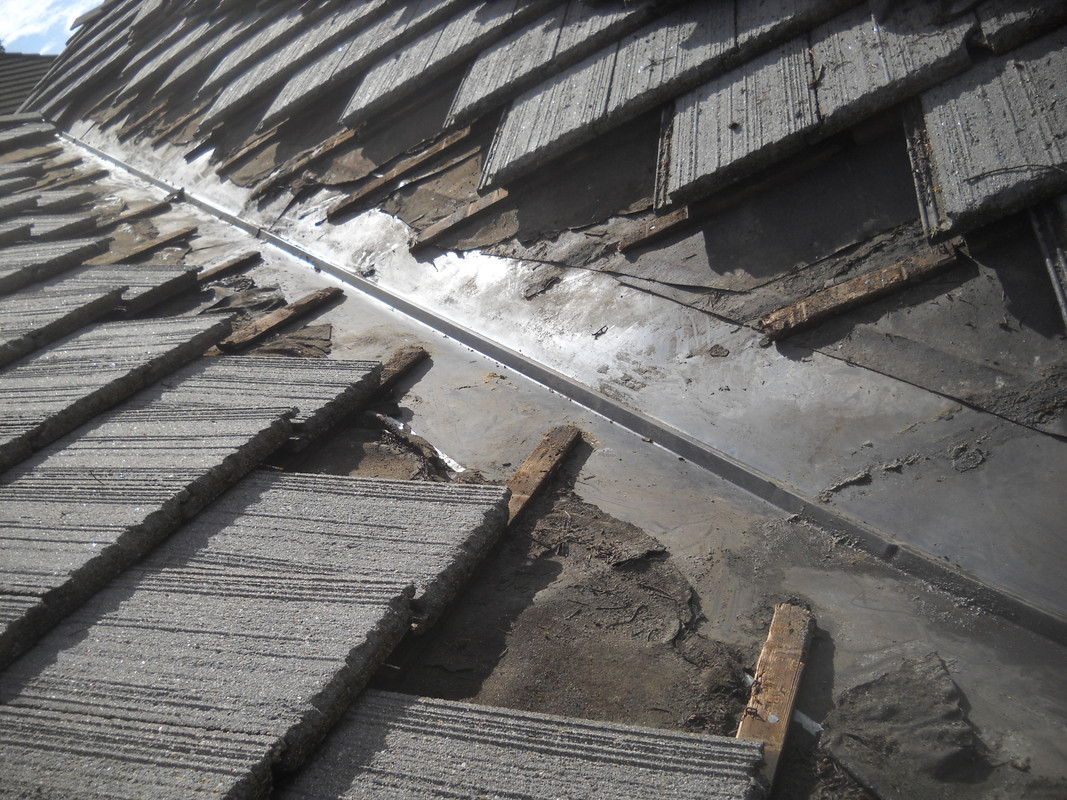

Yesterday I replaced some tiles on one house, then I went to another house and cleaned out the gutters and treated one spot under a gutter that empties onto the lower roof, then I went to another house and lifted all the valley tiles(4 short valleys), cleaned out the flashing under the tiles and then put it all back together, then I cleaned out all the gutters, then I went to another house and inspected/looked at the moss issue on the roof, they had been treating the roof themselves and everything up there was dead, I cleaned their gutters out and was done for the day, I didn't really make much money, I was gone for maybe 4 hours total.
Here is a lifted valley that is cleaned out.
Here it is put back together.
Here is one I really tore apart in the past.
This is what happens underneath the tiles, fir needles and mud get backed up on the tiles sitting in the valley and when it rains the rain water gets diverted out of the flashing onto the felt paper, eventually the felt paper gets wet and dries out so may times that one day when it dries it shrinks and cracks and then rain water can get thru the crack and into the house and stain the walls and ceiling, or worse the ceiling falls down onto the floor if the leak was bad.

I used to be able to do that kind of stuff all day, I roofed my own house 7 or 8 years ago, it took me 2 weeks and 2 days to tear it off, replace bad plywood and put the new roofing on a section at a time, it is documented in this thread, it was above 80 degrees most the time, above 90 degrees some of the time, I did all this with a plugged artery.
That first photo of that cleaned out valley is very interesting to me, how that design was legal/passed inspection is baffling, that house was built under fir trees, them valleys with the sticks sticking out into the flashing like that plugged up very fast and that house had leaking issues within the first 5 years.
In the second photo where the roof is put back together you can see I put valley flashing in the valley, this flashing is something I thought of, it stopped fir needles from getting underneath the flashing, it stopped rain water from getting under the flashing, the house quit leaking after I put that step flashing in, you can see the tips of the metal sticking out in the center of the valley just below the tiles on each layer/level/row of tiles.
Here is a photo of the flashing installed with a tile in position on one side, you can see how it works, I stopped a lot of leaks over the years with this flashing, it even worked as a temporary fix while raining so I didn't have to pull anything apart, I would just shove it under all the tiles in that valley and come back later when it was not raining and fix the issue.
