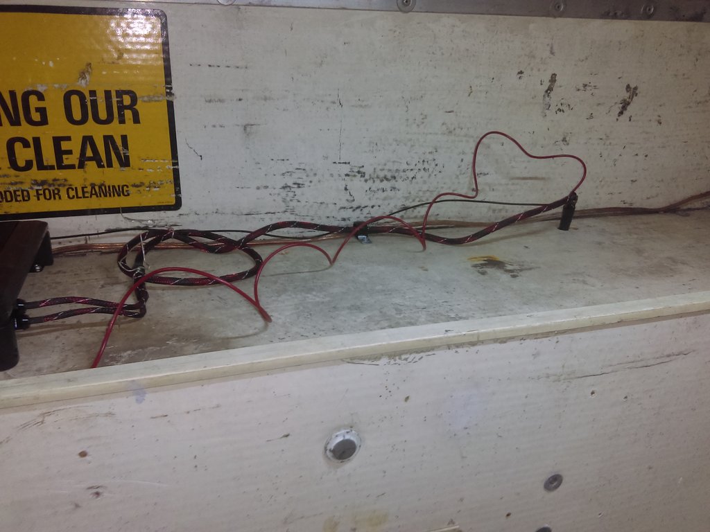

I should have gotten half inch loom. 3/8 just barely covers this RCA line with two extra wires. And holy crap is this a lot of wiring. It's coming out really nice though so that's good and I'm just about done with this portion of it which means I can start hooking up the stereo again and testing.

Okay I cleaned up the wiring for the stereo and put in the Bluetooth mic I forgot. Now it has constant power off the auxiliary battery in the back and switch power from the ignition so even if I turn my cut off switch it still saves the presets even though technically the radio could cause a draw off the back battery, but that's fairly unlikely. And even if it does it only sucks down the deep cycle in the back not the starting battery.

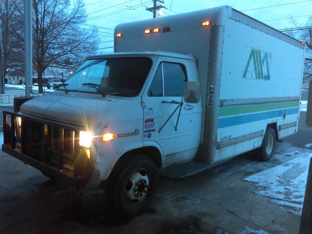

So I've noticed a new vibration noise at 65. However it seemed to have occurred at the same time I finished the bumper. I'm guessing there's some resonance from it that I'm hearing. I had Luis remove my driveline on Friday and we checked all the u-joints and the center support bearing and they're all fine so barring wheel bearings or something which it's not that kind of a noise I'm pretty sure it's just going to be the bumper. I suppose that makes sense it's a lot bigger thing off the frame horns and it could be that it's setting up like a tuning fork with the spacing of the slats. I'm thinking about welding some angle iron onto the front of the slats to give it a little better wind profile. other than that I can't find anything wrong with it so I'm going to keep driving and see what happens.
