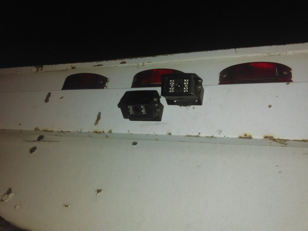

I ended up getting the backup camera installed a couple of weekends ago. However the ball view for the trailer wasn't conducive to seeing if there were people behind me or if the car was about ready to fall off the trailer so I figured I'd wire in a second camera as the system was designed for it. the display is clear when the engine's off but there's quite a bit of interference while running (lines one the screen) not that I'm surprised for an 87 g van. Still it's perfectly clear enough to see what's going on behind me.
Rue was being a helper dog. ;) I also did a whole bunch of stuff and wired a 12 volt spot light and I thought it would be good enough but it's not. Still too dark so I searched on Amazon and found a four LED 12 volt light set and got a couple of those and it should be lit up like a Christmas tree and not use very much energy anyway. I also figured out why the dome light in the box section doesn't work it's because it goes to a little sub harness behind the seat and apparently they must have sold you a little something to connect to the positive and ground in the dash that then went back to the female and male spade connectors on that harness because it's not wired to anywhere else it just terminates behind the driver's seat. I assume it was a safety feature of not leaving the light on in the cargo area and having the battery run down. As it is I'm going to wire in that light to the vehicle power and it's just a little 1156. For the 12 volt LED lights I'm going to run those to a connecting harness for the deep cycle battery so I can run the lights in the back without having to worry about the main starting battery.
