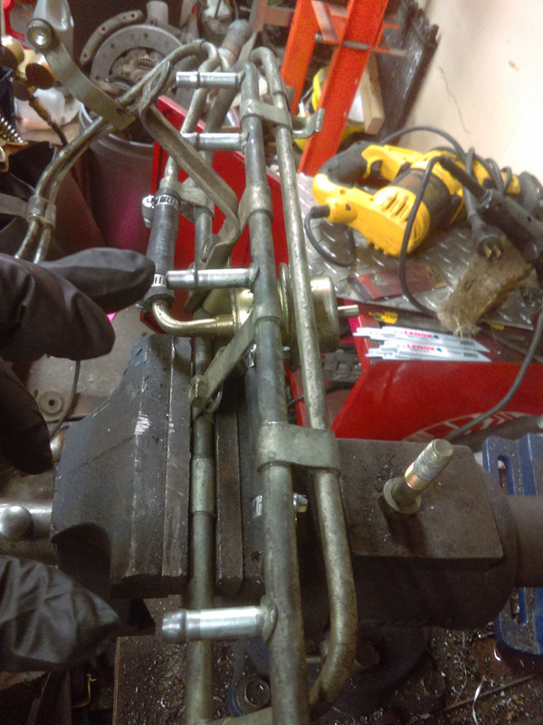

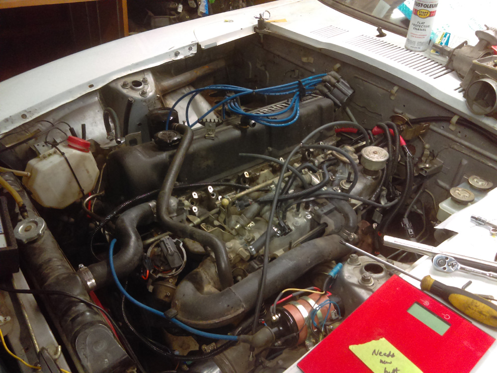

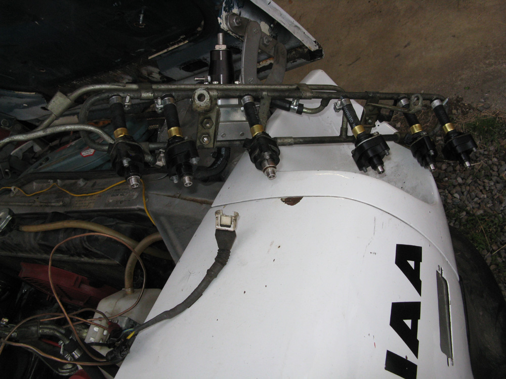

So I got quite a bit accomplished on Betty White yesterday. Got the new injectors installed. Ended up fucking off the fuel rail when I removed the injectors. I didn't realize they were so close to the nipples in the injectors. Should have cut the hose with a razor knife, instead used snips. Yep, squashed the end of one shut, mildy squashed two others. Ended up putting it in the vise and cutting off the squished end then stuck a centering punch in and tapped it back to mostly round. Below the bell, so no issues with sealing, thankfully.

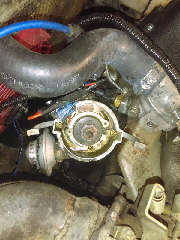

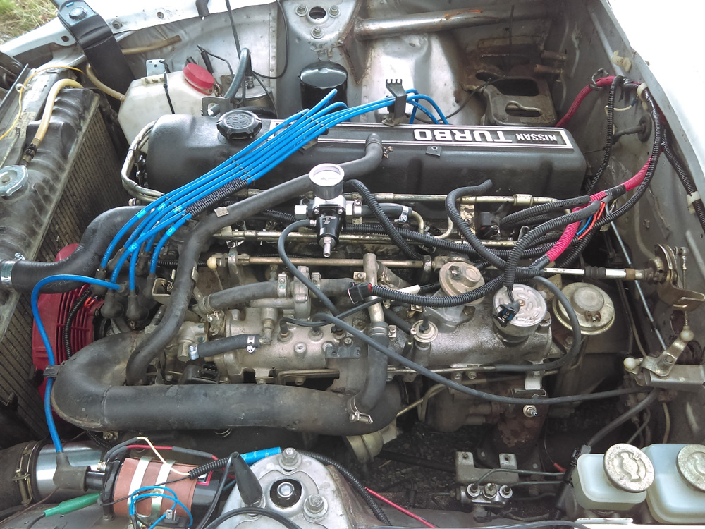

Changed out the bad vacuum advance on the distributor. Removed the little water pipe that goes to all the air bleed stuff on the manifold, ended up putting a bolt in the small section up from the water neck. Not ideal, but better than yanking off and welding up that outlet or using an early one without the outlet. Also put the old (new) fuel pressure regulator from Ugly Betty on the car as well. A nice Aeromotive unit. Unfortunately I think the gauge is going to hit the hood, so I may need to hole saw the hood ( I've already fucked it up and cut shit) or make a little elbow piece to relocate the gauge. We'll see. And apparently I didn't take a picture of it all back together so I'll have to do that today. Still runs rather crappy, haven't figured out the workings of the Motec completely. Got it better, but not happy yet.

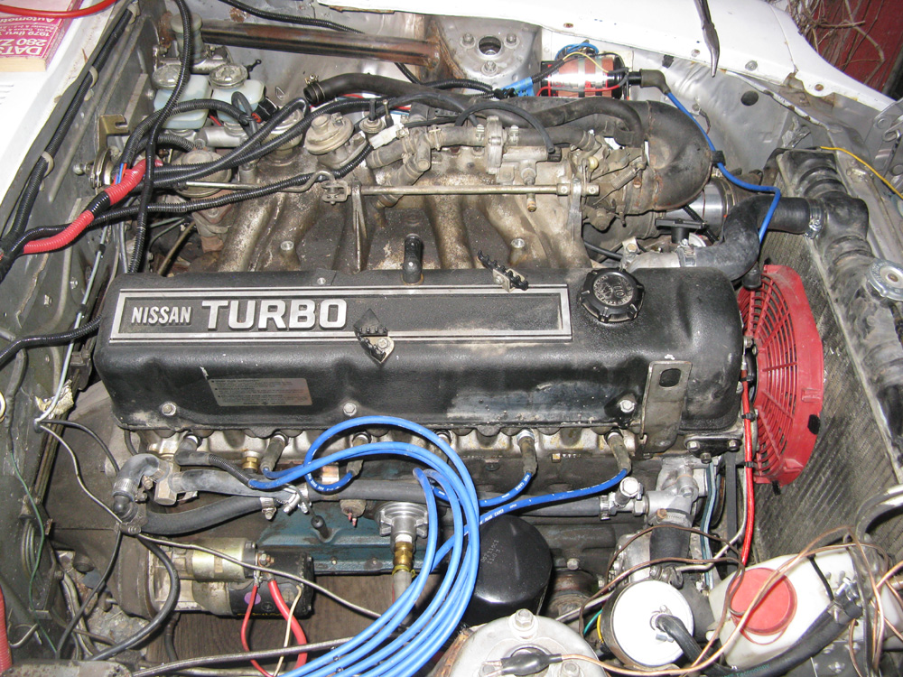

Ah hah, here is the finished picture! Decided against fiddling with it today, going to wait until this Friday when it's supposed to be 53 high, that'll be a lot nicer with the door open.

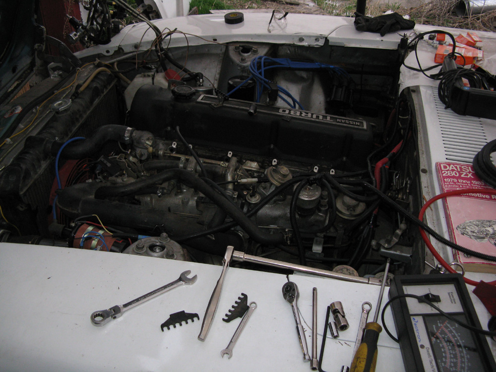

Well today was a lot of work to be annoyed. So after screwing around with suspension this morning and finding I couldn't do what I needed to do with the parts I had, I pulled the car out with the truck. The goal was get it running awesome! I kept trying to tune the car, and it just wasn't happening. And it seemed to be missing. Didn't seem to be a spark issue, but lopey idle except no cam. Not to mention it's still too rich or too lean. After a bunch of fiddling, I finally called the Datsun guru to get some clarity.
He suggested pulling the injector feeds while running, and/or checking for spark leaks, etc. So even though I just replaced all 6 injectors, I thought, good point, go back to basics. Checked spark, replaced the wires with a spare set I had. No change. Next, started taking off injector plugs. Wouldn't you know it, #2 and #4 had no change when disconnected!! I got annoyed and figured I'd gotten two bad injectors. Swapped connectors, no difference. Batch fire, so they all do the same thing. But after taking a break, I decided to test the injectors. They both clicked when voltage was applied, and I could watch the fuel pressure gauge drop. So I started it back up after confirming spark and listened with a stethoscope. All were clicking accordingly.
Unfortunately it was still missing, I figured I'd better check the compression to confirm no mechanical issue. Compression was 170,166,162,165,166,170, so no issues there. When the plugs were pulled however, #2 looked brand new with no carbon whatsoever, so clearly not firing. Or no fuel at all. #4 was super black, indicating too much fuel.
After many thoughts, the only thing left is an injector pattern test. I have an extra fuel pump, think I'm going to make a little test bench so I can yank the rail off and have it far away from the car then open them full and see what they're spraying like. Either I got two brand new injectors that are crap, or there's a blockage in the fuel rail, though I would be surprised. Something has to be causing an issue though.
Anyway, it's been a maddening day. The only good thing is I have a reason for why I can't tune the car, so I'm not just crappy at it. I may fiddle with it tomorrow or Sunday. I'll let you guys know what I find.

Well, I COULD, but remember this is the annoying injector rail and injectors that come with little sections of rubber tubes. They're not particularly fun to deal with. But yes, once I get the whole thing off, I can swap injectors. I'd just rather not do that and reassemble only to find issues. What I'd really like to do, oooo, actually, I just thought of something. If I get a big clear rubbermade plastic container, I bet I can stick the entire rail in there and fire up the car for testing without worrying about catching things on fire! I'll still have to move it off to the side a bit. Wondering if I'll be able to see it well enough in a plastic container. I'd like to just spray it using the existing fuel pump in the car.

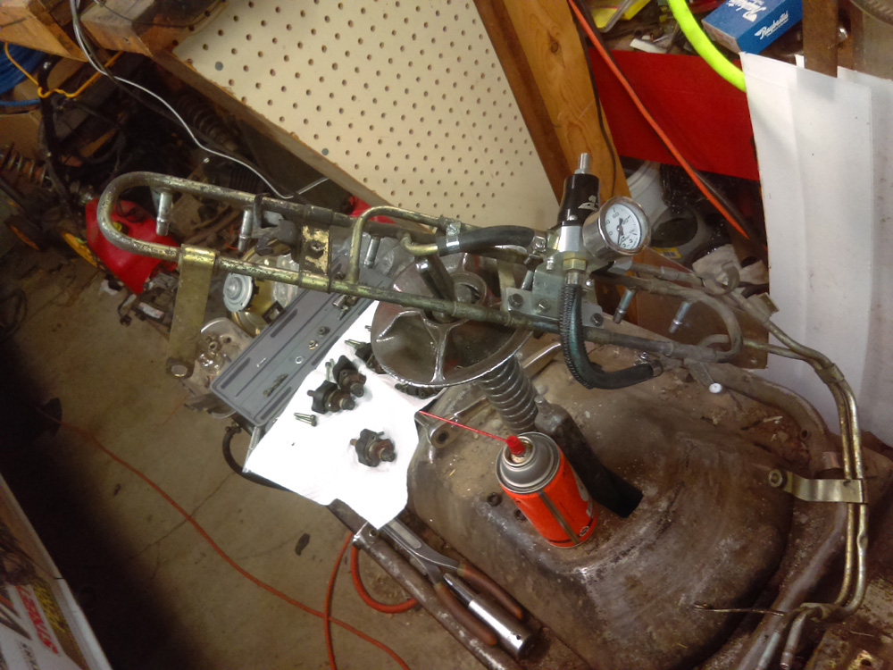

Lol, yes, yes they are! I figured a way though. I made the fuel rail more easily removable when I did the injectors via a cut in the front hold-down and another section with two nuts that bridges it. So now, all I have to do is undo one nut and a bolt on the other side, and the whole injector rail can swing up from the intake and be moved. I figure I'll get some 5/16 hard line and just run an extension to the rail so I can have it 6 feet or whatever away and then just tap it into the existing system. Then I can actuate the fuel pump and manually operate the injectors for spray pattern.

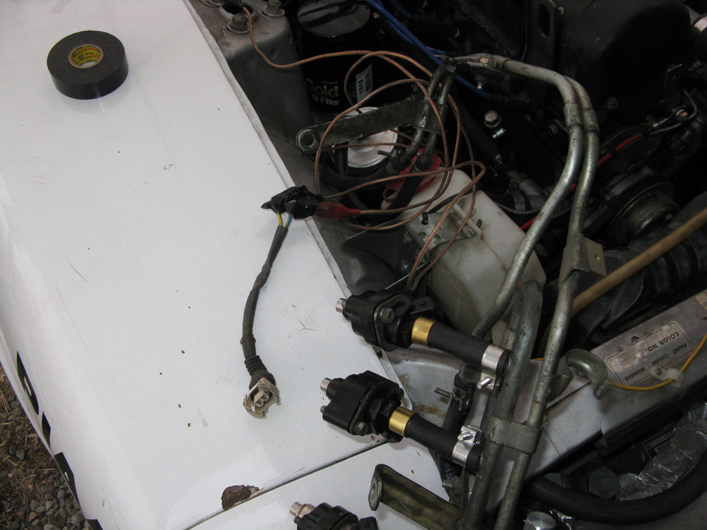

Got the rail off today, had a pigtail I made earlier with the top chopped off so it fits any square bosch injector plug. Ran that to alligator clips so I could open the injector fully. Swiveled the rail over and cut the top of a washer fluid bottle and fired up the fuel pump so the rail was pressurized, then connected the jumper and bingo, shot fuel into the washer fluid bottle. All injectors had nice healthy streams, and the fuel pressure was still holding at 32 psi from the previous day when I drove it into the garage.
So we have now confirmed:
1. Plugs are good, all firing.
2. Wires are good, same resistance between the old and new set, all working
3. Injectors good, fuel rail not plugged as it was run off the engine.
Now that we've eliminated spark and fuel, there's only one item left. Mechanical air. So even though the compression tested good, my Datsun guru and I suspect a sticking or bad lifter in the exhaust valve, which will richen up the cylinder like crazy because it can't push all the spent fuel out and will still show a good compression reading due to the slow engine turnover. The #2 that looked clean may have just been a bad plug. Either way, the valve cover is coming off. I have had a clacking lifter that pressurizes after warm, but apparently it still isn't operating. Or I have something else wrong in the valve department. Perhaps something is just out of adjustment. And come to think of it, I'm not sure if I have checked the valve clearances since it's been that long. Hell, I don't even know if the cam has a flat spot or something. I took pictures back in '16 but I can't see shit from what I took.
