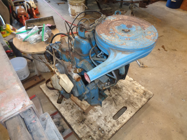

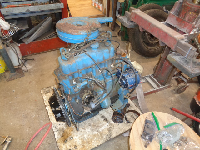

LS swap?
LS I expect means lazy sucker swap as i removed nothing that I didn't have to, I tried taking it out with the transmission connected but there was no way that was going to happen so I had to remove the starter and transmission from the engine, I removed the exhaust connection, the fuel line, the wires including the spark plug wire going to the coil, and the throttle cable, that is it, I didn't even remove the air filter.
It was kinda a bitch to get that transmission off the engine, it didn't want to come loose, I used 2 giant screw drivers and a hammer to get it apart.
Them lift hooks are not the greatest, I thought they were long bolts going into the head but they sort of bent the valve cover a little, if I want to used them again I will need to make something that pulls straight up from the lift hooks, I can likely make something, this is the first E block I have ever pulled in my life.
Believe it or not I actually have a J15 engine/4spd(floor shift) that will fit right in this truck and I have the tunnel cover for the floor shift, but this engine matches the VIN tag number, so I will just fix the front and rear seals, I will likely convert the front seal to a real seal instead of putting a new rope ring or whatever you call that front seal in the front cover, I will need to put another rope seal in the rear which will require removing that rear crank main cap, not looking forward to that.

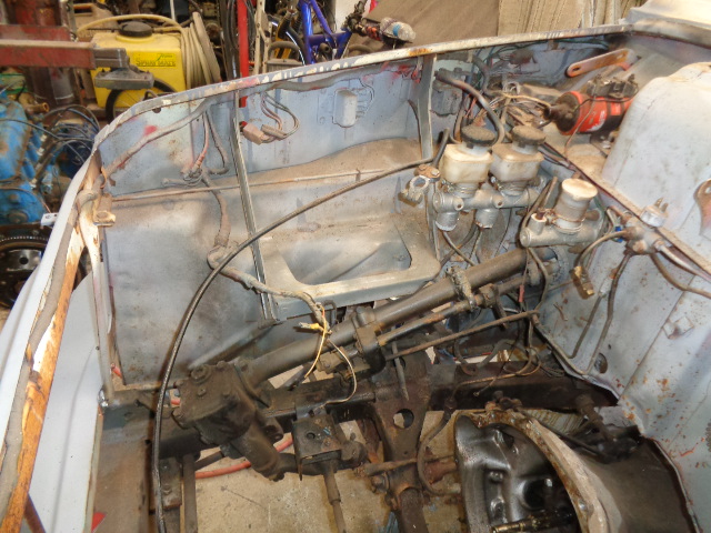

this is what I did today after working a half day, I took photos of the wiring and then I almost removed it, I need to either mark the ignition switch wires or just work around it in the engine compartment.
You can see I saved the little inner fender mud flap tangs sticking out of the inner fender, I saved all the original washers also.
I will need to remove the steering column and shift lever assembly so I can paint it and install the firewall grommet when I put it back in, but I am going to remove it mostly so I can clean, prime, and paint the engine compartment, I also removed all the brake lines and masters.
I cleaned this also.
I removed the steering column this evening, sometimes I think they could have done/designed a lot of stuff better, but this was when they were just starting to import Datsuns to the USA.

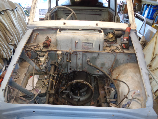

Well I didn't say anything because I was not sure, but I separated the cab and the chassis today after priming the engine compartment, I was unhappy with chassis stuff in the way while priming, I also noticed the cab was on the chassis crooked, like the wreck it had been in in the past had pushed it over an inch as the shock upper studs were not even side to side, you can see that in this first photo.
I primed the engine compartment, it needs more sanding.
Then I separated the cab and chassis, I believe I can almost roll the chassis out from under the cab now.
I had to cut one body mount bolt to get the cab off the chassis.
Everything is going to be much easier to get to with the cab off the chassis in the engine compartment.

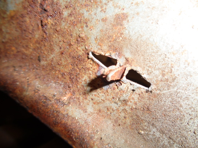

I rolled the frame/chassis out of the garage today and pressure washed it, a lot of Australia came out of it.
I then got under the truck and looked around, I found something I did not like, I consider this a design flaw.
So I got out a paint scraper and my air gun and proceeded in removing likely 10 to 20 pounds of Australia from the truck saddle bags under the truck, this is what it is supposed to look like.
Here some of it is in a bucket.
I was thinking about covering the holes but it will not be so easy on the gas tank side as the fill tube is in the way.
That is where I am at now, I was going to scrape all the crap off the bottom of the truck but after getting under it I am not so sure that is a good idea and it will likely take over a week to do, it is covered with shit that likely will not let much water get thru but it likely will hold water also, not sure what to do right now.
