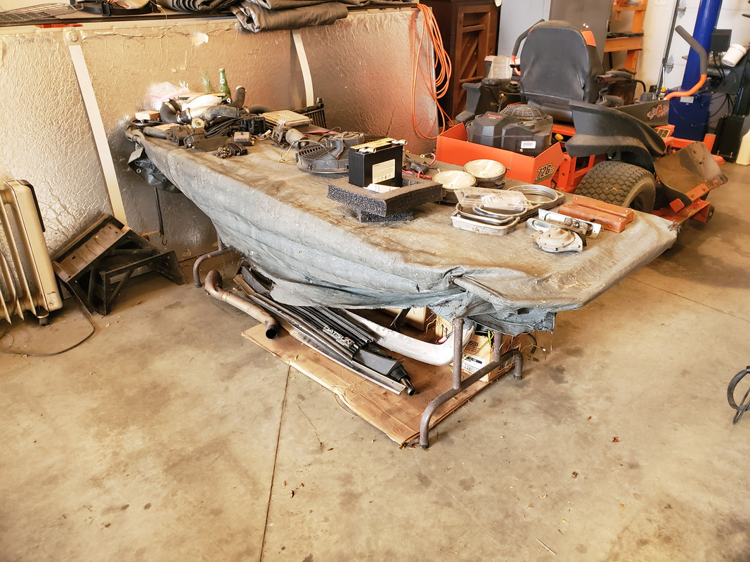

...and here we are 6 months later. I had shoved this in the back corner of my dad's shop and done my very best to forget about it.
Went over this afternoon and shuffled things around, swept the floor, set up a table, and organized things a bit.
I made an addendum to my original list and refocused my plan of attack. Now I guess I'll have to just get after it.

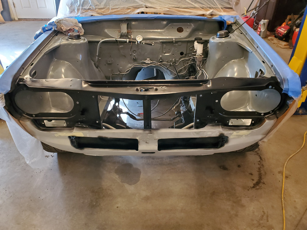

I got distracted this morning by nice weather and didn't make it over there until after noon. My dad had jumped right in and degreased and scrubbed the bottom side of the hood. He also did a little sanding on the inner fenders. No grass grows under that guy's feet. I moved some things around and did some more sanding, then layed a fat coat of primer down. I'll check it again in the morning to see what needs to be touched up.

All that prep work sucks balls, but once you lay down the color, it all seems worthwhile. What type of primer you shooting?
Re: Just another car I'll never finish.
#304
Well, yes and no. I'm not going to the original color. It'll look waaaay better than the gross charcoal spray bomb the previous owner did though. It's just rattle can primer that will have properly applied rattle can paint over it.
If the car was 100% stock (and the rest was a little nicer) I'd definitely be going original paint color. But realistically the next owner probably won't get too hung up on that.

That’s final color right? Looks a lot better than the black.

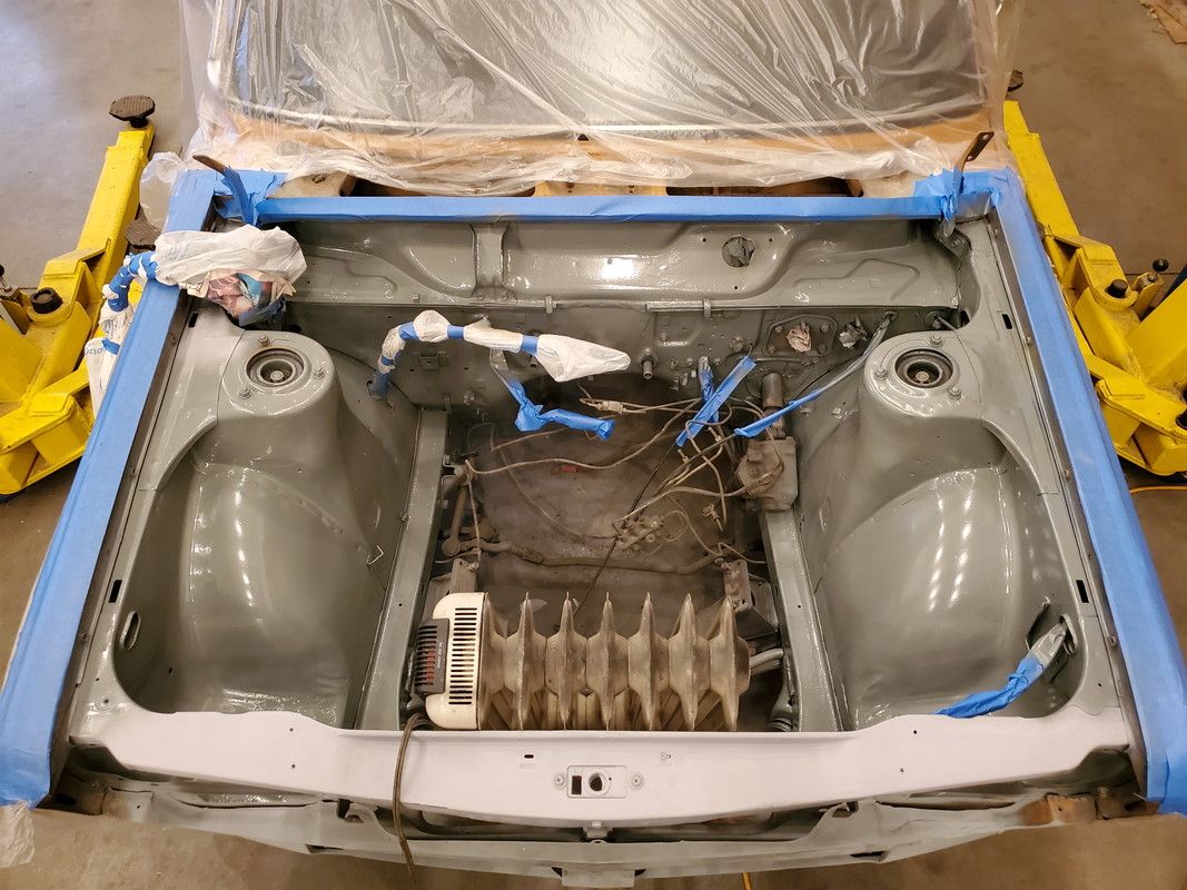

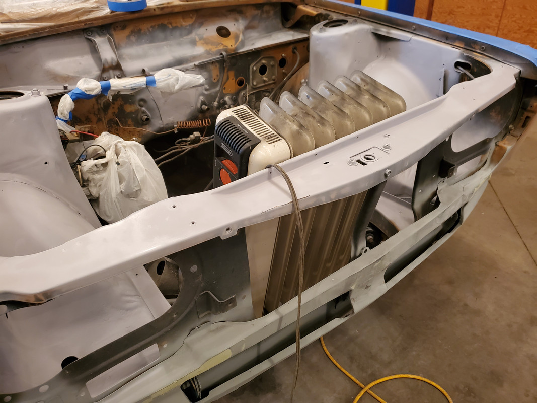

heh, you have a radiator where your radiator goes.
#308
Electric radiator. Tesla speed parts, yo!

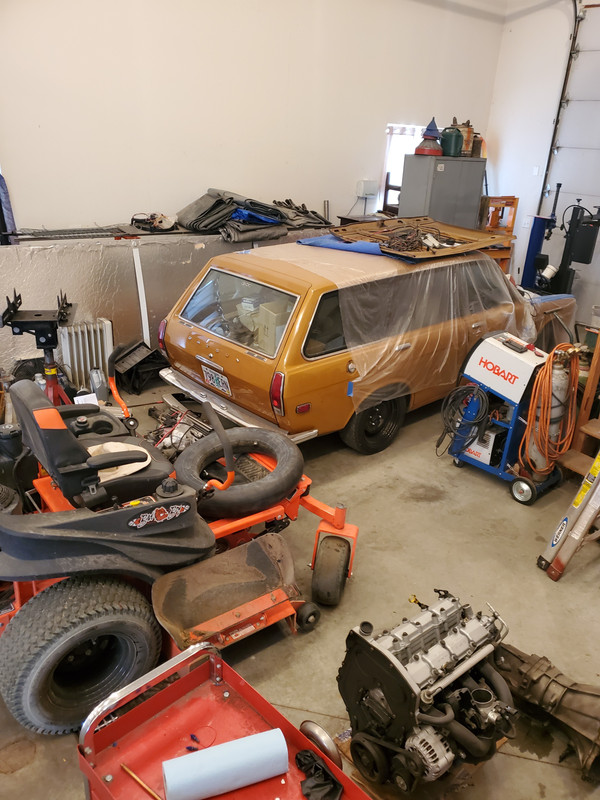

Soooo jelly of your workspace and the nice new paint!! I have very much less space.
#311
It's borrowed space so I can appreciate it like you can. Miss having my shop.

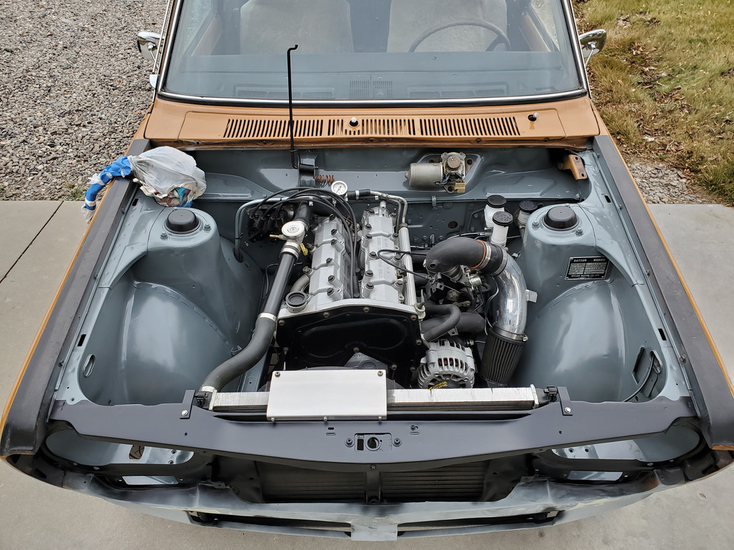

I left off today essentially as you see it above. Engine and radiator in and a lot of stuff hooked up. Next thing I'll do is raise it and install the transmission. I may rework the transmission crossmember. It works fine as-is but if I was building the car today I'd do it differently.
The tedious task on deck is modifying the harness and cleaning up the wiring in general. Again, if I were building the car today, I'd do it differently.
As it lays now...
Red is the bundle that went through the firewall (at purple circle) and tapped into an aux fuse panel as well as things like tach feed.
Orange is the ECM connectors. It was mounted just behind the driver's side headlight.
Green is CTS, knock sensor, and oil pressure switch.
White is all the misc. throttle body sensors.
Blue is injector harness.
Yellow is the coil and ignition module.
The two relays are fan and fuel pump. Note the lone blue wire that feeds the pump.
The way I'm planning to change things is by mounting the ECM below the glove box and running injector harness and throttle body related through a hole above the gas pedal. The coils and CTS bundle will go through a hole on the passenger side way high and close to the fender. Should clean up the underhood area considerably. The rest will live under the dash.
The body harness (lights, horns, wipers) is what's wadded up and stuffed inside the white grocery bags on the passenger fender. That will get rewrapped and routed in the factory location.

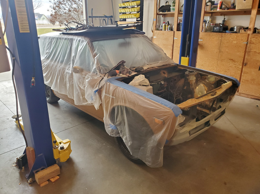

Doesn't look a whole lot different but a lot of little tasks have been handled. Transmission in and driveline hooked up, exhaust connected, all the hoses and fittings checked, plus a few forgettable odds and ends.

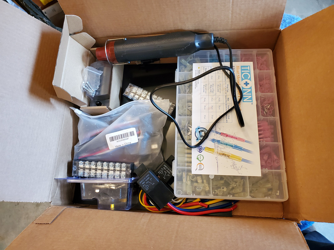

The stuff I had on order finally showed up so I went over and put in a couple hours today.

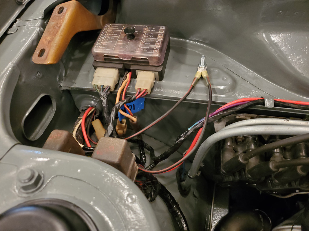

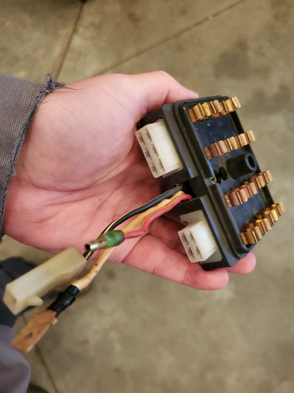

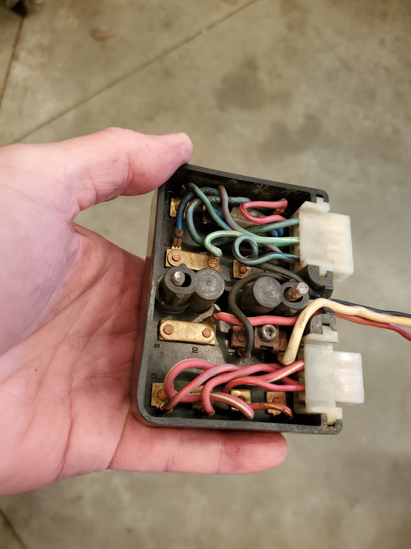

My fuse panel had been soaking in vinegar for a week so I cleaned it off. Came out pretty nice.
I reinstalled and adjusted the underdash clutch and brake pus rods and the shifter. Then I installed the fuse box and removed the old accessory panel and a bunch of add-on wiring. I'm really kind of embarrassed about how I did it 8 years ago.
