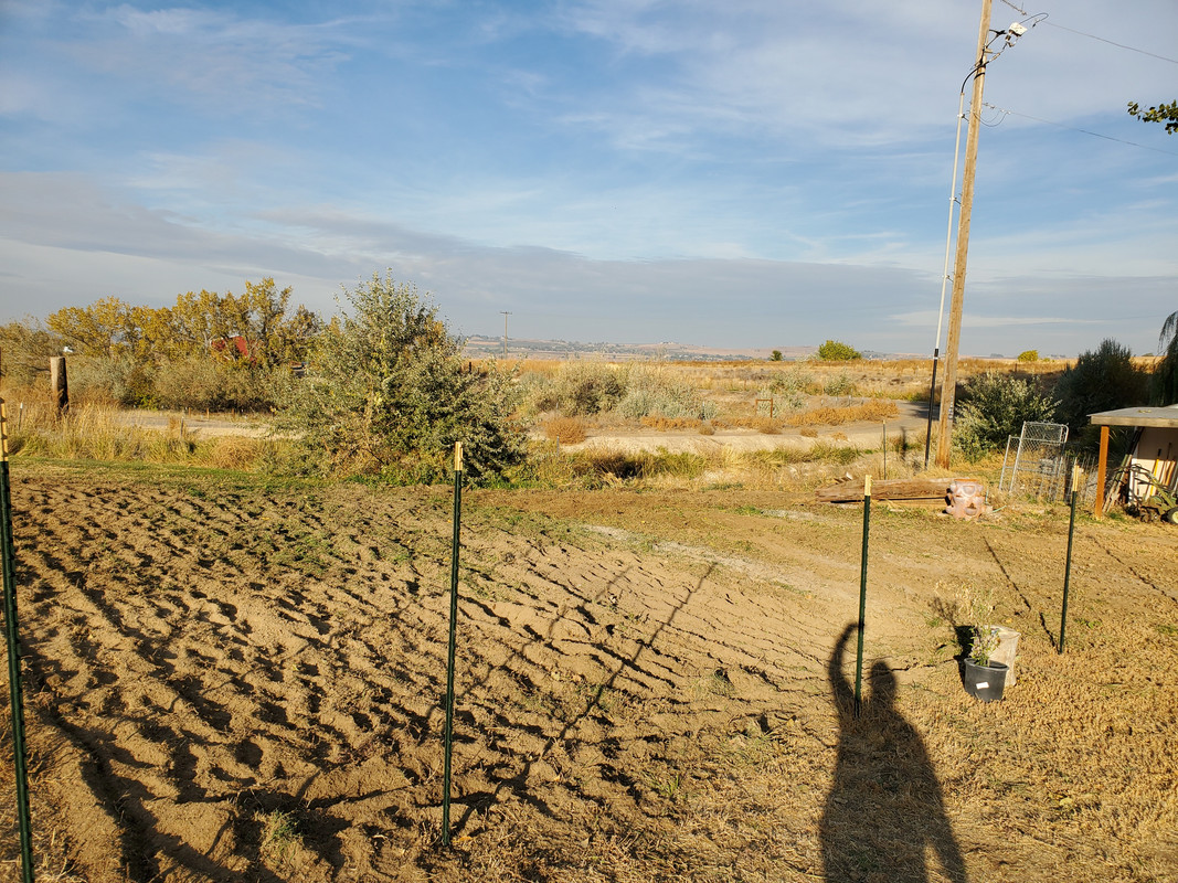

Turned the garden under along with some hard packed virgin soil. Should be able to grow 2000 square feet next year if I use it all.

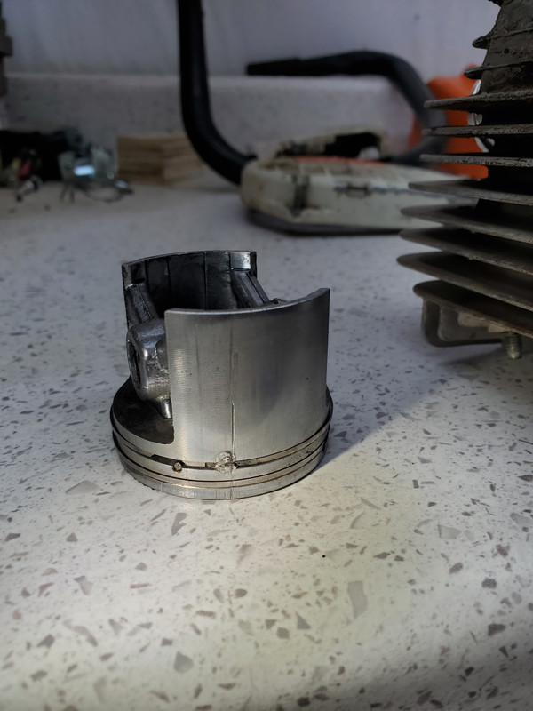

I strapped the new chain on the 036 and got about 1/2 way through the wood I had left when it suffered a pulmonary embolism. Not sure where the clot came from but it embedded in the lower ring and ruined the cylinder. If you can't breathe, you can't run. Parts are on order.

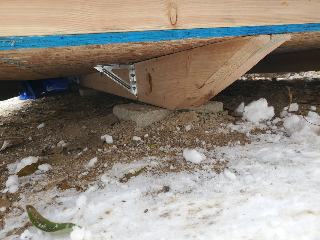

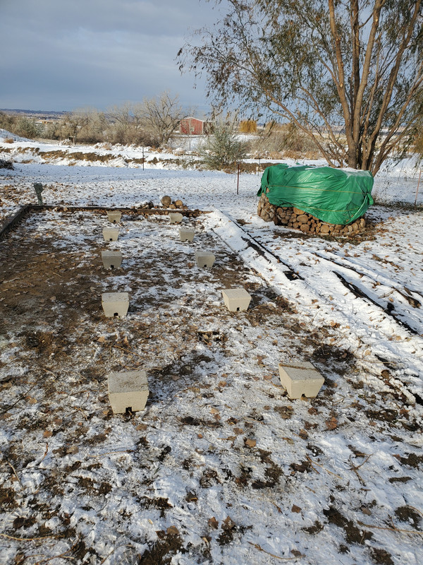

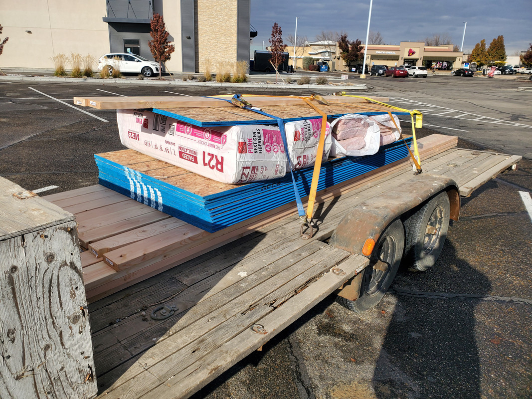

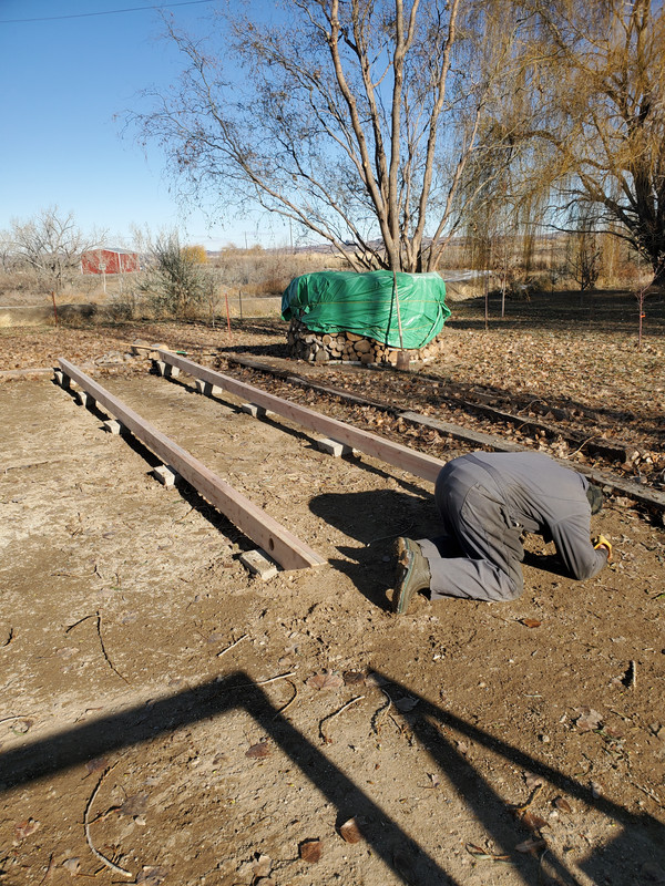

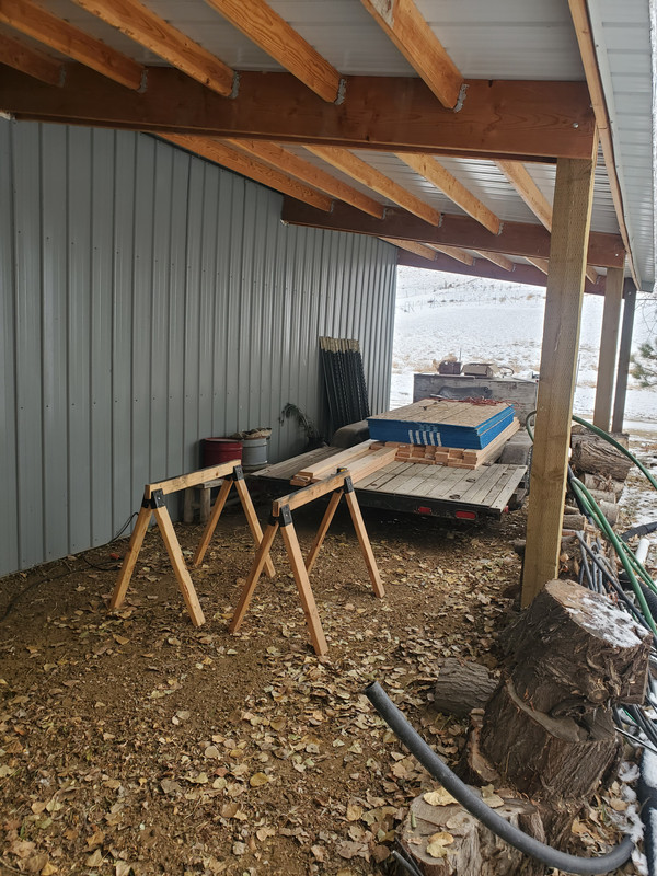

We prepped everything on Wednesday. It was below freezing and really windy so we hid out under the lean-to at the end of the shop. Precut all the joists and sheeting. Then built the 2 skids. I punched 2.5" holes at each end as grapple points if it ever needs to be moved.
This morning we recessed and leveled the blocks. The skids are there temporarily as a level surface.
The platform as you currently see it is upside-down. Brackets are in place to attach the skids before we flip it.
3/4" sheeting goes on top. R21 insulation fills the void.

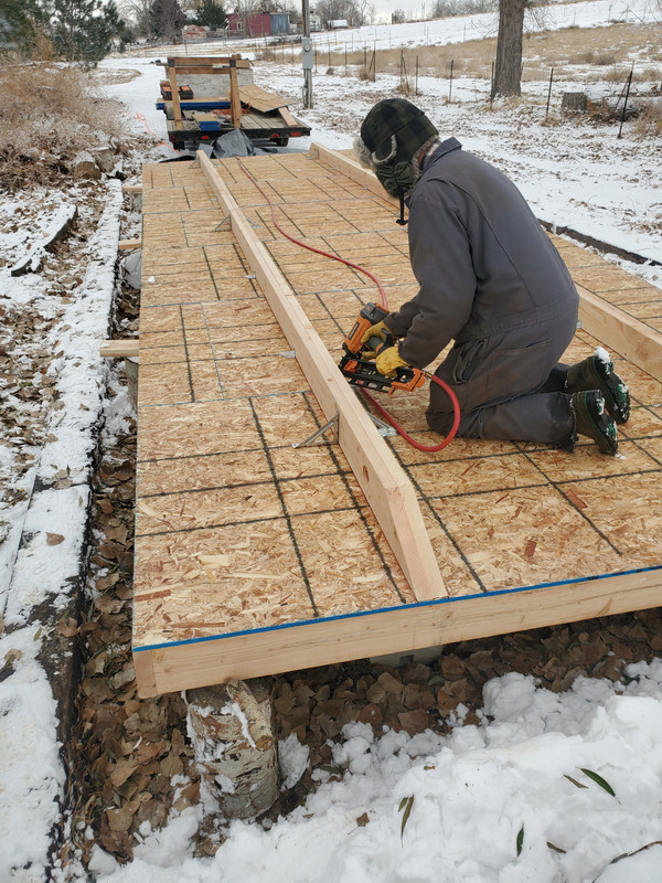

Skids slipped out from underneath and attached. Base flipped over. Insulation and decking on.
Last 2 deck sheets are in place but not nailed until I run the drains. Need to get another load of lumber before we can proceed. All tucked under the tarps until work and weather permits further progress.

Nice. Good idea on the insulation. When I enclosed a back porch at my last house I installed chicken wire on the bottom of the joists and laid the insulation in.
Is that wood treated or is that something you’ll do afterwards? Do y’all have to deal with termites up there?
#255
Not treated, and likely never to be an issue. I worry more about field mice than insects around here. The structure is off the ground so there's no direct contact with soil/moisture.
I honestly hesitated about posting anything about it. I'm not a builder so I'm sure there's plenty to critique. But in reality, it's just going to be a fancy storage shed.
#256
By all means continue posting. I just know that down here termites and powder post beetles can wreak havoc on untreated wood. Your climate is different and I didn’t know if they were really a problem there. And I am nowhere near a builder or contractor, just stuff I’ve picked up along the way. In all reality, if they ever become a concern you can self treat with stuff you can get at a farmers co-op and probably Home Depot or lowes.
Boxing in the insulation the way you did will definitely negate mice making homes in it.

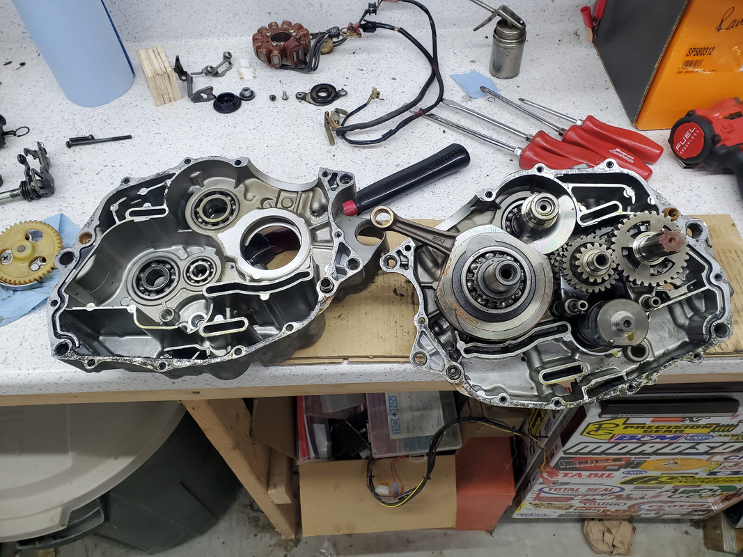

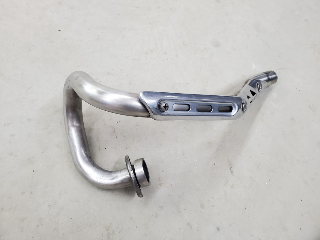

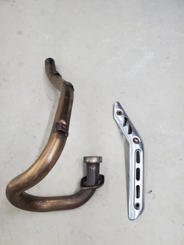

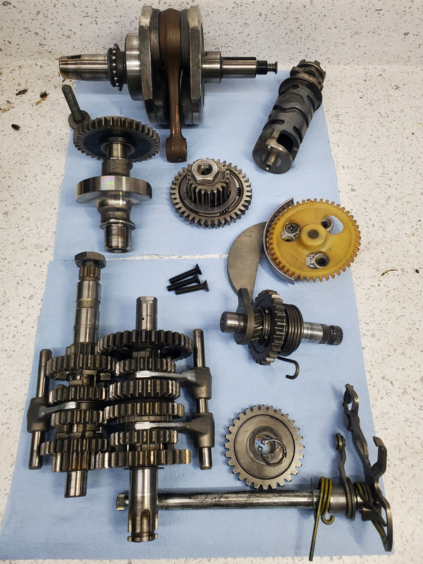

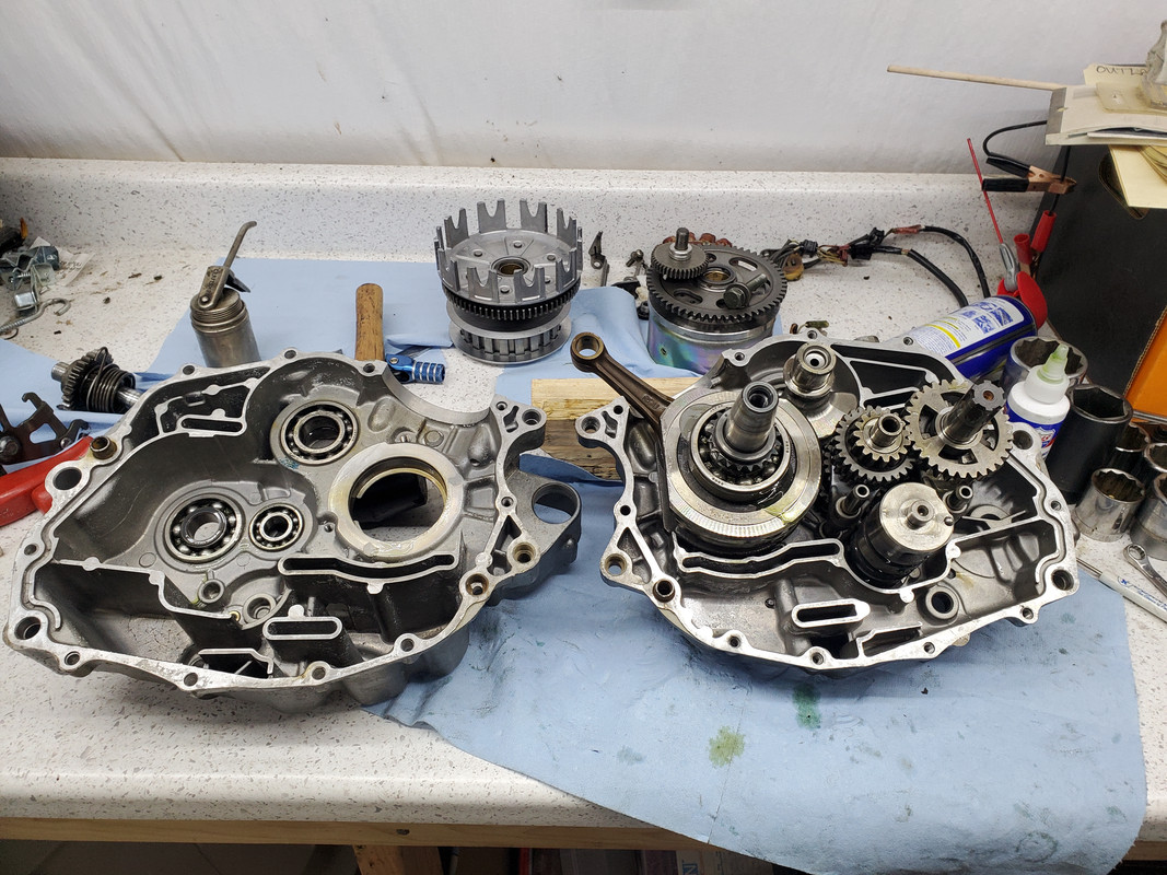

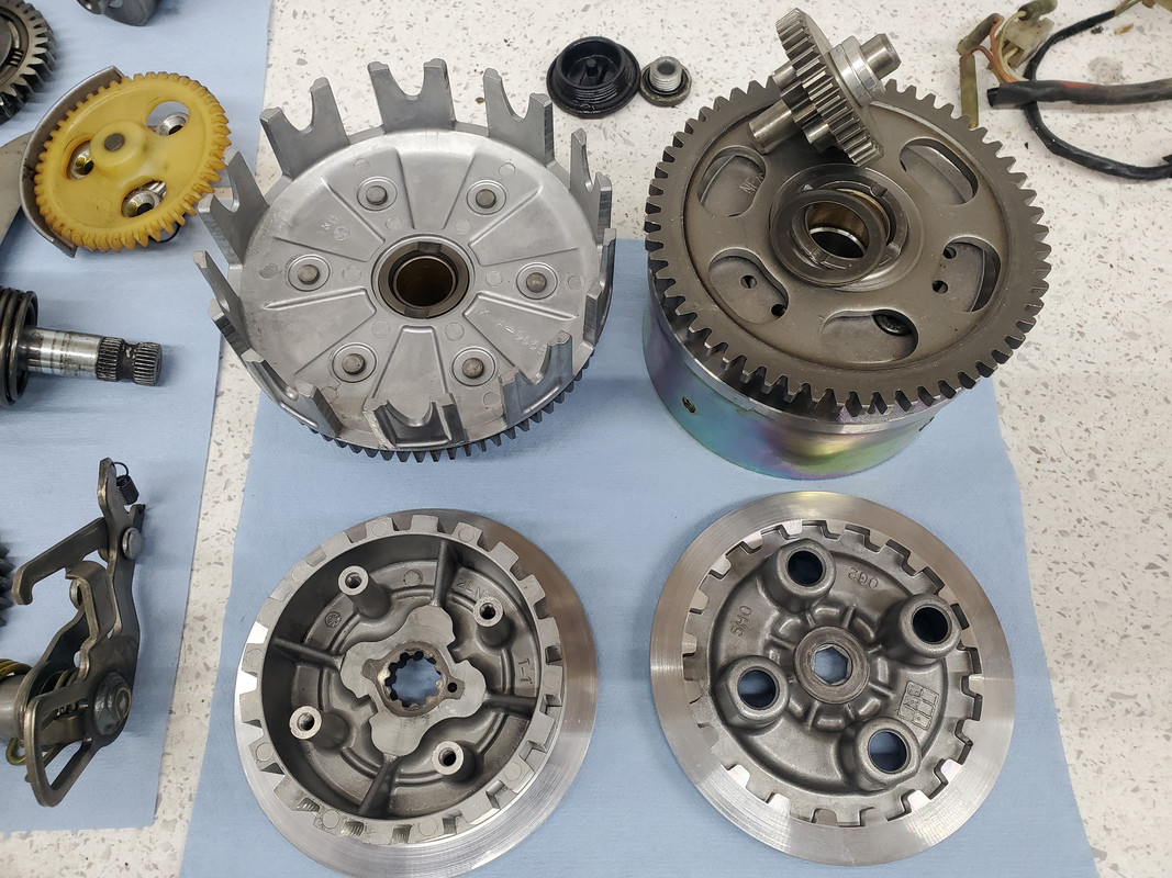

Split my cracked case and cleaned all the innards. Then cleaned up a crusty XT head pipe.
My replacement cases still need some cleaning before I can put it together. I'm going to swap the head on my white bike first before I build this engine for the blue bike.
#260

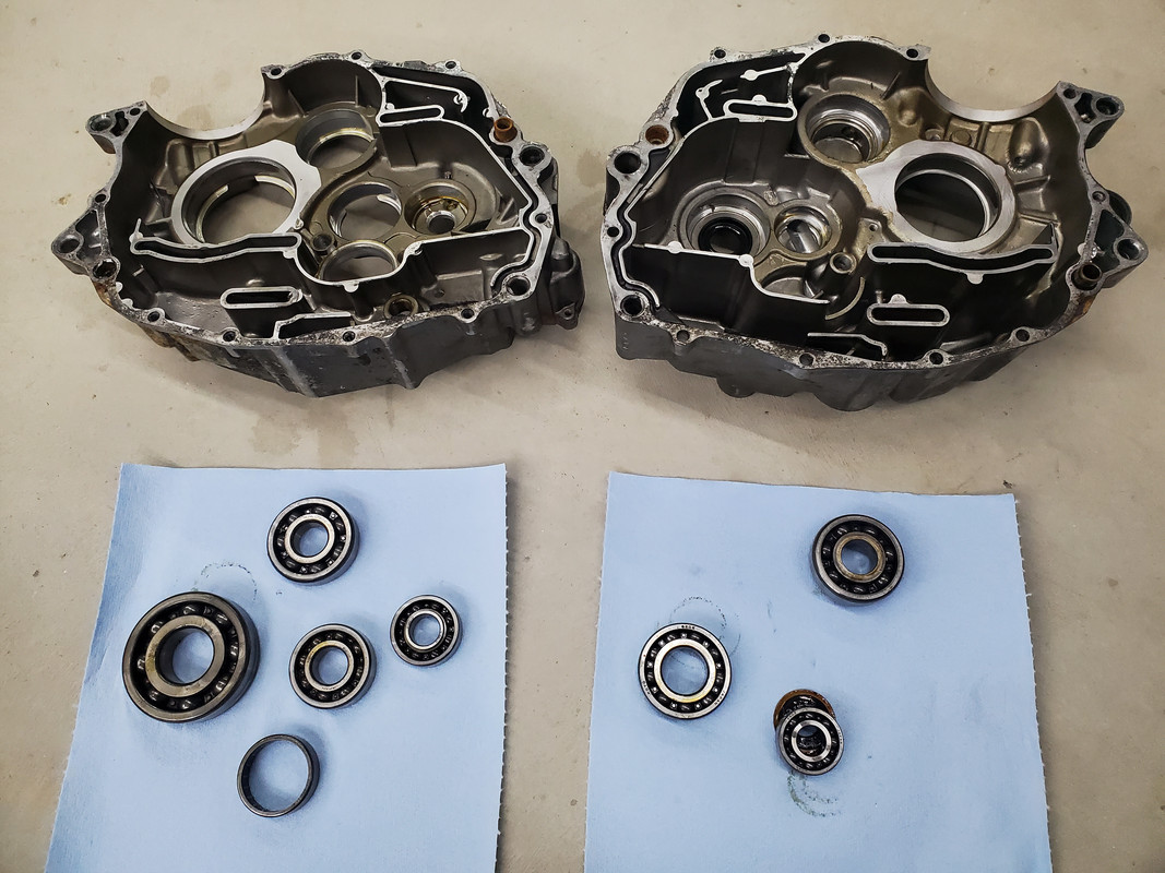

New cases all cleaned up.
Popped the bearings out of the old case halves just to have some spares.
Started putting it back together. Dry fit everything and checked the transmission. 1-6 + N all present and accounted for.
I've got a woodruff key and some lock washers on order so it's set aside for now.
