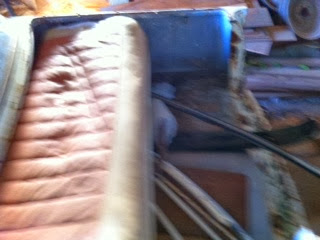

Welcome to NWD Shane, my normal standards are kinda half finished lately, this is one that just happened to work out, it was not a planned purchase till the last 4 months, that is when I totally committed to buying it, I was always interested, but communication was sketchy for a long time, you know, send an email, wait a week, send another email, wait a month, never did get a decent recent photo of it from him, they were all cell phone photos, and it was a sucky cell phone.
Here are a few early photos I was sent, you can not really get details with these kind of photos.

He certainly has a way with photography.... lol
#28
That has to be the weirdest looking Datsun ever, but by that standard makes it that much cooler!
