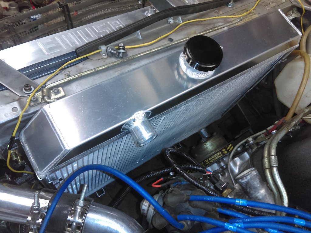

She runs again! Proceeding with radiator install. the only downside is that new aluminum radiator I got is really thick. I apparently ignored that. I'm hoping it's going to fit.

well sweet it's a little bit thicker than the original but it still fits just enough clearance got about a half inch 3/4 inch between the intercooler pipes it even has little hangers so you can actually mount it on the core support without putting the bolts in and it holds which is really nice for a budget radiator 180 bucks this thing is super cheap and looks to be super effective. The mishimoto ones were about 250 or something online this was the budget knockoff. As far as I can tell the construction looks very nice.

found the only issue so far the top nuts have nutserts in them which are super nice the bottom ones are just open so there aren't any threads to put the bolt into. Really that's a pretty minor issue considering you can mount it with the top and then I'll just run a nut on one side and the bottom bolts and it'll be fine.

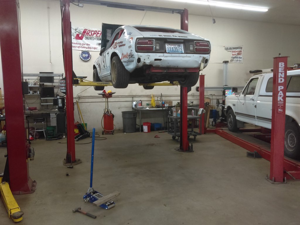

Lift, glorious lift! Had to jack up both front and rear ends to get the damn arms underneath. we'll see if I get to it today but suspension is definitely on my list for raising this thing up. It's already plenty low I think another inch of clearance wouldn't be that much.

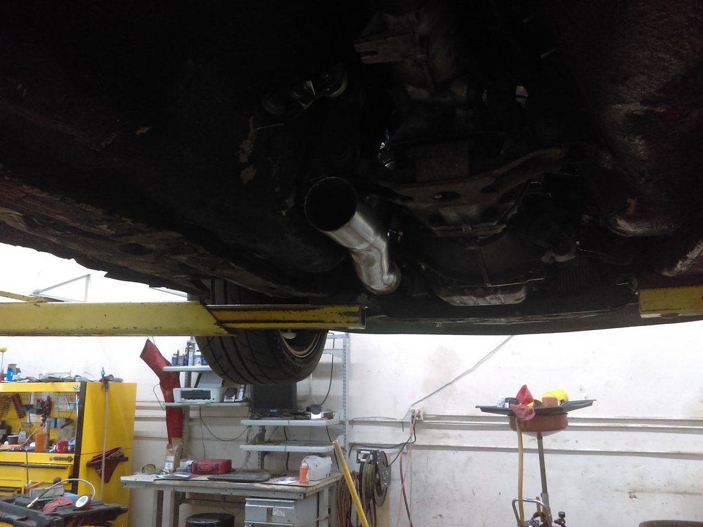

okay we're at a stopping point for tonight didn't get all that much done but at least it's tucked up nicely and damn near even with the floor of the car which means it shouldn't catch anything specially after I raise this thing back up. Didn't get a ton done today but had to go up and get some more exhaust fittings and hangers and such so I feel good about the day. Going to go by the wifey dinner and have some quality time so I can come back early tomorrow morning and play with it some more. ;)

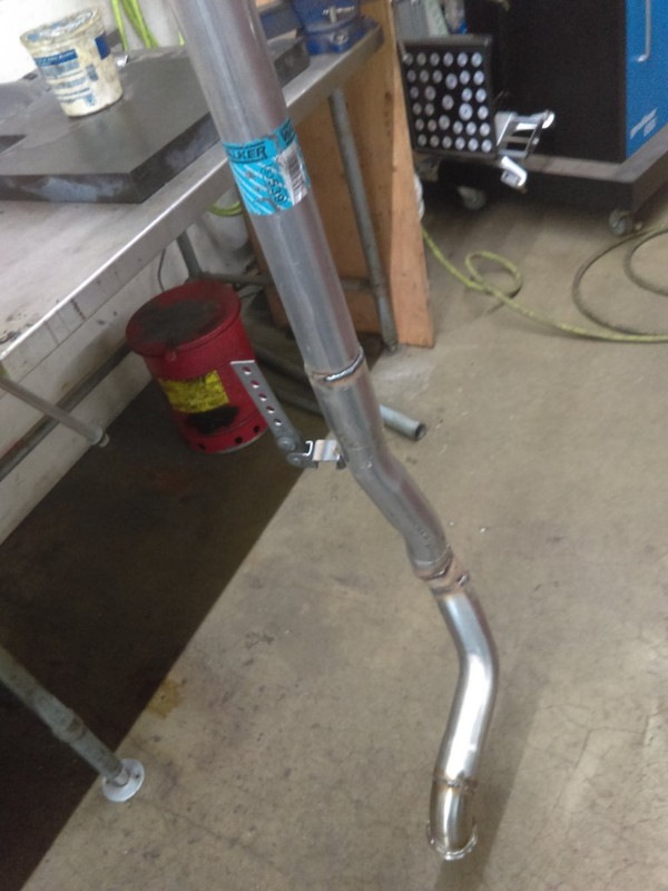

Alright! Now to attach for the last time and weld one hanger in the middle of that rear section to anchor it.

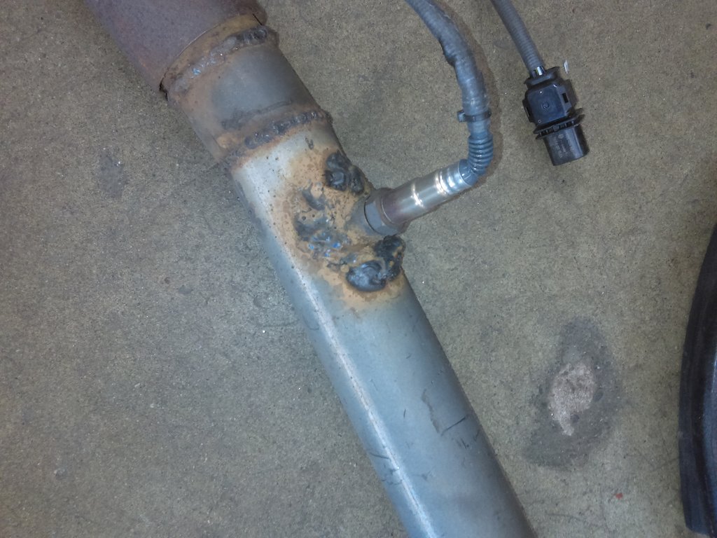

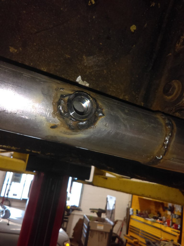

So embarrassing moment this is the difference between welding overhead and welding on the ground with about a foot of clearance, not able to see. Both are air tight, but one is infinitely better. I'll let you guess which one. ;)
Annoyingly I had meant to put that bung in earlier while I had the pipe out on the bench but I forgot about it and then did final assembly where it's back up there and if I wanted to get it back loose again I'd have to cut off and weld the one hanger on the rear. So I said screw it and welded it in the car. Not as nice a weld as my other ones but still reasonable.

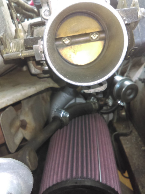

Okay, this weekend was fraught with annoyance but I eventually won. Ended up resetting the throttle plate on the z car. It's actually open a little more than I think it should be but whatever, it's idling.

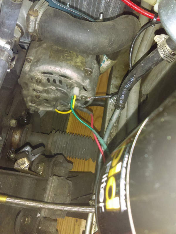

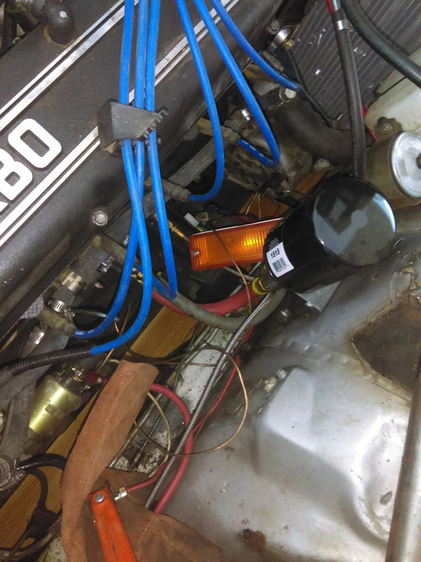

Last but not least I finally spent 6 hours today screwing with the alternator and finally figured out what was going on. For the past 4 years it hasn't worked correctly. If I wired it one way the light for the alternator was on continually it wouldn't go out when the engine was running. If I wired it the other way which was how I had it, the light would remain off all the time and the alternator would full field at 15 and a quarter volts.
Today it finally took a prod from Creepy Cruiser (Todd, 65 Cadillac hearse) who was helping me via text and phone. ended up trying a few things that I didn't think of and found while I had it wired correctly the light still wouldn't go off. So I wired in a hard body parking light that I happened to have around in the engine bay and wouldn't you know it that worked! in the end I couldn't figure out why it wouldn't work the light in the dash so I disconnected it and I zip tied the parking light to the passenger side roll cage. And now the light turns on at kion and when the engine starts it goes away and the alternator actually charges correctly at about 14 and a half. Only took me 4 years and it's ghetto fabulous but I don't care it works.
