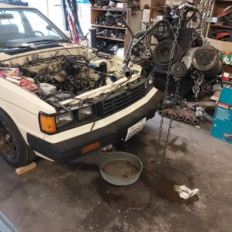

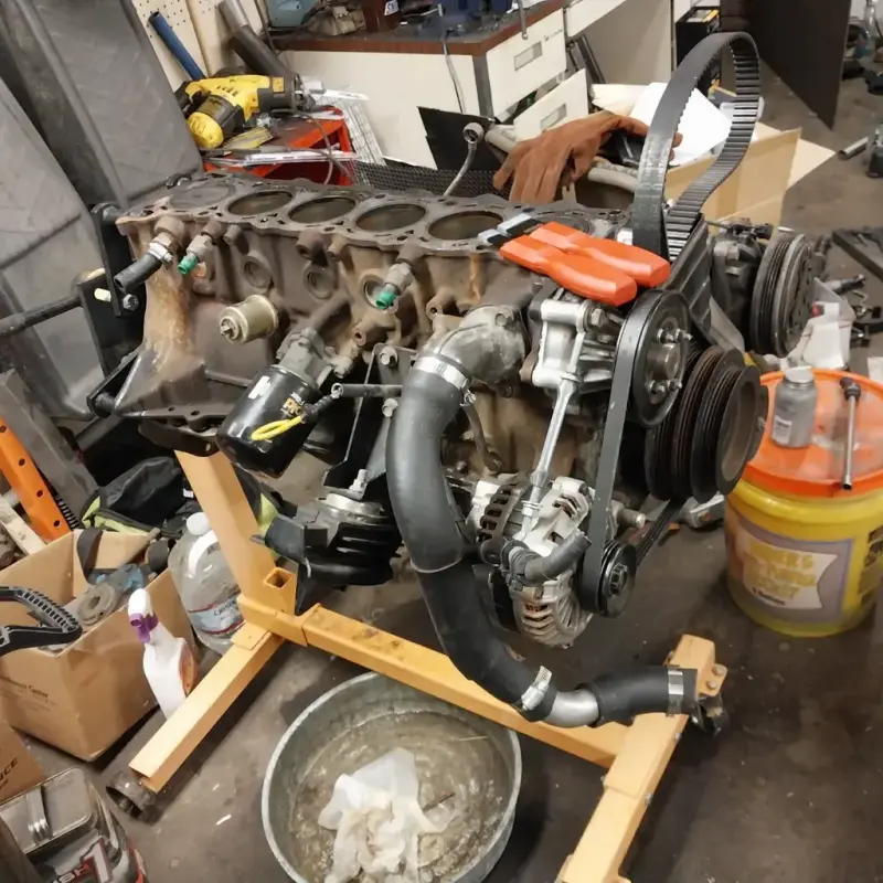

Welcome to the dark side! As mentioned everywhere else, I thought it stupid to ask the smallest motor to make the most hp to move the heaviest Datsun. (Aside from the hardbody) Anyway, this is now going to be a much longer project due to all the plans. I figured two-three years before I have the wagon running again, but maybe I'll suprise myself. However, it's welcome. As much as I love the wagon, this will allow me to focus on the race car and the D21 and then I'll have two reliable Datsuns. One for racing, one for daily driving and off-roading.
What we have here is an LM7 5.3 iron block GM V8. It has only 248,000 miles from an '05 Sierra. Planning for 10:1 forged pistons and some new heads with a nasty cam. Going for 450 engine hp. Basically, I don't want anymore than 400 hp at the wheels since I only put the 8.8 in it. 370-400 whp should make it so I don't kill the nearly bulletproof axle. I will likely put c clip eliminators in it, and also truss the axle.
As far as transmissions, it's either run a 4L60E or a CD009 6 speed. Both are doable behind the LS. I would like the 6 speed, but I'm also tempted to auto it as this is just gonna be a cruiser and maybe an occasional drag race. Definitely a lot of sleeper stoplight burnouts.
I need to see if I can fit a bit wider tire in the back too, otherwise I'm going to go through rubber really quickly, lol.
The other thing is I'll need chassis stiffening to not twist the Maxima into a pretzel with all the torque. It's not weak, but repeated abuse with that amount of torque will screw the chassis. I may farm that out to someone smarter than me who has done a few unibody strengthening jobs. We shall see. This is another reason I say 2-3 years. There are a lot of things I have to change/modify since I'm completely redoing the car.
Oh yeah, did I mention it's only 40 pounds heavier than an RB20DET?
Seriously.
