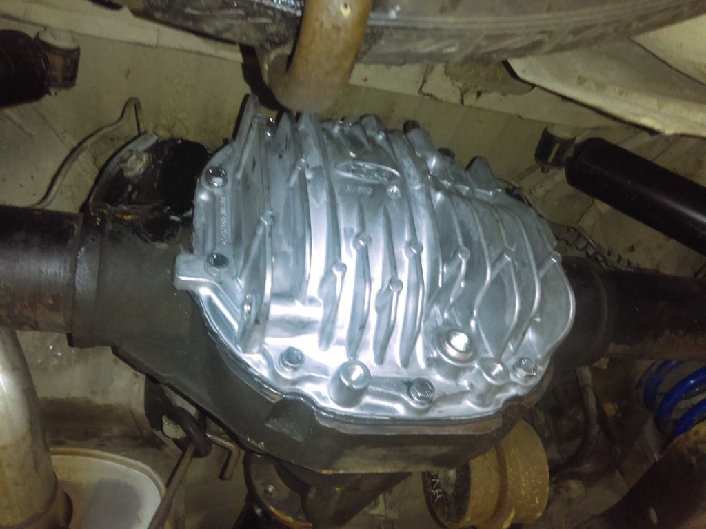

The steeda cover came today. It's a factory Ford diff cover. Even has the Ford emblem and that part number stamped in the side. The difference is this has magnetic drain and fill plugs. The big difference is the baffle plate and the relocated vent so I can run a regular breather style like on the Datsun R differentials that will do the job just great and not spooge fluid everywhere.
They sell this with a note in the description that it comes with a block off plug for that top vent and just use the regular axle vent. That sounds like clown choose to me I don't know why everyone wouldn't just buy the little vent for the top and use the baffle plate as intended. From what I read on the Mustang forums, the regular vent on this Boss cover is good for track days and not venting fluid. if you read up on all the other varieties of axle tube vents there's nothing but Band-Aid fixes and install a catch can kind of crap. Also, this thing weighs 6 pounds! Pretty hefty considering the stamped thin steel cover is like 2 pounds.

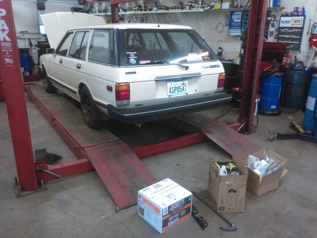

All right, got the wagon started up and rolled down to the shop today to fix my problem of excessive oil out the vent on the cover. If I get excited I'm probably going to fiddle with the upper control arms because I got new heim joints from QA1 from Speedway, or were they from Summit? anyway they're much beefier and more likely to be quiet and noise absorbing than the other ones I have on currently. I was going to bring the center console and do that but I think I'm just going to concentrate on at least getting two things done and not spending the entire day here at the shop.

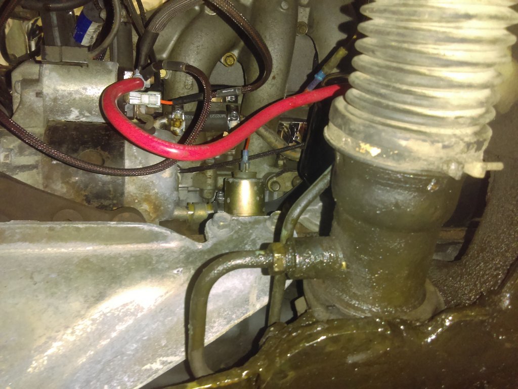

I had one small seepage leak I was curious about and sure enough it's water not oil. if you look at the short section of 5/8 of two hose clamps there's a little bit of leftovers on those so I'm pretty sure they decided to not seal as well during the winter. The radiator isn't down more than a quarter inch so nothing I'm really concerned about but I will try and put a couple more turns on the clamps and just keep an eye on them.

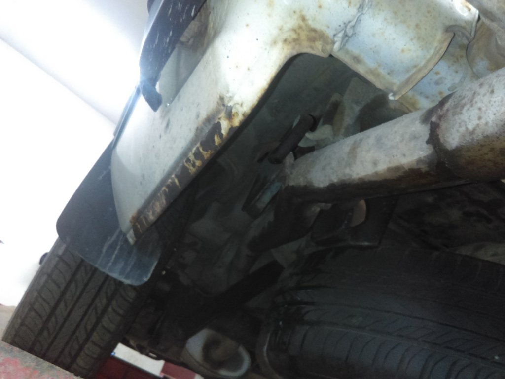

This is the not so shiny part of the car the whole back has surface rust nothing terrible yet but I'm going to need to sandblast it sooner than later I think and get it painted. The rockers are starting to show through at the seams also. not terrible but it's something I should probably put on the list to save up a few thousand and take it to a body shop.

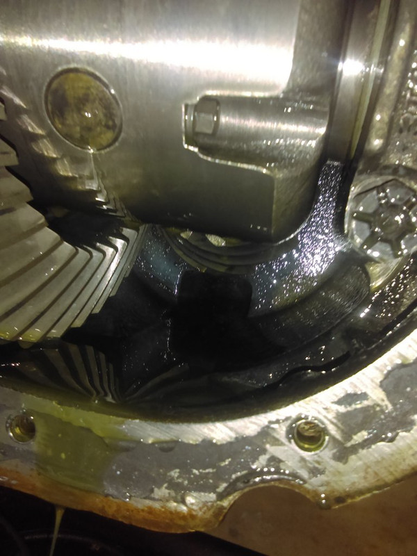

The diff breather barely clears the frame rail but it clears so booyah! It's funny how you think back to what you learned over the years. I had to install the cover twice I was tightening up the bolts and I saw a little glisten on the very bottom middle and sure enough it was gear oil. My old self, my younger self, would have said screw it it'll be fine. While my now older self realizes nope that's going to leak, let's just take it off now while it's still soft. ;)
