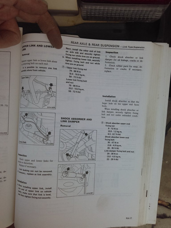

Going to get this drive shaft hoop on next. I'm actually going to check for the torque specs on the control arms. They have lock nuts and I'm almost thinking they probably need to be torqued at rest so basically loosen them all get suspension set then torque them but I'll double check all that after I get the drive shaft hoop done.

#1166
Yep, tighten with wheels on ground. Glad I double checked.
