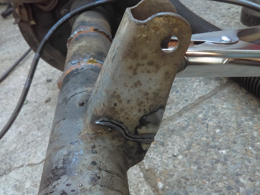

You know I'm actually taking a look at it and I'm pretty sure I can do it in the garage. When I'm going to do is split the top of the mount where it goes to the axle tube and then I'll bend it down two degrees and weld up the slot I cut. It should keep everything in about the same orientation.
Got so used to relying on other people I realized I have the skills to complete the weld and the confidence to do it well! Lemons, meet lemonade!

I started thinking about 20 different ways to do the alteration to the mount today. I've decided I want a plasma cutter. If I scribe an arc around the axle through the plate, I can just offset the mount two degrees, add the difference of cut thickness and Bob's your uncle. I can also do it with the oxy acetylene torch, but we all know how ragged the edges look with that. But I have oxy, don't have a plasma cutter. There's one on Amazon for $200, debating if it's a pile of shit or not. I don't know, keep thinking of different ways to do it, but making an arc so I can just move the bottom piece of the cut bracket in the arc, then fill in the cut seems like the way to go to me. I suppose if I got really excited I could cut the welds and re-position the piece, but it's fairly extensive welding. I'd rather not get too close to the tube. Rather cut it under what's welded. And then I can alway put a plate on the backside (inside) to reinforce the weld around the sides. I'm sure it would be plenty strong. Drill a couple holes and plug weld a few spots.

So the axle is held now by the jack stands all I have to do is carefully tweak it two degrees and weld it back on.
- Posts: 2367
I'm eating lunch now stupid damn bracket I tacked it on and it was too short. So I welded little balls onto it and ground them down to what I thought was correct but it wasn't. Now I have them tacked on and I figure I'll eat lunch before I start throwing things. after lunch I'll cut it back loose again and shorten the distance and retack it and see if I finally have the right dimension.

Yeah, I got it. Haven't final welded yet, just welded the arc on the sides. Got the upper control arms adjusted where the tire to fender clearance was even front to back. I'm happy where the mounts ended up. However.......the left side is in a little over 1/4" more than the right side. Tire is closer to fender edge on right side to clarify. I would prefer it dead nuts, and up to 1/4" of side to side play is acceptable, but this may need to be fixed. Which means redoing the job basically. At least yanking the axle back out. I tightened all the bolts up to get a final idea. It was going to be fine, but I had to adjust the top left control arm back quite a bit more than the right top control arm.
The annoying part about this is I had my Datsun guru did it, and you know when you have your buddy who does things, you don't want to step on those toes since he's done me a lot of quality work and favor over the years? (See "Don't piss off your machinist.") Yeah. So I told him about the 2 degrees off, and he wanted to fix it with a slotted hole, which would have worked, but I didn't want to fix it that way. And now that I'm doing it myself, my options are shut up and do it the way I want it, or take it back to him and say fix it.
Anyway, I'm too tired out to continue. Thankfully in my old age I know when to quit or risk screwing shit up worse. I'll regroup tomorrow after a good nights sleep. Worst case, I have the original axle out. I suppose I can make my own jig and measure things and yank the 8.8 of the car and redo it. But I really don't WANT to do that if I don't have to. We'll see in the morning. At least I got the 2 degrees I wanted and the plasma cutter worked great. If anything, now I have the confidence to build a jig if I do have to redo it.
I need to measure the mounting points on the new axle tomorrow, see if they're centered. Could be other things too, it is from 1984.
