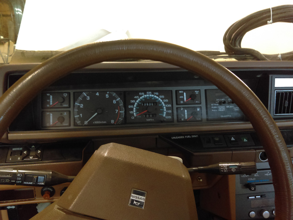

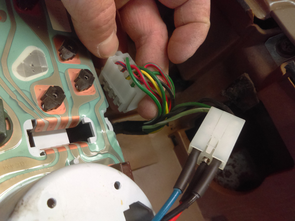

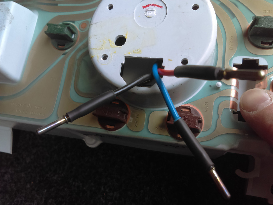

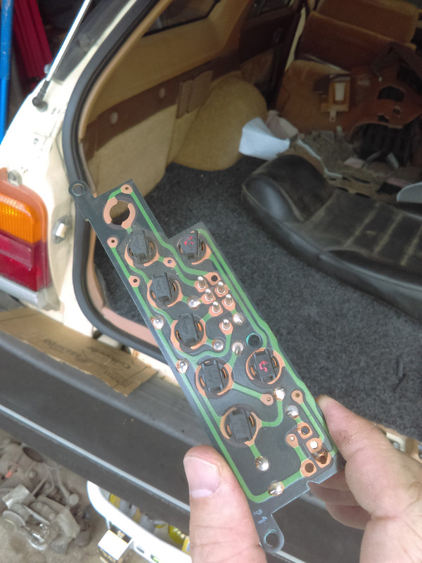

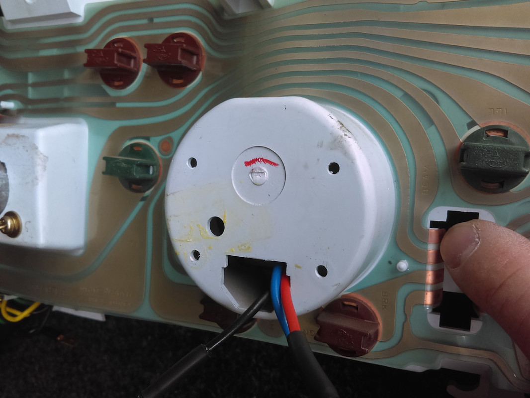

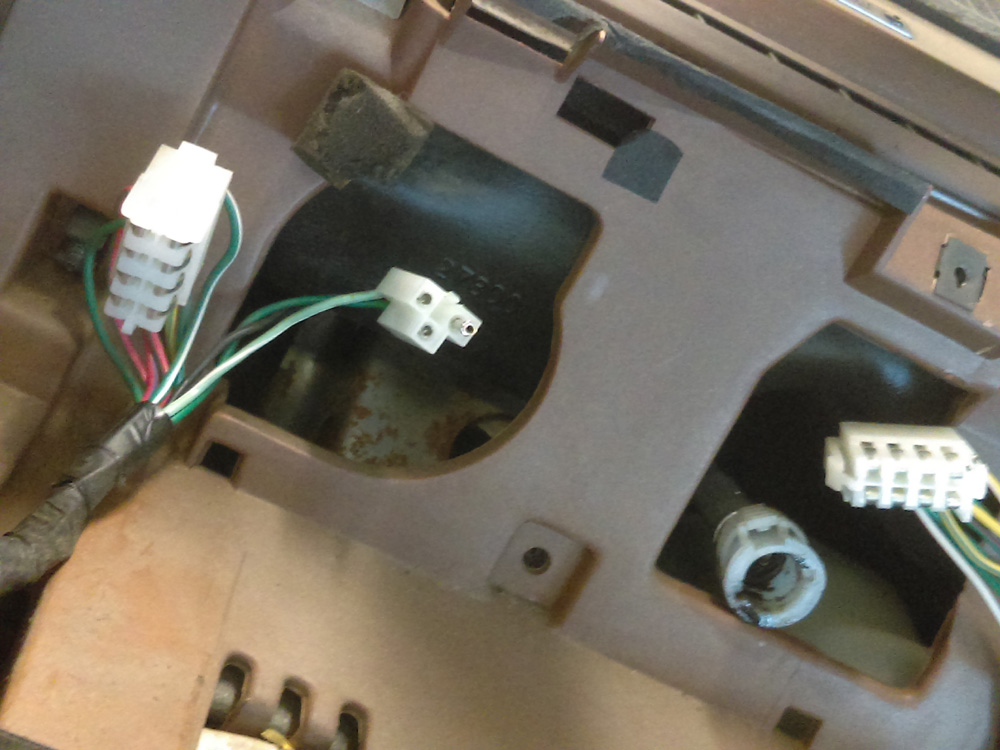

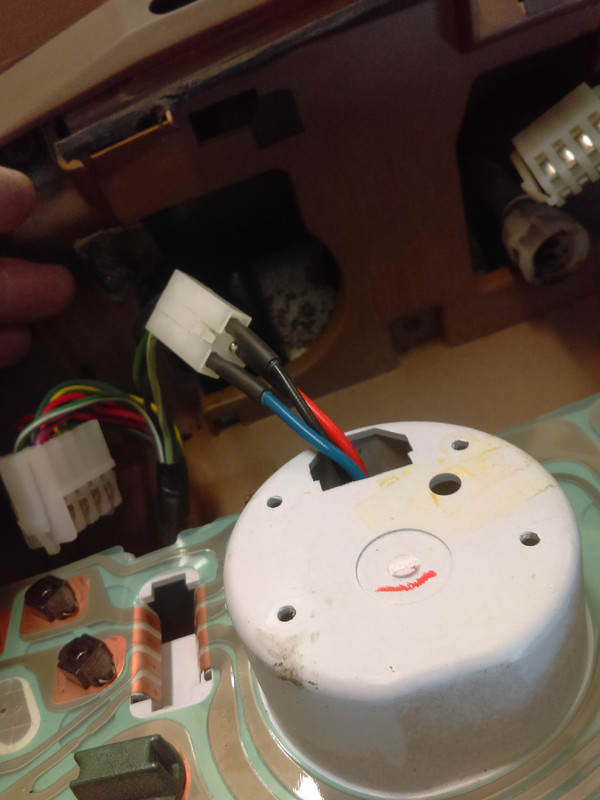

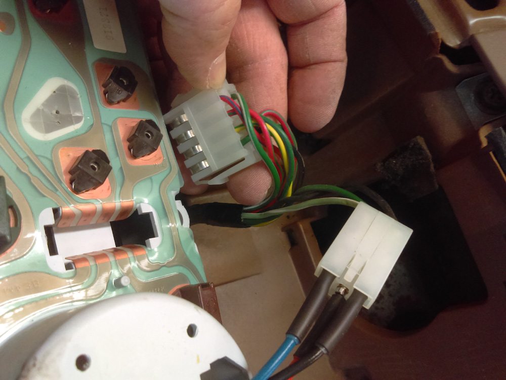

Okay, got the dash back together. Found my reason for the odo not working when I took apart the original instrument cluster. The little shaft broke the plastic tab out of the thing it was holding onto, and spit the gears. I ended up cutting the plate and filling it in with sharpie so you couldn't see it. The trim rings covers the rest of it. Then it's just one screw and you can weasel the odometer out of the speedometer housing without taking apart the gauge.
The only thing I don't have now is the high beam indicator and brake light indicator. Those were rectangles in the middle lower of the original speedometer gauge. Couldn't figure out how to nicely cut them out on the next Maxima backing, so oh well. I was going to wire them into the other warning console, but both the brake and high beam lights are in out contacts, whereas all the warning lights in the upper middle extra panel are common ground with a positive to each one. Short of it was, I'd need to interrupt the circuit board and then jumper it and it was going to be a big pain in the ass. I'm pretty sure I can figure if the brake's on, and high beams I hardly use, much less people will flash you if they're on. Either way, it's back together.
Waiting for the speed sensor to get that wired in. Yanked off the IACV, letting it soak in MMO right now, actuated it, seems to be doing better. Haven't yanked the bimetallic spring air bleed rotary disc, but have a spare I've tested that works well. Theoretically I should be able to fix the idle issue no problem. Unless of course it's a signal problem, and I haven't checked that yet. Figured I needed to clean these it anyway. Enjoy the pics!

Thanks, I'm not 100% happy with it, but it's close enough to work and really, no one except me will probably look at it and know it doesn't fit perfectly.

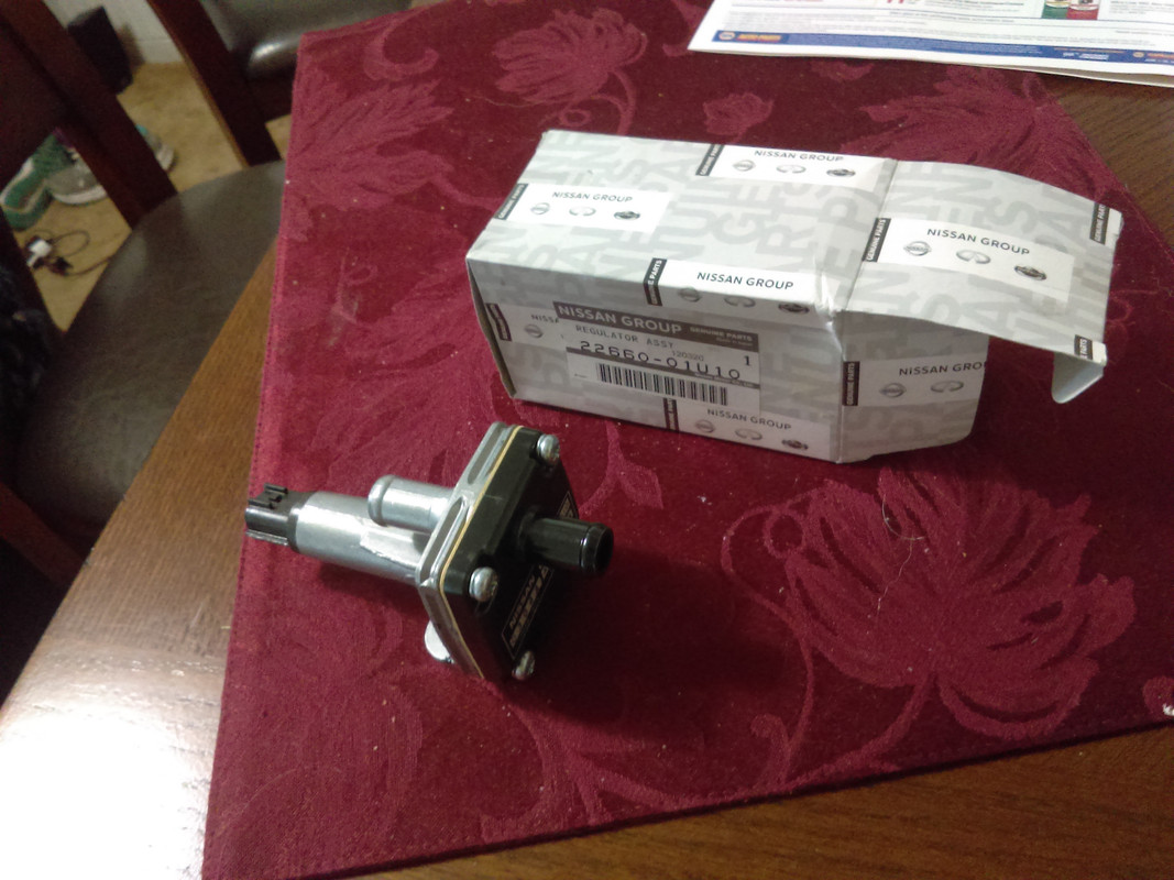

Now that I think about it, it makes total sense. I'll confirm it later this morning, but I already ordered a new one from Tacoma Nissan. Fortunately they had one in stock. Should get it Tuesday I hope. Being Japan is still screwed with coronavirus, figured I'd better order it while I can. RawBrokerage had to cancel a bunch of my gaskets because there was no eta due to the pandemic. Fortunately, this should be the last (he says while laughing) of the things I need to start driving her to work reliably. This and the speed sensor I still have to retrofit.
Idle air control/regulator valve part number is 22660-01U10, fyi. And this one is a different bimetallic spring thing. It has a 4 bolt square plate, unlike the older Maxima/Z round disc that has the same function. If the connector end worked, I think it would probably work the same, but I don't want to make an adapter and try. Just rather have the right part.
So yeah. You know that old adage about free information on the internet? Turns out the throttle position sensor can make it idle at 2000 rpm. It was also mentioned in that thread. So at least I now have a new vacuum regulator. I put it on, and no change. And finally I tweaked the TPS ever so slightly and wouldn't you know, it came back down. 850 rpm. Perfect. So that was annoying. But at least it's one less old thing to fail I guess. I think the TPS was good, and probably just was right on the edge of perfect and then some heat soak and boom, screwed with the values. It was perfect and I didn't change anything until after the idle thing happened.
