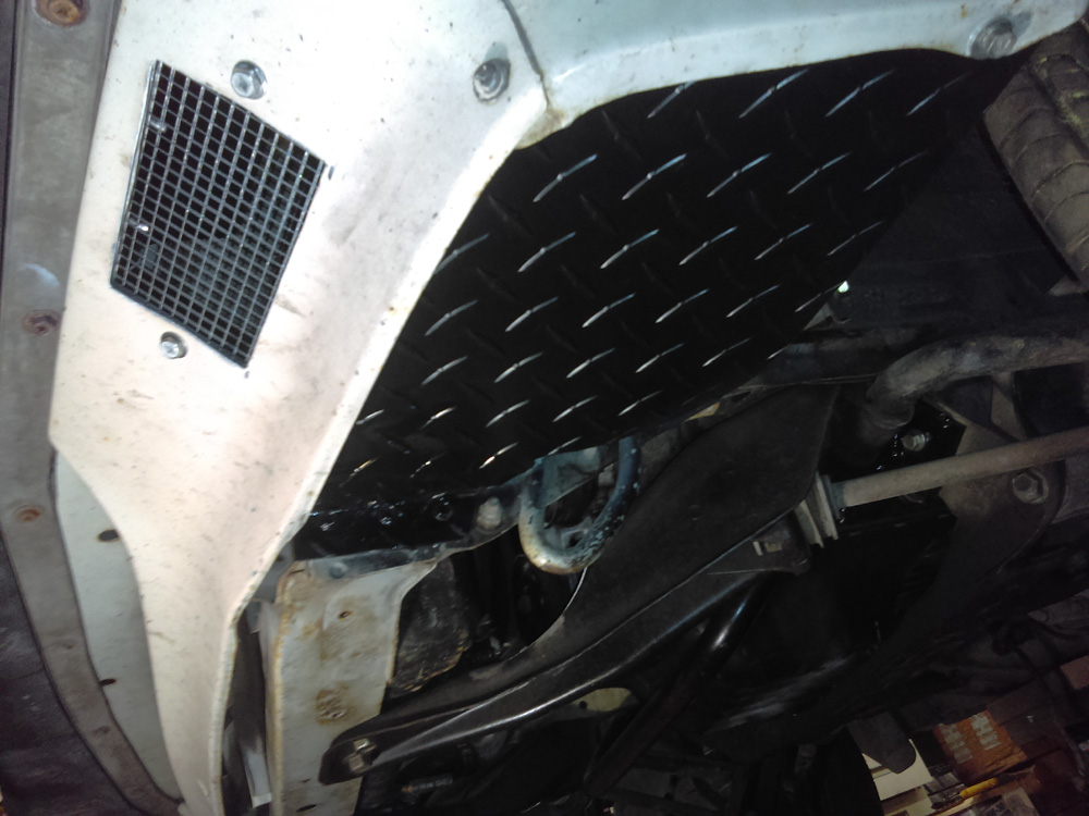

Got the front valence cut, made a little screen for the hole, with a scoop to direct air right at the intercooler. Made the plate on the bottom to keep the air from escaping out the bottom. Adjusted the throttle bracket, got all the wires tied up in the engine bay, shouldn't have anything hitting pulleys or dangling down. Don't have the AC done yet, but it doesn't look as bad as I thought. Other than the lines need to go right where the intercooler piping and air tube is.
