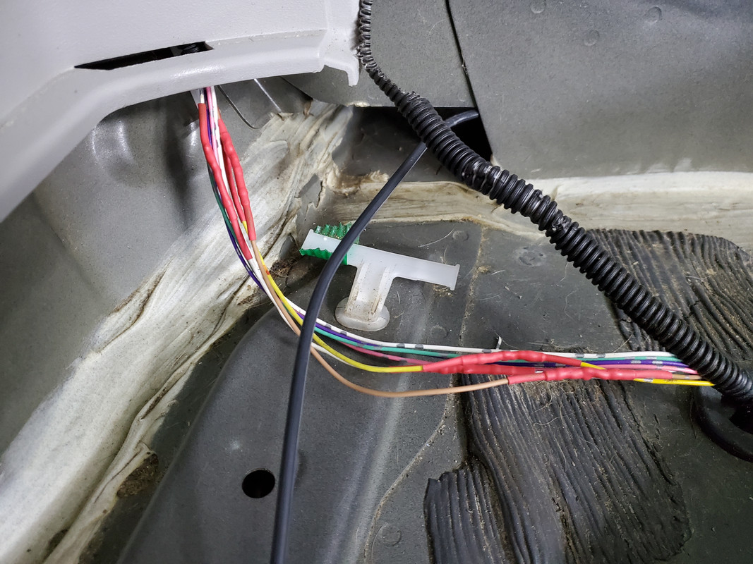

Got the trailer wiring done and finished the inverter installation.

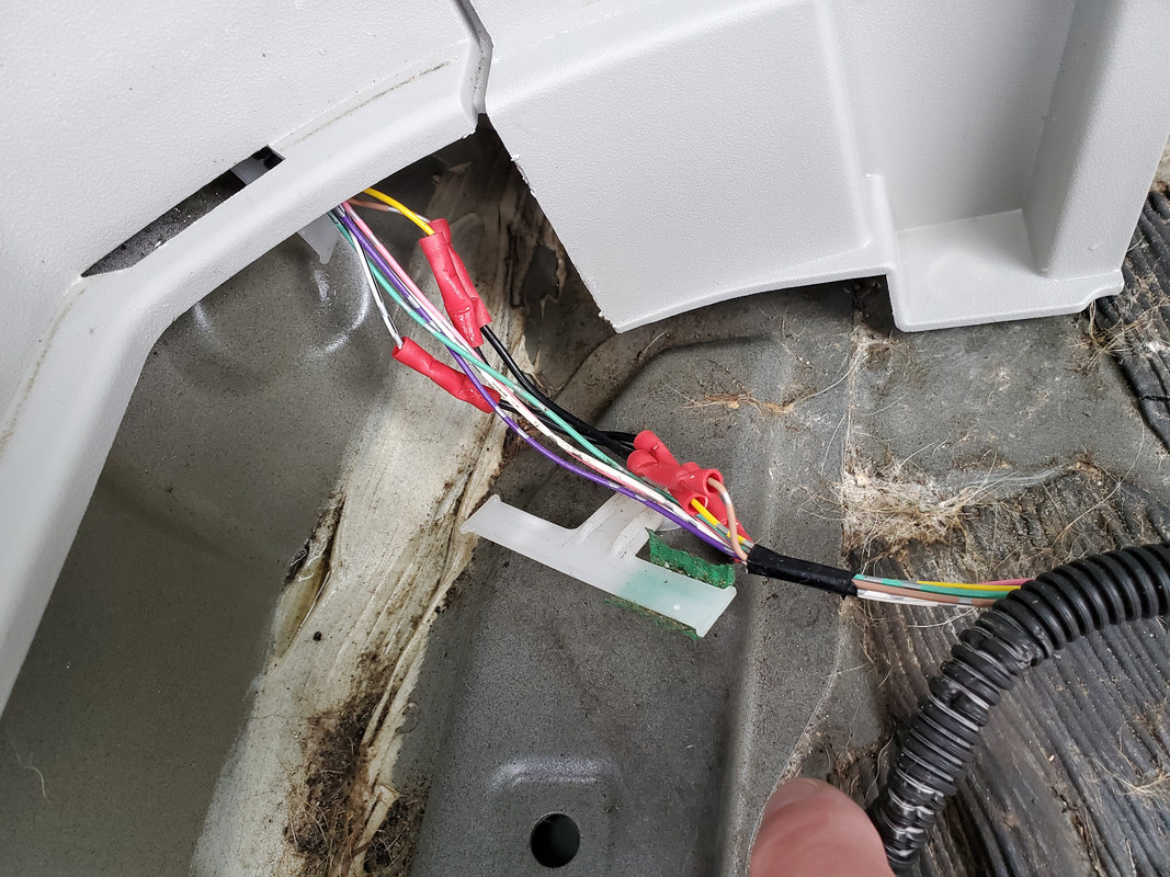

I also addressed the sketchy previous wiring "repair." All soldered and in shrink-tubing now.

As I was reading your post too fast I did not see your comment "I also addressed the sketchy previous wiring "repair." All soldered and in shrink-tubing now.", when I seen the photo I thought that I hate that kind of wire crimper that just flattens/crushes the wire connectors, I have the old school type of crimper that punches a single hole in the side of the connector, unless one does not get the wire all the way in the connector it lasts for a very long time, the way you did it is best. :thumbs:

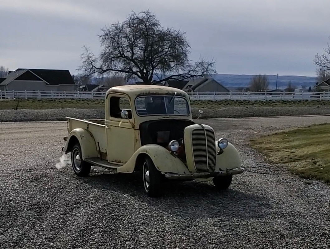

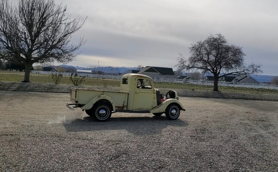

Runs and drives.
#378
I wish I had that kind of engine compartment room in my Datsun 521 trucks, I can barely get the hoods closed.
#379
Ironically, these old Ford pickups take a SBC a whole lot easier than a SBF.

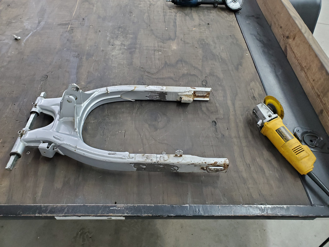

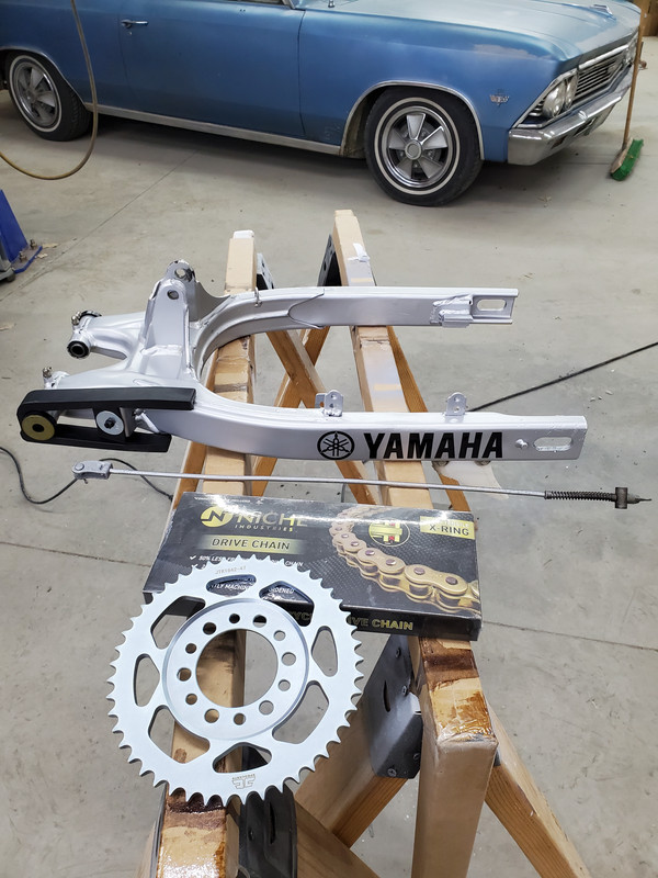

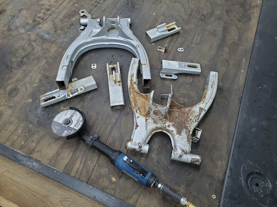

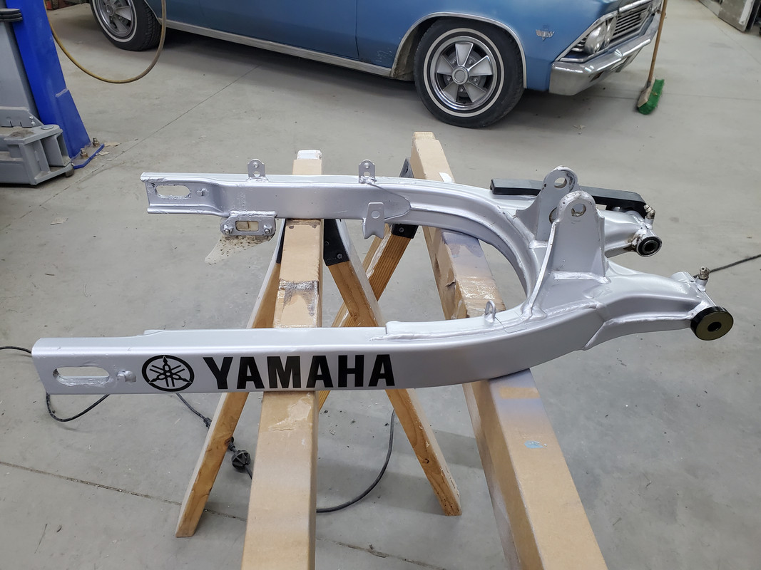

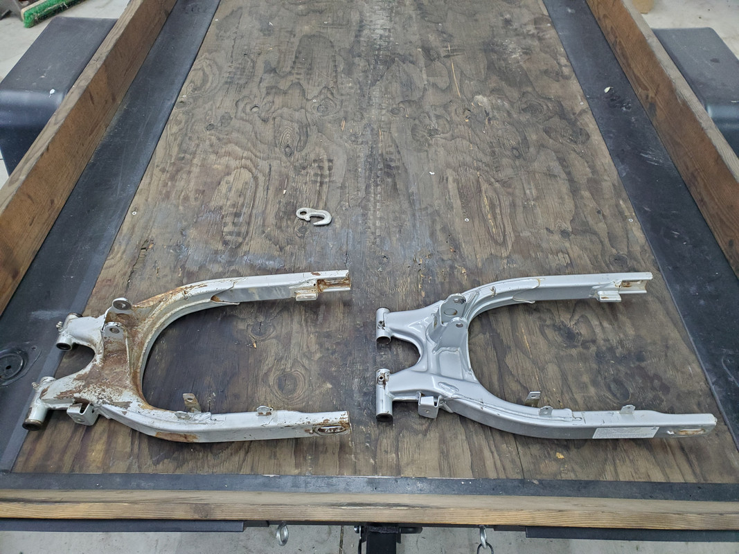

I bought a couple spare swingarms and promptly cut them apart to stretch them 2". I offset the cuts by 2" so that one could be slugged and stitched, while the other will need filler pieces. I finished the easy one today.
I got lazy with the pics as the project progressed. I've got a new front chain guard and swingarm bushings installed. I Ebay'd an XT600 brake rod, which is 2" longer than stock TW. New chain and rear sprocket are ready to go. I'm probably going to order up a Bradley Performance HD rear shock to, but haven't pulled the trigger yet.
