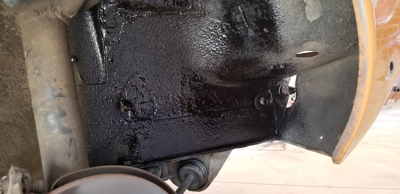

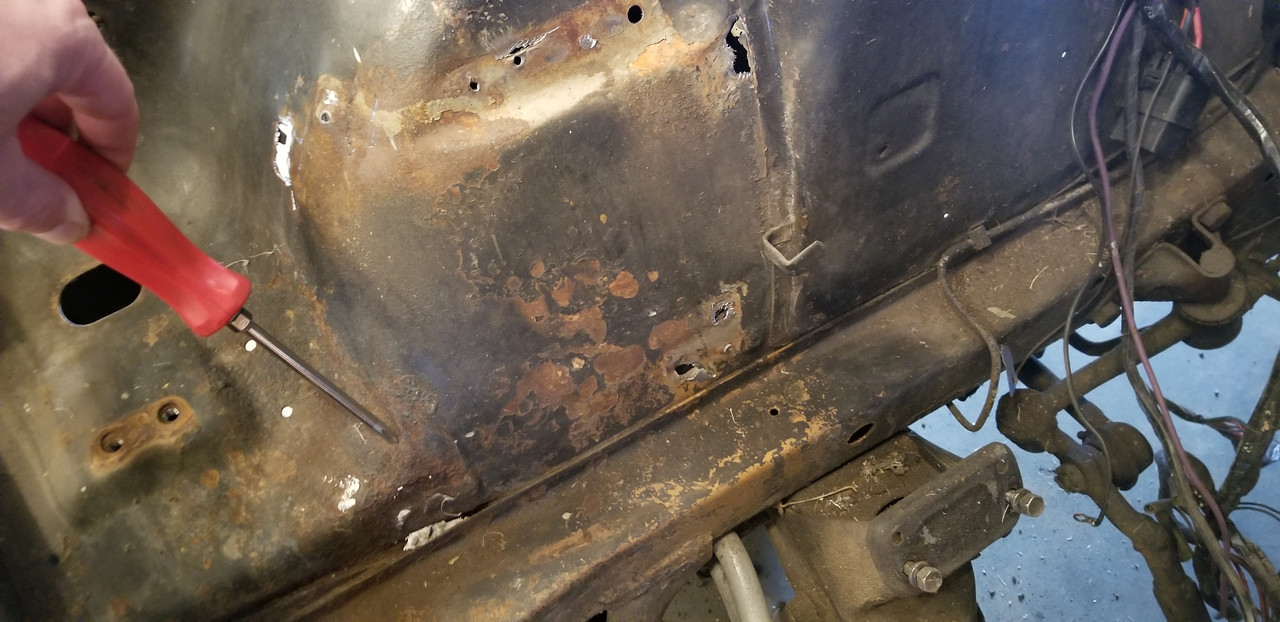

Well, here's the ugly.
That's looking from the inside of the wheelwell just behind where the bumper bolts on.
It was completely hidden under the undercoat and I had no idea it was there. I probed all around and this is the only spot on the entire car. So I've got some cut N weld to do.
Near as I can tell, battery acid leaked behind the lower battery tray support (scredriver) and got past the pinchweld at the rail. Then it just rotted behind the undercoat. Anyway, the engine bay is still super ugly but mostly stripped. I got the engine harness separated from the car but still need to wrap the body harness and free up the brake lines.

That is what happens to Z cars all the time, but its worse for them as it is behind the strut tower.

Maybe. I was honestly really surprised to find it. The undercoat was completely intact and wasn't even visibly bulged. Given how solid the rest of the car is I should count myself lucky. I have a welder and a grinder. It's fixable, just wasn't planning on it.

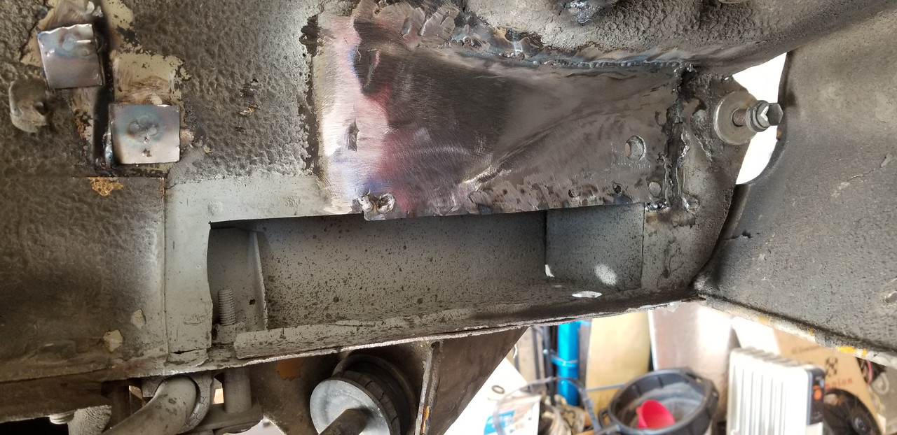

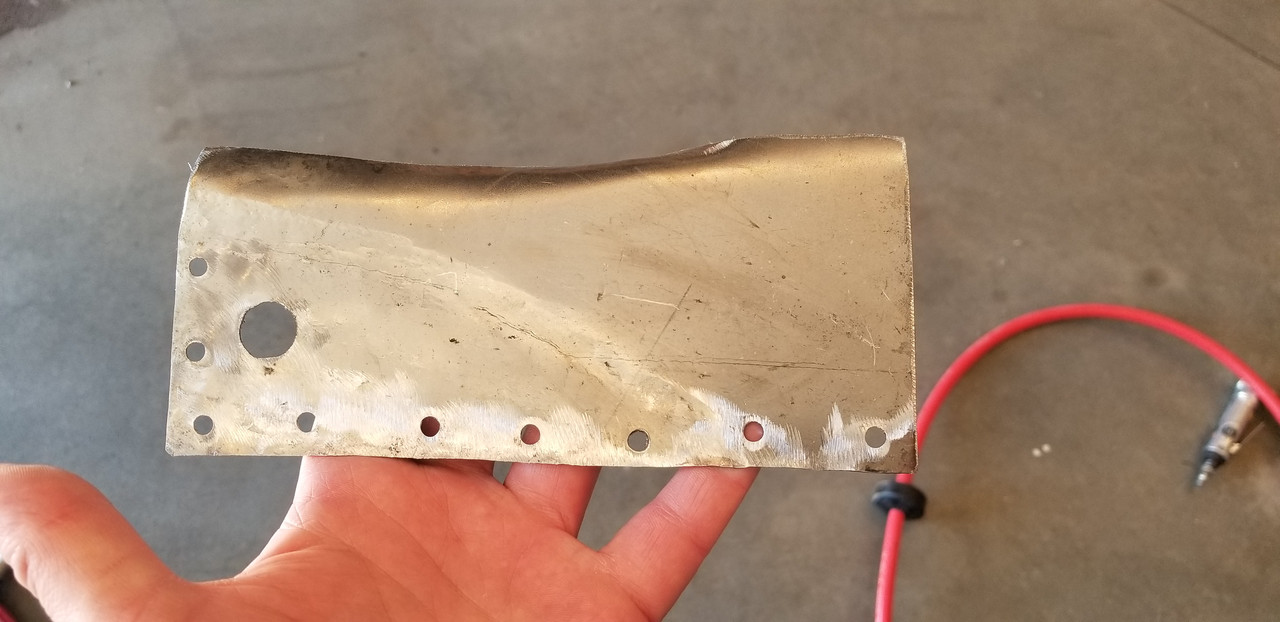

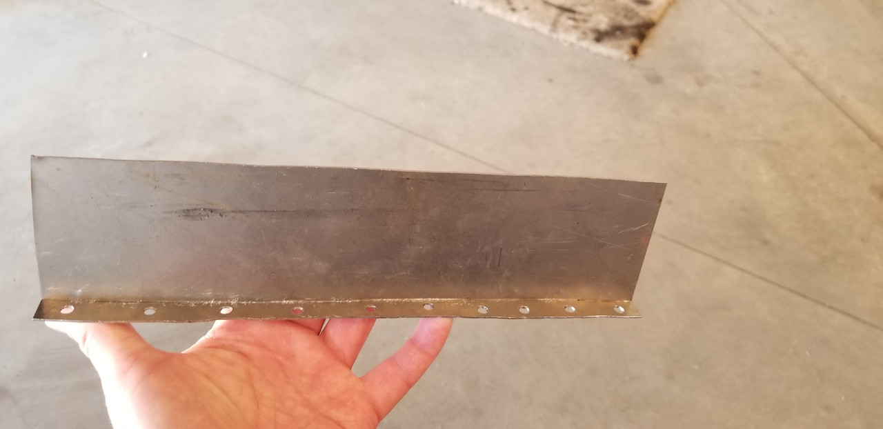

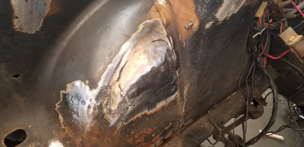

I just fixed that spot on my friend's 510. There are two layers of metal in the front part of the frame rail, the thin metal is overlapping on-top of a thicker piece that goes from the bumper mounting holes to a triangle shape by the crossmember bolts. His car was worse than yours, so maybe leave the some of the thicker metal is you can, especially towards the front. I had to replace everything with one piece of 16 guage:
Re: Just another car I'll never finish.
Thanks for posting those pics. Nice to see how it's put together before I cut it all apart.

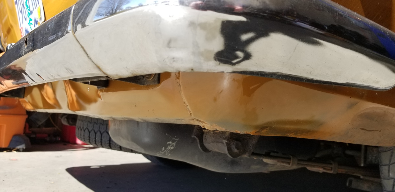

Worked on it a couple hours today. First thing I did was hang the letters. After that I moved on to the rear bumper. So if you go back over previous pics you might notice that the are below the rear hatch was spray bombed with what looks to be dark gray or black primer. At some point the back of the car was bumped in the back and the roll pan is slightly deformed. For some stupid reason someone buried it under black primer even though no body work was ever done. It even got sprayed around the corners behind the bumper ends. Stupid.
So I took some water and a scotchbrite pad and took off most of it on the lower quarters. Then I used the rattle can I had mixed up to paint the roll pan. Repainted that splash apron that tucks into the bumper too. Then installed the bumper.

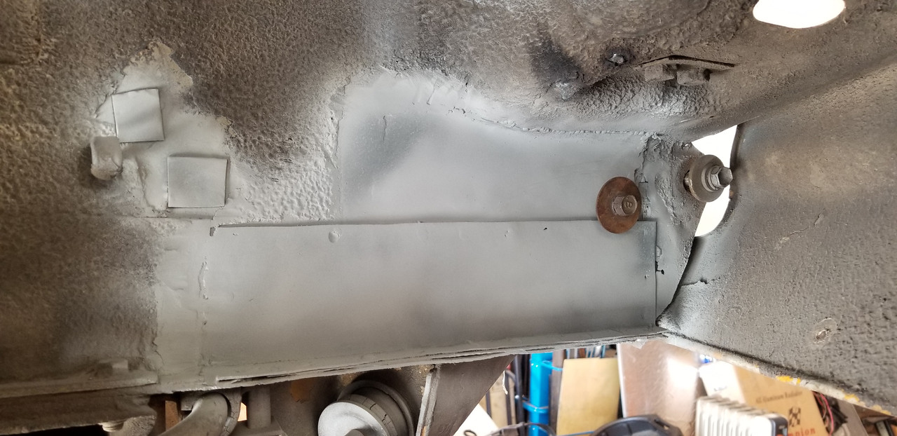

Then I started on the repair. I probably took out more than necessary but I'm thinking it might be easier with big squarish patches. Guess I'll find out later.

Thanks, it's not concours quality but it's not butched out either. I'd do it the same way if I planned to keep it forever. You're right though, it's more work than one might innitially think. At least I had it on a lift so I didn't have to work on the ground.
I've been totally dragging my feet on this part of the project but really need to just buckle down and do it. Once the engine bay is done I'll be able to move on to the fun stuff again.

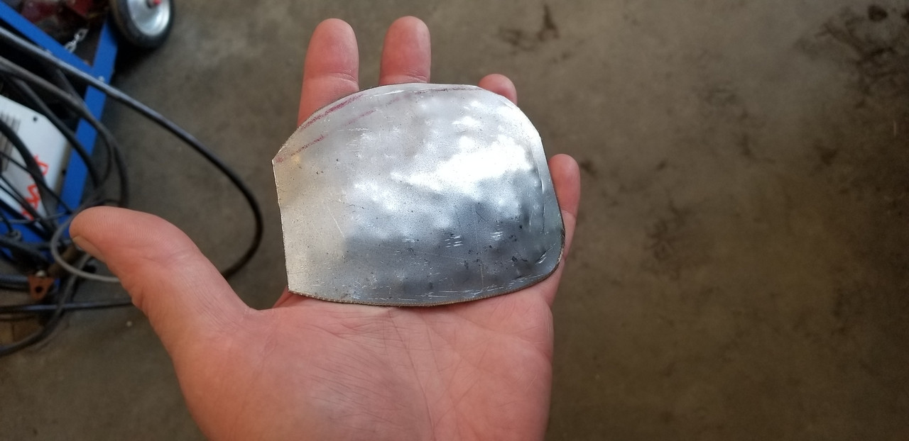

I debated in whether to pound it out or just weld in the new dome. This seemed like the easiest route. It actually came out pretty close. Obviously there will be plenty of skim coat to do before paint. Definitely not metal finished.
