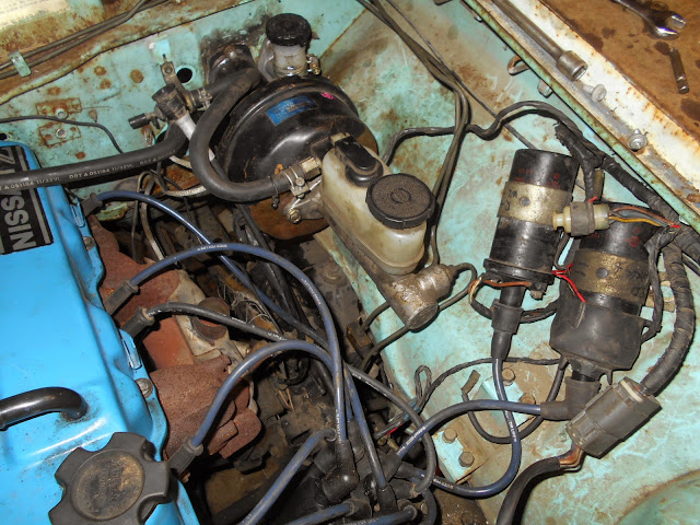

So I dropped the 521 cab onto the frame.
I removed the 521 wiring harness, and installed the 1985 720 harness this morning, it took a while to put this gasser harness in the truck(engine compartment only, will do the cab tomorrow), way more shit than a diesel harness.
Since it is going on a disc brake frame, I also made a power brake setup.
The pedestal and clutch master in position, I did it a little different this time, I kept the clutch master separate from the brake master pedestal.

Since this engine has a weber on it, I am wondering if the ECU is even being used anymore?
Am I able to delete this canister?
Re: 1970 Datsun 521(A frank'n truck)
Posted: Mon Jan 26, 2015 8:50 pm
Probably no need for the ECM. If you can conceal the canister, I'd keep it. Helps smelly Datsuns be a little less smelly.

I just got threw starting and running it up till it was warm, it seems to run good, but I had an issue, it was not charging, so I kept looking for wires I might have forgot to hook up/plug in, but I couldn't find any, so I kept looking at that plug that was supposed to be connected to the stock carb and trying to figure out if I connected the auto choke to the wrong wire in that plug.
Well I gave up on that, and started at the beginning, I started with the fusible links, and I checked for power on all 5 of them, well it turned out that one didn't have power, and it didn't have power because I plugged in the fusible link plug in upside down, so that wire wasn't getting power.
I guess it's always something to do with fusible links on these trucks, what hilarious is that main plug can actually be put on upside down.
Here is the offending plug.
What is this plug supposed to go to?
Would it be better to put the stock carb back on so that the ECU is operational again?
Does the weber have more power than the stock carb?
Here is the engine bay as of now.

On mine, that looks like the plug that goes to the EI Dizzy matchbox.. but that couldn't be right if yours is running..
Posted: Thu Jan 29, 2015 1:17 am
It seems to be part of the carb harness on the passenger side, that plug below it with one wire coming out of it going to the auto choke was likely for the stock carb also.
I need to find a 1985 Nissan wiring diagram, I have looked a few times, but have been unable to find a readable one on the internet, I have a diesel one on the wall of my dining room, it's about 4X8 feet big, I can read that one, but it's for a diesel, it has no carb wiring.
