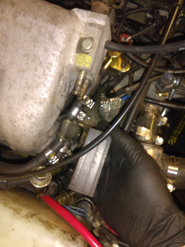

Motherfucker! So the rear Sentra one does NOT even come close to passing fluid through the curved nipple end. It dead heads. I put the factory rear regulator back on, car runs again. However, the front regulator is either working, or just bypassing. I don't have a spare new one to test, and the rear one is still original, and old.
The question is now: do I buy the two factory pressure regulators offline (assuming I can find the rear one, and it'll take a month from Japan) or should I just put some adapter fittings in so it's not regulated, and run an Aeromotive adjustable fuel pressure regulator like the race car has. I'm leaning towards an aftermarket regulator, though I really did want to keep this thing stock, and new fprs will easily last another 30 years. Then again, adjustability is nice if I ever need to do a little tuning on the wagon with the stock ECU. Or if I upgrade ECUs at some point in the future.

Ok, so interesting. I have been reading more. It appears the rear FPR (inlet) may actually be a fuel pressure damper, while the front is the regulator (outlet) So technically I may just be able to get the factory FPR for the front, which explains why I can find those, and the rear, well, I can do a bypass or something else. Or just leave the original in there since it's not leaking. BUT, I'd still like to replace both or switch to a single regulator setup. I remember the old 280zxs having a fuel damper that caused issues off the fuel pump in the back. Most everyone removed them and they were fine. But it does screw with idle quality. How much, I don't know. Probably just going to have to remove it and find out if it's annoying or nothing to worry about.

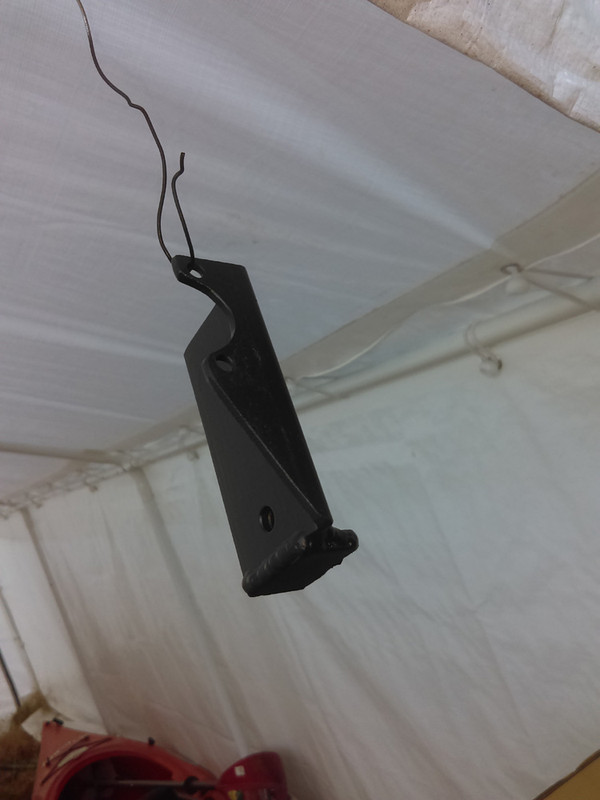

Makin' braccckkkeeeeetttts.......pretty sure I'm going to need to cut that bottom piece out for the return line, I'll double check. Didn't think about that before I painted it, lol. This time I should be actually able to use the liquid filled gauge as it will be vertical so the fluid won't leak out.

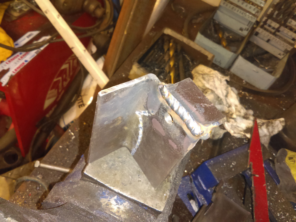

Motherfucking ISR fuel pressure regulator adapter!!!!! I tried to weld it 4 times, leaks every time. Wait, back up, I wanted to re-orient the nipple, so I cut it off, welded the hold and drilled another hole to put the nipple in. Every fucking time, I get a leak. Finally, I weld the hole, spin it around on the fresh side, tape it for 1/8 pipe plug and figure it'll be good. Nope. Itty bitty bubbles on the back side I just welded. Enter setting 4 and lots of wire. Boom! It holds! I put it on. Just the ever so slightest leak, still.
I have come to the conclusion whatever ISR made their adapters out of, has porosity or some other thing that makes gas bubbles during welding. So I said fuck it. I'm in the process of cutting apart the brand new regulator I had that wasn't going to work (the hardbody one) and welding it back together as a pass-through, so it can connect to the new Aeromotive regulator and just fucking work. Will do that after dinner. I am so mad right now, its not even funny. Hopefully dinner will improve my mood. I've wasted about 4 hours in a hot fucking garage only to get really really small fuel leaks. Sigh.

FUUUUUCCCCCKKKKKK. Should have called dad sooner. So, yeah, the ISR adapter is goldish. So zinc coated. And apparently zinc releases inpurities, which is why I had little leak bubbles everywhere I welded. Apparently you need to grind the zinc coating off really well before you weld. And I didn't do that.
I'm guessing the factory regulator I cut up is zinc-coated as well. So yeah, fuck me. Apparently I didn't know what I was doing. Dad says you can also silicon bronze weld those with a tig. Which means I'll probably drop those off at his house when the come in. I got frozen yogurt. It's hot. Fail today.
