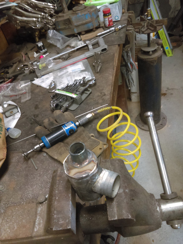

Anyway, the really pitted water tube that I originally had dad fill with silicone bronze turned out to have a leak. Rather surprised, it looked great, weld portions were clean, but somewhere there was a crack so it just puked even without pressure. Started dealing with that, thought I could cut it open and weld inside, figured that was a bad idea. And since Nissan was so stupid as to trap this thing under the intake, I decided to alter it. And made a cool tool in the process! Not to mention used the drill press as a lathe! ;)
Used a drum sanding roll arbor to chuck it in the drill, then the carbide Christmas tree bit to cut ridges, and the file for filing down the 1" pipe wall so it would fit for a 7/8 hose.
This is finishing up the replication of the original piece, which used to be permanently attached. But if you want to detach it, you have to remove the intake manifold since the bolts on the front end are trapped by the water outlet/thermostat housing that is part of the block. Super annoying. The pieces are galvanized fittings from Ace Hardware, which luckily are just about the right size to work! The only bad thing is welding galvanized to regular steel, lots of inclusions, but Dad did a nice job. Pressure tested it today, no leaks!
The really cool thing is I had an idea and confirmed it, forgot to take a picture of the tool, but basically a pair of wire crimpers, nice ones, with the bell for uninsulated. You cut the end off and make a bead forming tool. It actually works amazingly well!
Look, it all fits now!
