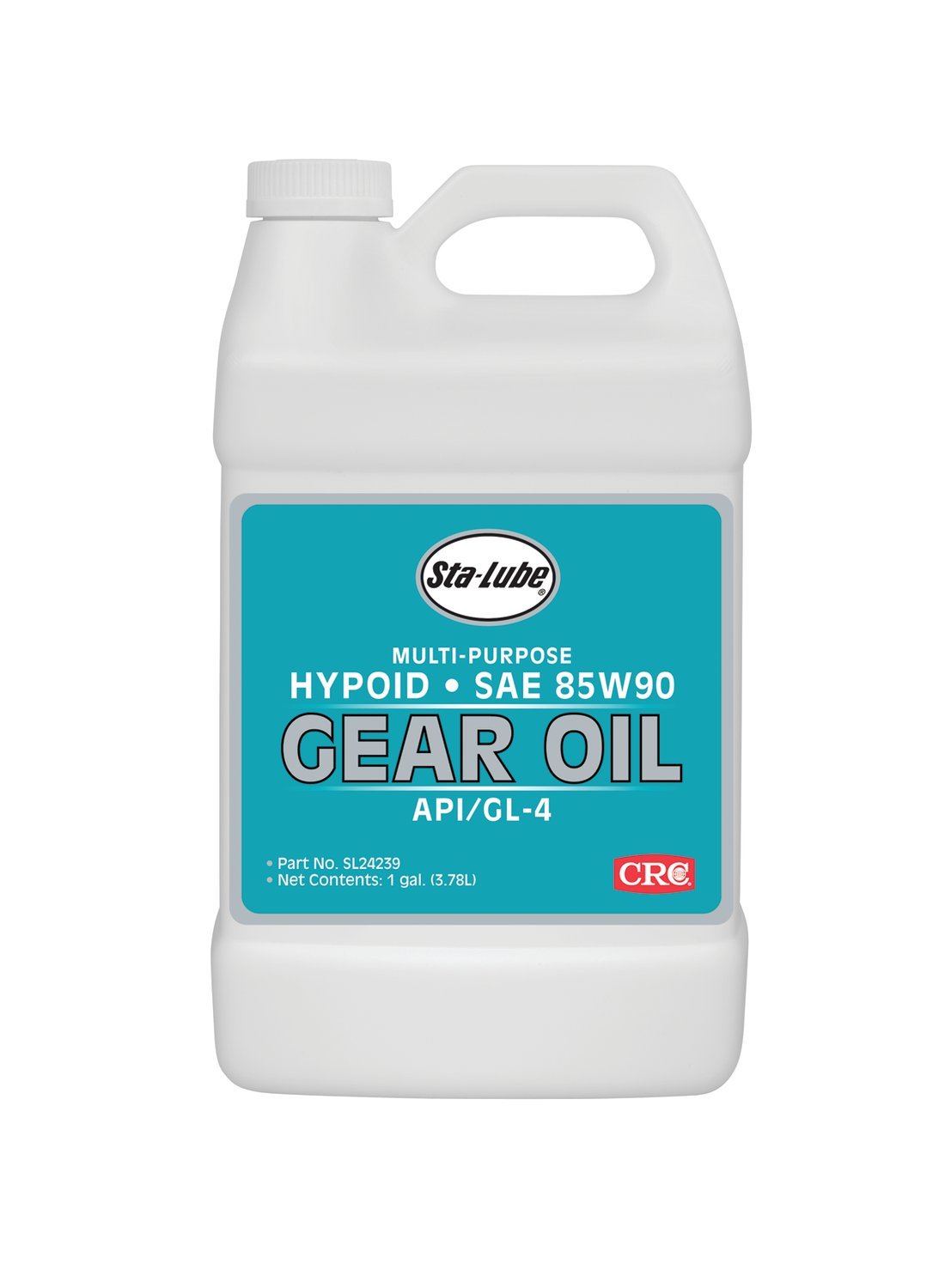

by MicroMachinery
Make sure it's GL-4 ONLY. The off the shelf GL-4 / GL-5 stuff will turn your brass syncros to feces.

Yeah.
I looked all over, nobody has just GL4 rated stuff.
I ended up with a bottle of Valvoline 80w90. It didn't say API-GL5 on the front, but on the back it says it meets and exceeds that of Gl4 and GL5

by MicroMachinery
They sell this stuff alot of places. A bit pricey, but cheaper than a new trans.

There is not much of a selection here lol
All hypoid differentials (conventional and limited slip) and manual transmissions in passenger cars, light trucks, sport utility vehicles, vans and heavy-duty trucks where an API-GL4, API-GL5 or MT-1 fluid is specified.
dats wha the bottle says anyways :\ Fuck. Well I'm shit out of money. So guess it will set for a few weeks.

by datsunmike
Won't hurt in the short run but keep looking for "Yellow metal compatible or safe" GL5 exceeds GL4 but that doesn't mean it's better for it. GL5 contains more of what makes it bad for your transmission.
Differentials have different gears for transmitting power through a 90 degree bend and requires a much stronger EP rating and anti scuff formula. Transmissions transmit in the same axis and their gears are also different.

So you think it will be fine for a little while mike? LIke a month or two? Till I can track down a bottle of sta-lube
