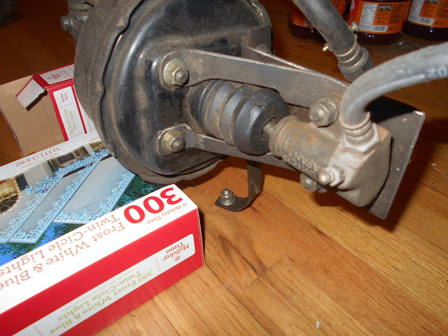

I actually made this remote brake booster up a long time ago, but I never got brave enough to try it out, as my brakes have worked good enough so far.
That is a 521 slave connected to a Ford Courier booster, I cannot remember what master it is anymore.
I actually had it mounted on the driverside fender well, but I never piped it.

This was back in the pre-forum days(before 2010), I did a lot of that kinda stuff, the work truck was basically the way it is now, the 720 dually was finished/painted, and the 521 kingcab extension had been welded together already, that is when I joined Ratsun, right in the middle of that project.
I suppose that the remote booster would have worked, but having 2 completely separate master brake cylinders just didn't sound great to me, I suppose I should have tried it, that's why I still have that unit, I put it on the shelf and forgot about it till I needed it, I just have never needed it, once I put electric brakes on the trailer, the truck stopped decent, so I forgot about it till this power brake booster for the 521 subject came up, I even had it mounted in the truck.
I got the remote booster idea from the classic american vehicle industry, they make remote power brake boosters, but they don't look anything like mine.

That is crafty! In theory you could mount that anywhere.

If you could use a electric brake set up,to use the remote master/booster
that would free up some space(maybe where its needed)
