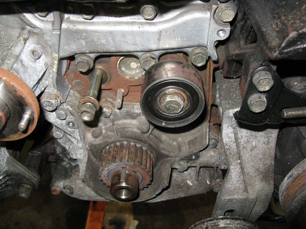

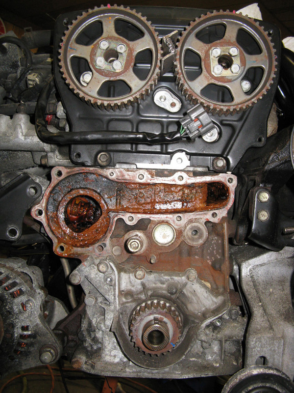

Got the garage nice and toasty today, ended up getting it torn down to the point of happiness. Have new parts to put on after some cleaning. The cams don't move much but I made a tool anyway, so yeah, I'm Batman!

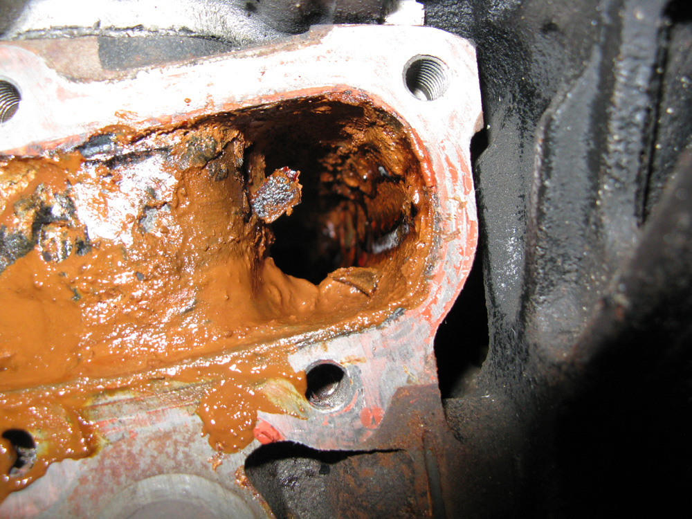

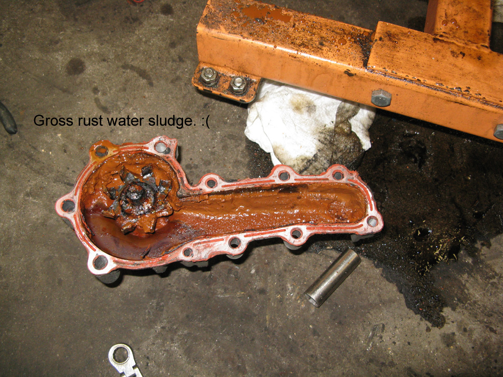

Not that thrilled with the water jacket being full of rust sludge. I smooshed it and smelled it, it's definitely rust, although nearly looks like stop leak. No big chunks, just a paste. Thinking I may run a garden hose reservoir through it on first start up instead of my nice brass radiator. We're a ways away from that yet though. Need to find some broken connectors, a temp sensor (also broken) and lots of vacuum lines, etc. Not sure what I'm going to do for an intercooler but I'll find something. For being a 94, this thing is still fairly complex and all the water fittings look like shit. That's what happens in a salty coastal area though.

It appears to have had straight water in it instead of an antifreeze mix.

I agree with both Wayno and Jacob. Looks like they were running straight water. I'd really consider sourcing a set of new freeze plugs, knocking the old ones out, and flushing the shit out of that thing before it goes back together. Back and forth and see if you can get in the water jackets with brushes, etc. I'd hate to see you have to fight plugged up radiators and heater cores after you go through all this work.

I may pop a plug or two and see how it looks. I don't disagree, just really wanted to put shit on and go. Bah. Fuck this shit for now, I'm going to go eat. Found VG30 thermostat and RB are the same, and I got a temperature switch from a 2001 Frontier that appears to be the same as the broken one. Just have to ohm them out and check the connector. The one I got fits a shit ton of vehicles, probably correct.

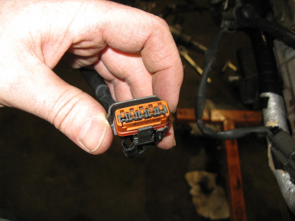

Ok, haven't verified the temp sensor yet, but I did find 2002-2006 Nissan Sentra QG1.8 MAF connector will likely work for the RB20 MAF connector. I'll go to pull and save tomorrow and get one to try.
So the MAF connector from 05 and 06 Sentras with QG18DE didn't work, they have smaller pin sizes. BUT the '04 Sentra MAF sensor connector works! It has 5 wires, just have to omit one. Slight ohms difference on the temperature sensor I picked up, but I think its close enough to be the same. Actually, just found the factory number on the internet and back crossed it. Same temp sensor as 2001 KADE from Frontier and a ton of other stuff. 1435077 ATM part number at your local NAPA.
So that will work. Pieces coming together.
Latest issue is I wanted to replace the oil pump seal just because. Found out the crank sprocket gears on RBs like to weld to the crankshaft. Typically have to split them to remove, then put on a new gear. So debating if I want to do that, or just say fuck it and leave it alone. Think I'm going to order the parts just so I have them if I need them. All this RB shit takes too long to get. So far, not much other than seals and some sensors crosses over to any USDM stuff. Not too hard to get parts, but it's all ordering online and waiting a week or more. Got to get a clutch set coming too. The flywheel had some pretty decent hot spots on it, but nothing too terrible. Should turn out okay. All sorts of clutch sets with flywheels oddly enough. Doesn't look like there should be any issue with turning the flywheel. Not a dual mass or anything, just standard Nissan.
The oil pump on the RB is similar to the CA. They dont have too much issue. And yes I went and removed the Timing Cog on the crank. I drilled/tapped it and pulled it off that way.

Yeah I started reading up on that, the crank sprocket is slightly thicker on the CA oddly. Like 3 mm. Either way, have all parts coming. I like your idea of drilling tapping. Think I'll do that and make a puller, that ought to work nicely. I don't even really need to do anything, no signs of leakage, but I'd rather replace a 90's hard seal now than wait for it to start leaking after I install. Or wear a groove in the crank.

What a motherfucker! The crank gear was a bitch. I originally only drilled and tapped two holes in it, tried to pull it off, wasn't having it. Bolts kept bending, didn't get it quite on straight for the holes. Anyway, ended up cutting the gear on top of the key way with a die grinder, then a Christmas tree carbide burr to make a trough, and then drilled out that hole so it just barely went into the keyway. That was the last amount of pressure it needed, came right off then! Still needed the puller. Rusty dust crank, cleaned up pretty easily with some 220 though.
