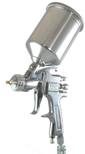

I have a HF HVLP gun.. but the tip is too small for spraying primer. Also the gun is really not that great. It functions.. but I wouldn't use it for anything but primer.. and since the tip is too small for primer.. it's not really useful.
That being said, I bought another gun today. The Devilbiss startingline with a 1.8mm tip:
