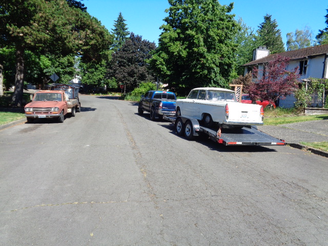

Well it is gone to a new home.
Posted: Mon Jun 27, 2022 7:27 pm
I'll take a picture of my ugly mug for you when I check it out.
I'm actually quite excited even though it's not mine.
