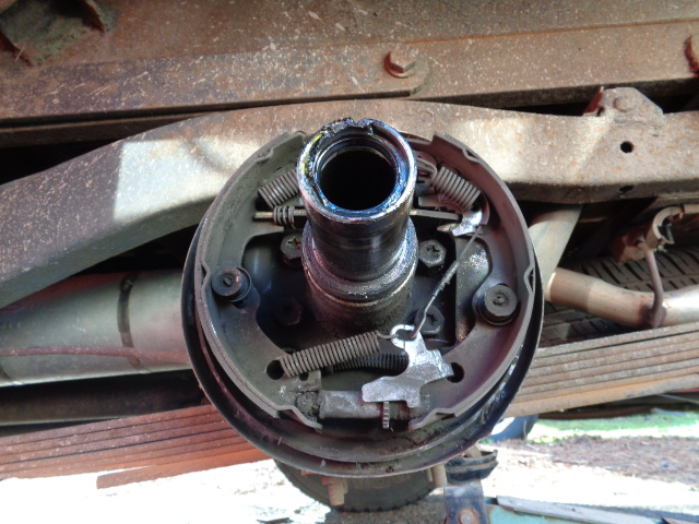

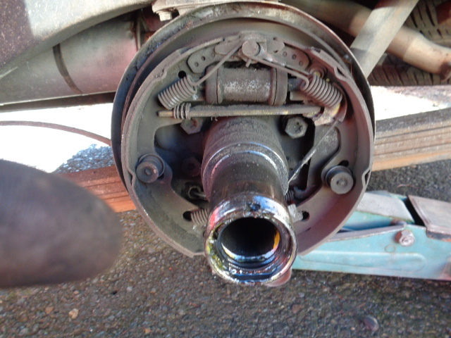

I did the rear brakes yesterday, the e-brake was not holding very well so I decided to see if the cables were rusted solid, but they moved, but when I seen the brake shoes, I went in and found a box of unused ones I bought from Nissan a long time ago, so now I need another couple sets for the future, if not available I will need to have my old ones re-shoed.
I took them photos to make sure I got it back together correctly but I did not need to use them as I did not forget how to put it back together, but I sure was talking to myself, them damned little springs that hold the shoes in place(front and back shoes) so all the larger/stronger springs can be installed, well I could not get one in place, it took somewhere around a half hour to get that cap on the spring, them caps that you put on and twist, I used to do it with my thumb, but now I have to do it with pliers, I also lost one of them caps when something fell on it.

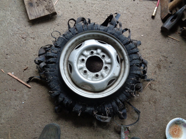

Well this happened today, my trailer tire came apart like a retread does, it wiped out the wiring and the fender on the trailer, I walked back and picked up the fender out of the lane it was in, I was not able to find my license plate, I spent 4 hours unbending the fender and welding it back on, and I figured out the wiring also, the trailer brakes work again.
It did not even hurt the rim, it is perfect, no road rash, the rim itself never touched the ground.
I used what I had around here for lights, the top is running lights and brake lights, the two small lights are turn signals, they are very bright.
Someone stopped to help me but I was tightening the lug nuts by that time.
