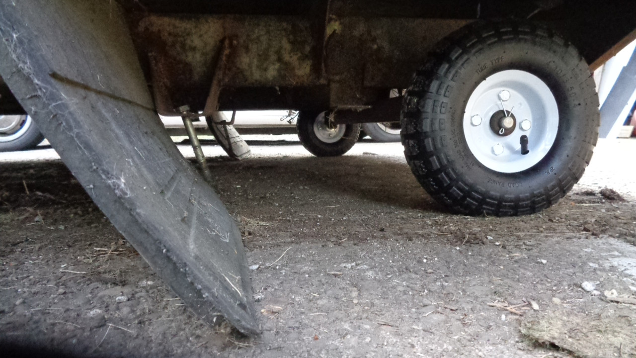

I thought I had the flatbed sold but the guy backed out, so I made a set of mini axles to be able to move the flatbed around, I wish it would fit in my back yard but it is too wide to get between the house and my fence.
They are cheap wheels I bought at Harbor Freight, they are rated for 300lbs each, but the hub of the wheel doesn't take a lot of sideways pressure before bending as I tried to lift and move one end sideways and it bent the wheel, but it was easy to bend back, I made a way to turn the flatbed but need another wheel, maybe I will buy a couple more tomorrow as one of my engine stands needs another wheel as the one it has only holds air for a minute if I am lucky.
These mini axles are not welded/bolted to the frame rails, I welded 90 degree pieces of angle iron(foot long) to the axle and the frame rails just sit in them, if I lift the flatbed up they will fall off the frame rails, but they were made to roll the flatbed around my driveway, not down the street.

I need a pair of wheels like that so I can build a little trailer for my sprayer. Would they be sturdy enough to haul 100-150 pounds?
- Posts: 5321
The tires are rated for 300lbs each, I do not know what the flatbed weighs but I am sure your sprayer is a lot less weight, 2 of them are good for 600lbs, but like I said the hubs/rims are not that strong with side pressure.
I paid $6.50 each and I made sure they were holding air before buying them, one cannot expect a lot out of them, I just want the tires to hold air.
I use these tires on my engine stands, them diesel engines weigh a lot, I towed one with my tractor, so unless your sprayer tank holds a 100 gallons I expect they would work for your sprayer.

Yes they will hold the sprayer, but I always have to air up the ones on my hand trucks.

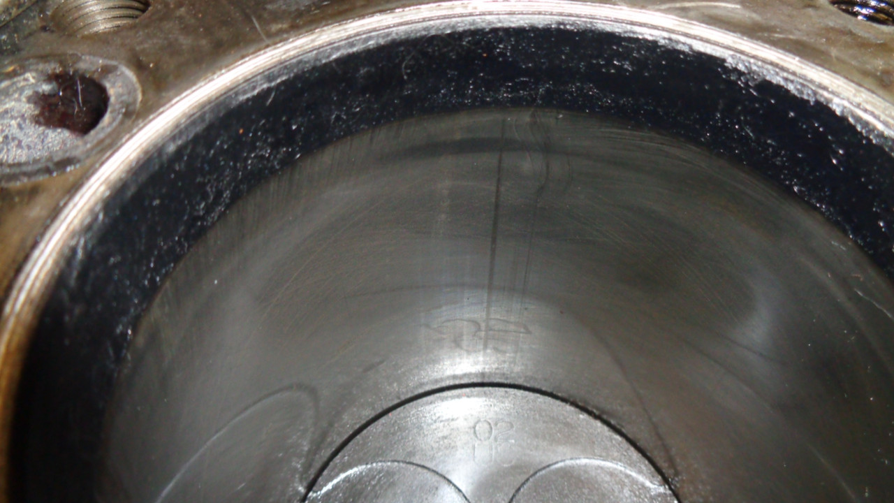

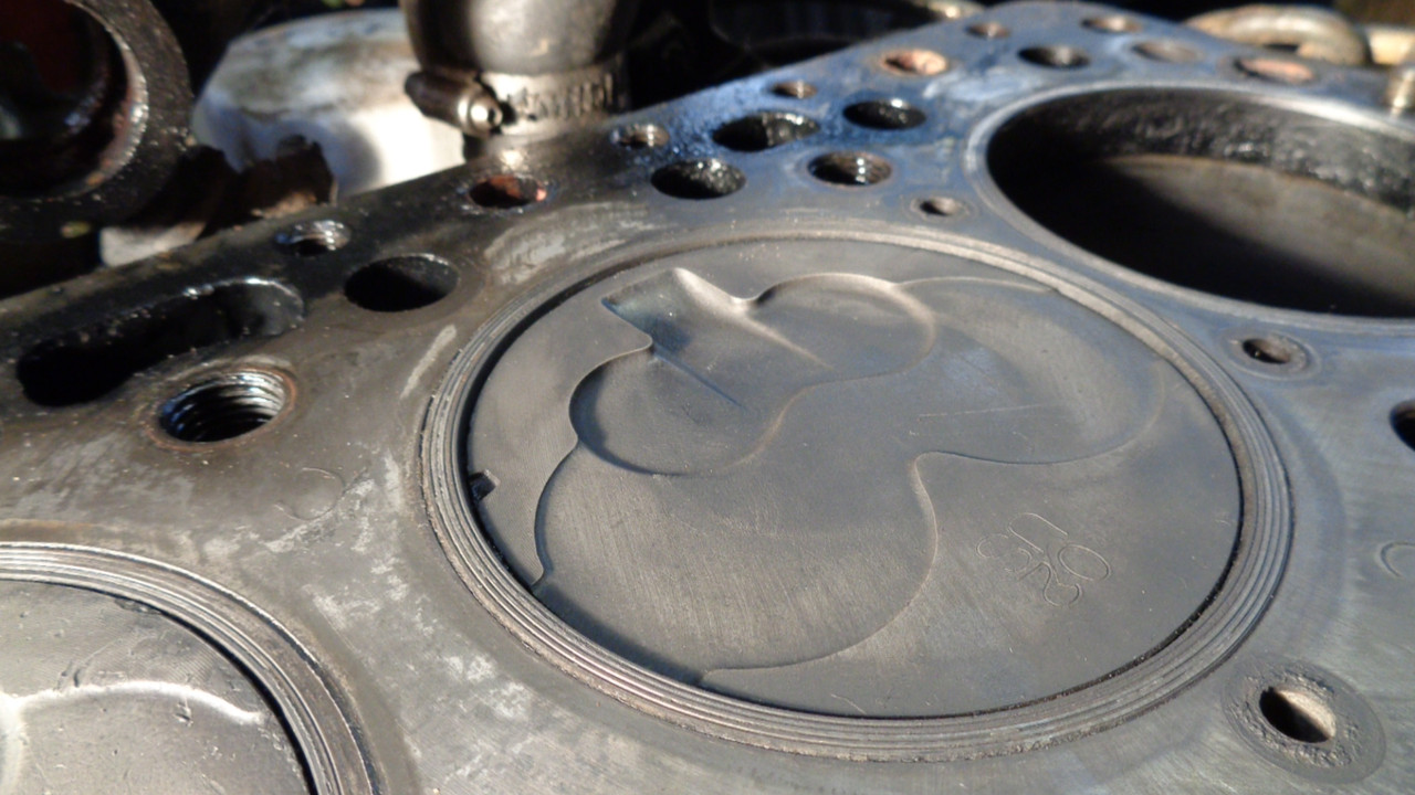

I went to my machinist and talked with him about this block, I told him the head looks great and the pistons look almost new and I told him the bores were smooth, I cleaned out each cylinder once I got home and looked closer, all four photos are of the driver side of the cylinders.
#1 cylinder
#2 cylinder
#3 cylinder
#4 cylinder
Except for these lines which I cannot even feel or catch my finger nail on are what are there in each cylinder, the other side of each cylinder may have a few lines also but not as bad if having any lines at all, #4 has none at all on the other side.
The rest of each cylinder has cross hatching, it can be seen in the photos, I could not even see any of these lines until I wiped the cylinders down with a rag, now I said the pistons look almost new except for #2 which has a few dents and one raised spot.
Also I noticed something, #3 piston comes up short of the deck by 1mm, #1, #2, and #4 are flush with the deck, this seems weird to me, 1mm is a lot considering I have not loosened the rod ends or crank bolts.
#1 piston
#2 piston
#3 piston
#4 piston
I tapped on #3 rod end and nothing changed, but I tapped from the bottom up instead of turning the engine over.
The gap.
The more I look at this engine the less I like it now because I do not know what is except-able, but I don't want to throw anything away that I may need in the future either.
#1 cylinder
#2 cylinder
#3 cylinder
#4 cylinder
#1 piston
#2 piston
#3 piston
#4 piston
The gap.
What is the bore size/stroke length? My guess would be that there is enough side load on the pistons due to Nissan probably just making the stroke bigger. So when the Crank is shoving the Piston up, its scuffing more on that side.
Piston 3 being lower is weird, I do not know enough to even guess.
