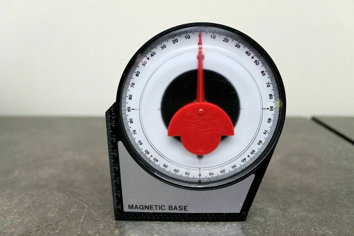

Do you have one of these?
Posted: Fri Jun 03, 2022 7:39 pm
DRIVEN wrote: ↑Fri Jun 03, 2022 7:16 pm
No I do not have that, I added to my previous post, I put the wedges in wrong.
Posted: Fri Jun 03, 2022 7:44 pm
Ahhh. That might be the problem.
Posted: Fri Jun 03, 2022 11:40 pm
I do not know what I was thinking when I put the wedges in, what I did would change nothing, I re-did it this evening and used the 2 degrees wedges, I will try it out tomorrow.
I do not really understand how that gauge would work when one cannot really get a good edge on the pinion flange or yoke, I have this tool that measures angles that I use to check angles on my telescopes so I know what angle to drill in a block of wood, but it is easy to check an angle when one has a flat surface, there is no flat surface on a pinion flange unless the driveline is removed, then you are using how level/unlevel something is, not the degree difference as I cannot measure the angle of the driveline if it is not connected, I cannot even get to the transmission yoke and the driveline near it to measure that angle, I cannot even get in a position to eye the angle and use my gauge/tool for angles, so right now I am guessing.
I lowered the rear with 3" blocks that have no degree angle in them, the front was lowered about the same amount between the drop arms and torsion bar adjustment, I put the thick end of the wedge towards the back to lower the pinion flange in the front as it was slightly pointed up, I will see if it gets worse or better.
Posted: Sat Jun 04, 2022 5:10 am
The angle finder is obviously really easy to check the driveline. You don't need to use the transmission yoke. The oil pan rail or even the valve cover will be on the same plane. For the rearend, you can either drop the driveline and check the face of the yoke, or even back where the 3rd member mates to the housing. Whatever works. They say the ideal target is between .5 and 3 degrees. Less will wear out Ujoints faster because the needles don't rotate. More puts additional stress on everything. I wouldn't stress being inside that window too much on a car like yours, it's much more important that the angles are the same front and back.
