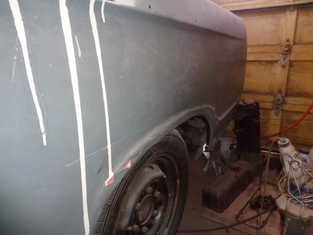

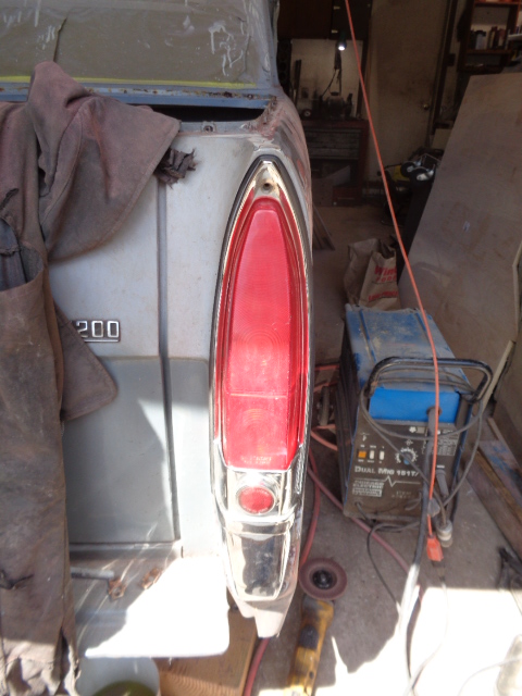

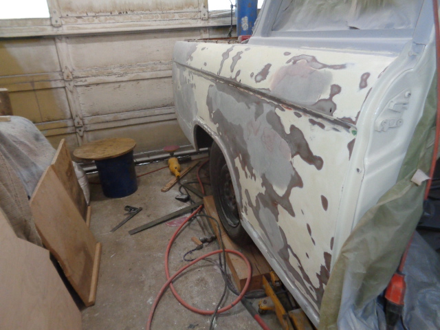

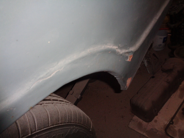

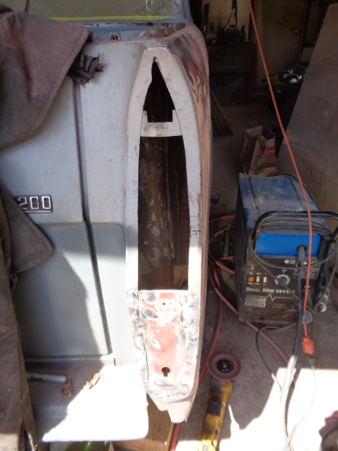

Well I have it close now, it's never going to be perfect as I cannot or maybe I should say I will not remove the panel as I don't have one to replace it, I do have a left side NL320 panel but this is the right side I am working on.
I made the plate and installed it.
Here is the taillight assembly installed.
Here is the side from two different angles, it looks close now, closer than whoever the guy was that fixed it before in Australia when the damage occurred, there was one or 2 spots where the bondo was at least a 1/4" thick, the layer I will put on will be less than an 1/8" thick and I will use bondo hair(long and strong) and I likely will finish it with glazing putty.
I am actually out of mud(bondo products) right now, this has been a couple days where I made progress forward instead of backwards.

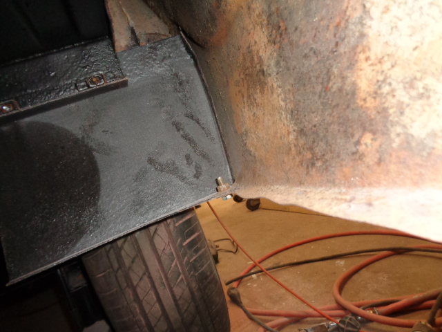

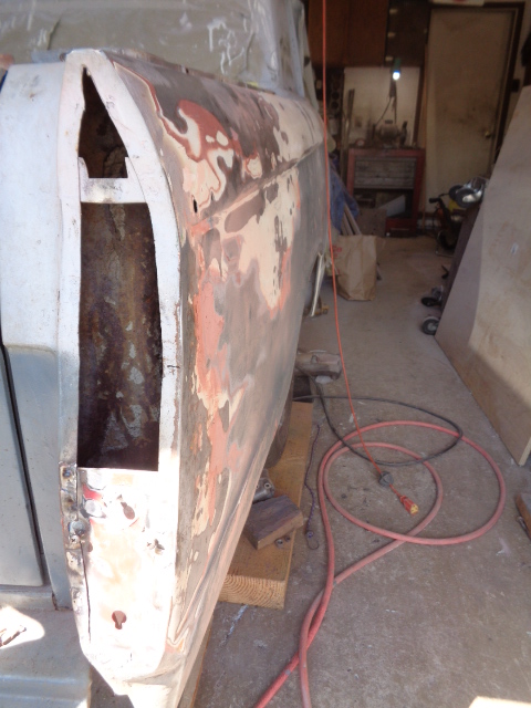

OK, I added the brace for the rear lower skirt.

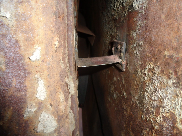

But the fender panel was still moving to easily between the that point and the taillight half way up or down depending on how you look at things, so I made a brace and installed it, it is welded to the outer sheet metal but floats on the inner panel.

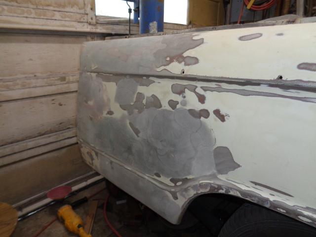

I got 90+ percent of the bondo off this back panel and I used a hammer and whatever you call them hunks of metal to take the dents out from the inside and outside, I used a straightedge on the other side to see what the body panel curve is supposed to look like and I have it close, but in the end it will likely take me 10 tries to get it the way I want when I start applying and sanding off the mud, I really have not done much in front of the fender well and back of the door, there is one dent that I cannot get to the back side, I do not know how thick the mud is in that dent, I found it by accident, I kinda wish I had not found it, ignorance is bliss, I could not even tell it was there until it was too late.

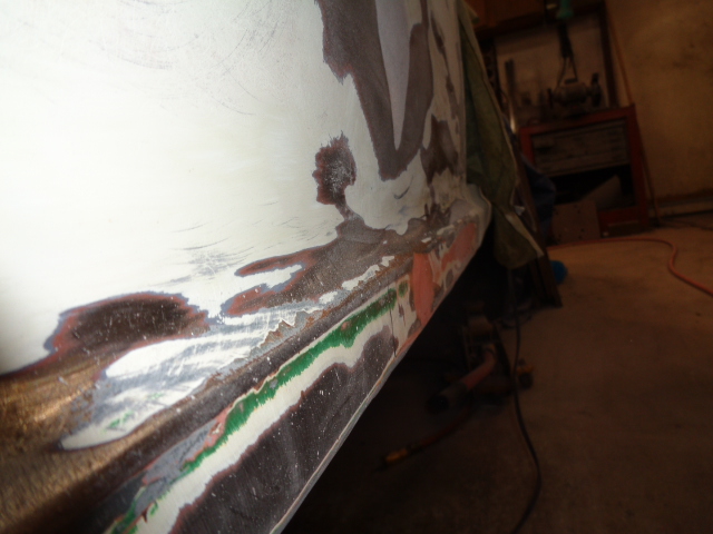

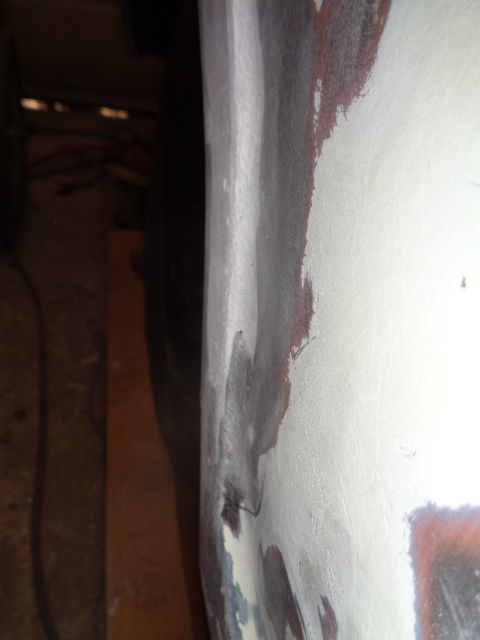

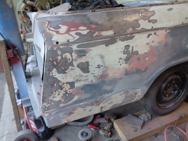

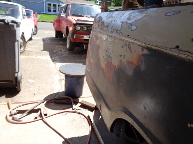

I did some sanding and added more bondo hair. this right rear panel has taken a beating, the left rear panel might be worse.
I needed to take the work truck head to a place that likely will be able to fix it, that cut into working on this truck, I will try to get more done tomorrow.
Posted: Sat May 08, 2021 9:54 pm

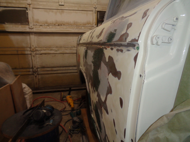

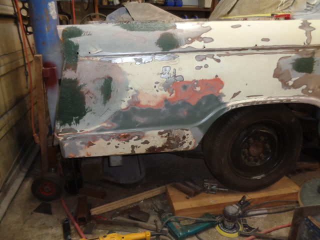

I did a little this afternoon, but something like this takes time especially when one is not very good at it, I am using a straight edge and the other side to try and get an idea what it is supposed to look like, since it is 6" longer in back of the wheel wells than an NL320 I cannot really use that truck to gauge the curves, the straight edge helps me from sanding too much off like I normally do, a couple more days and the right rear might be close, keep in mind that I still have not even sanded much behind the wheel well and the rear of the panel below the trim line, but I can get to the back of that area easier, especially below the lower body line.
Below the upper body line where it is orange and dark gray just in back of the wheel well I have barely touched, and I have not even touched below that lower body line, I am doubting I will even have this in primer by the Brooks OR show, I just don't see me getting that far since I lose interest after a few hours of sanding and the doors, hood, fenders, and tailgate need to be started, but I likely will use the new tailgate I have, so sand it, prime it, and then paint it as it has no rust at all, it is new/has never been mounted on a truck.

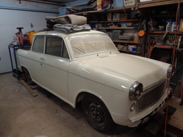

I might have figured out the photo thing, we shall see if this works, this is my U320 as it sits today.

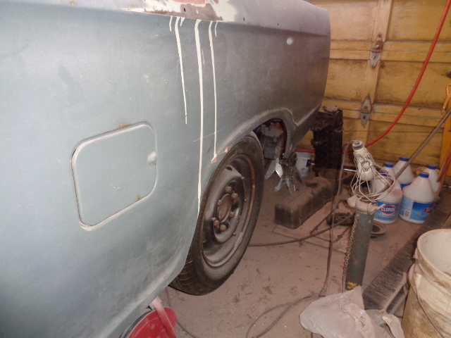

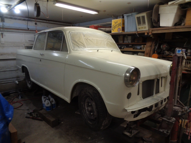

Well I was wrong, I did a little after the last post, this is how it is sitting in my garage tonight.
