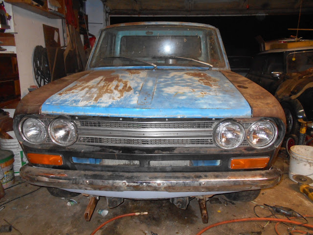

I put the valance on the truck today, I am thinking it was a 520 valance, but I made it fit, then I installed my last good 521 bumper, it's kinda dirty, and I could not find any steel wool, so I took a photo of it dirty, the fact is I have not done anything to this cab except scrape off the pine needles with my hands, I just wanted to get it running and driving, then I will worry about what it looks like, this stuff has been in my backyard for years, I just want to clean it up a little(backyard).
