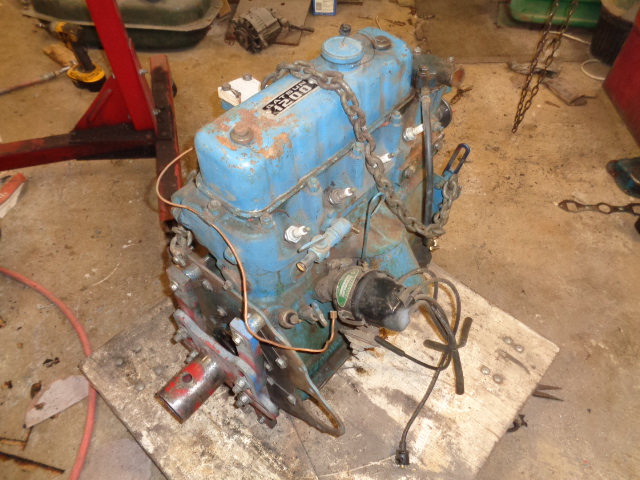

Well I think I figured out why the front timing gear cover crank shaft hole was leaking, it appears someone in the past tried prying off the pulley and bent the shit out of the cover and the section that held the felt seal separated from the cover itself.
I hunted around for another cover and I was lucky and found a good one in my 320 stash, so I made a gasket for it as I didn't have one in the kit I bought from someone in the past, but the kit had the water pump gasket and the felt seal for the crank shaft, so I am good there.
Here is the gasket I made on the good cover.
Here is the front of the engine(upside down) as I removed the oil pan to try and figure out why the rear seal was leaking, well it doesn't have a rear seal, what it has is a hole behind the bearing area and a cavity all the way around the crank that has a drain hole in the bottom leading to the oil pan via a metal tube, when I removed the oil pan I noticed a bunch of sludge in the bottom, my guess is that the end of the drain tube was in the sludge and it could not drain so the oil puked out the back, this is just a guess.
I ordered an oil pan gasket on ebay as no one locally could figure out what I wanted even with the felpro gasket number I gave them, and when they tried looking up a 1967 Datsun 520 with a J13 they told me nothing could be found for that engine either, so it's likely going to be at least a week before that gasket arrives, I guess I will likely drop the body back onto the frame, I kinda wanted to install the engine/transmission before dropping the body on, I will think about it, I need to clean up the engine and paint it also, that puke blue is awful, but it appears the stock color is a slightly darker blue, I am waiting for a reply from a guy that has restored his 320, I think the block is the same color as the air filter housing.
