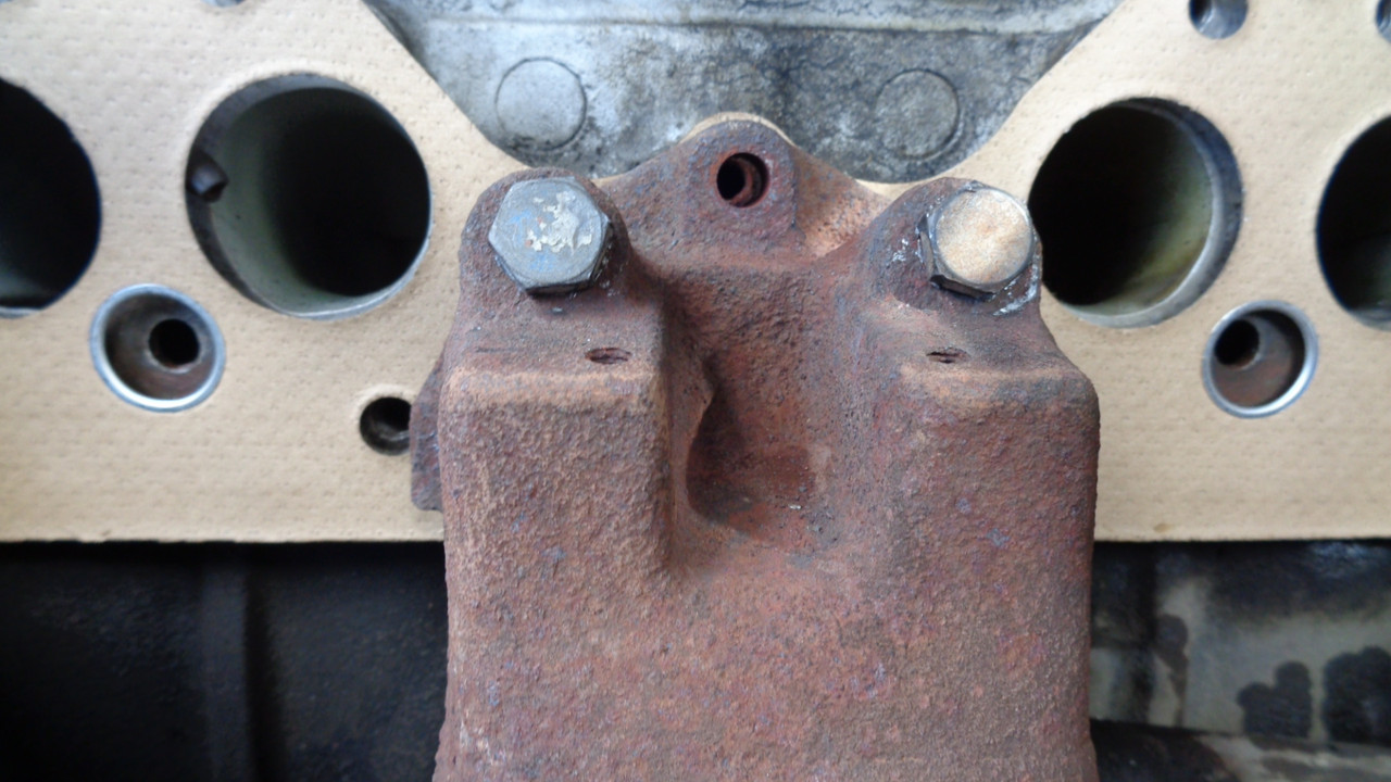

Yesterday/last night I had a thought, it was tighten the manifold bolts, I should have tried that, as when I was removing the intake manifold I found a bolt missing where the leak was, I probably should have just found a bolt and put it back together but I went the rest of the way and put a new gasket in.
While it was apart I removed these from the exhaust manifold.

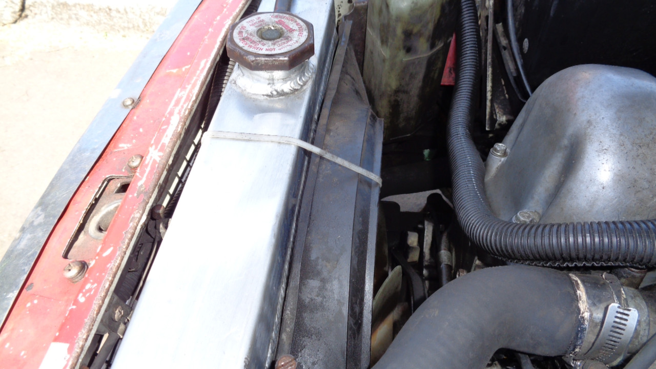

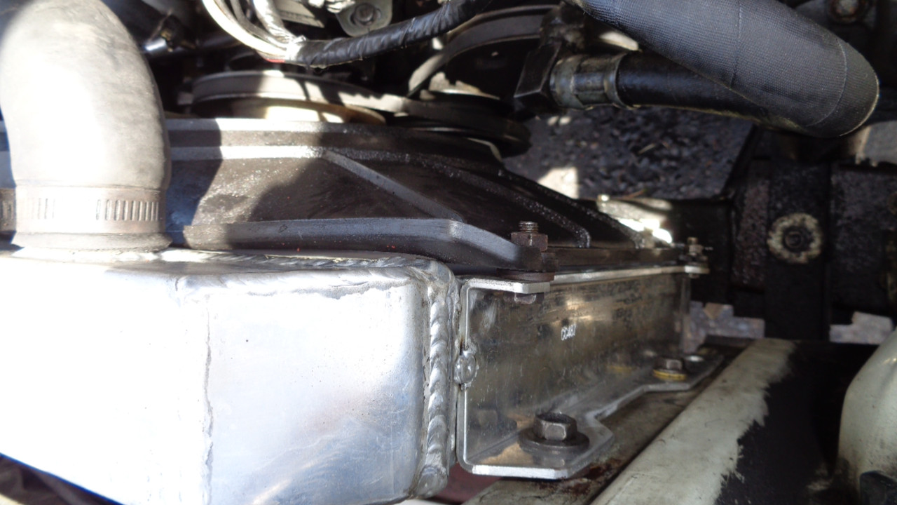

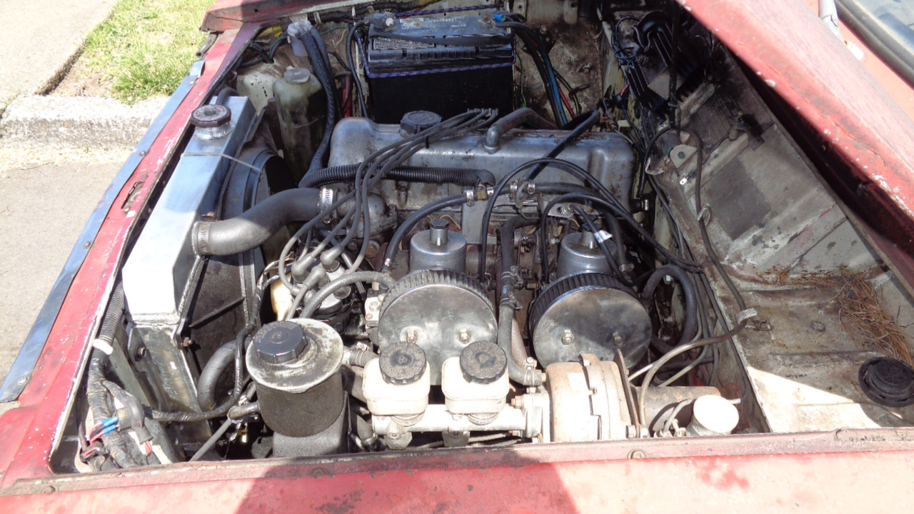

By the way, the shroud don't fit the aluminum radiator all that well, it is now permanently bent a little, I put some thick washers and a zip tie in it to try and pull the shroud against the radiator.

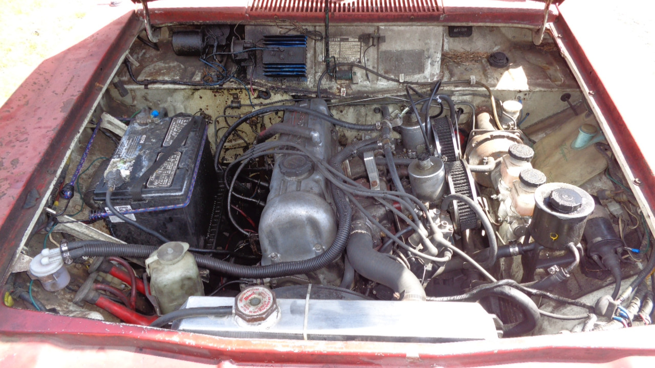

Engine compartment after put back together.

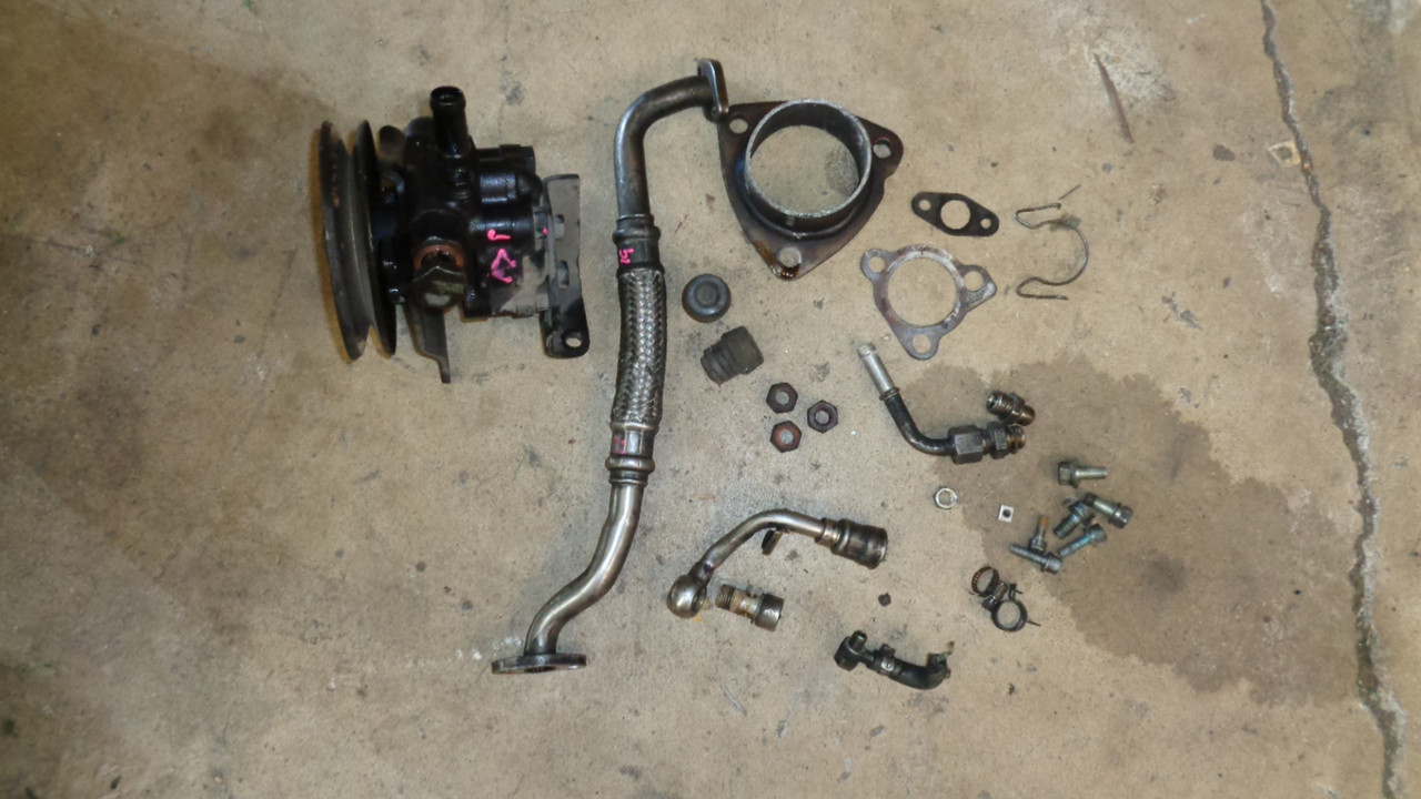

I went to the P&P and found a power steering pump in a 1987 D21 Hardbody, I then found a VW Passat with a turbo that i wanted parts off of, you would have laughed your asses off if there was a video of me removing them parts, others were trying to help me but none if us had tools, a few stopped and watched me in action, I got the parts but it took a while as I had to hunt for stuff to use to do what I needed to do to get what I wanted, a tire iron was the best tool I found, I could not remove a bracket so I had to bent it out of the way, with vice grips holding the turbo on the frame O used the tire iron in the exhaust in-feed hole to bend the bracket so I could get to the allen head bolt with vice grips to move it a 1/16 of an inch, I had to do 4 of them that way.
I paid $63.something for this in the photo below, shit is expensive now days, the PS pump was $38.00 with core charge.
The PS pump is for this work truck, all the rest of it is turbo shit I need for my friend when we do his turbo conversion.

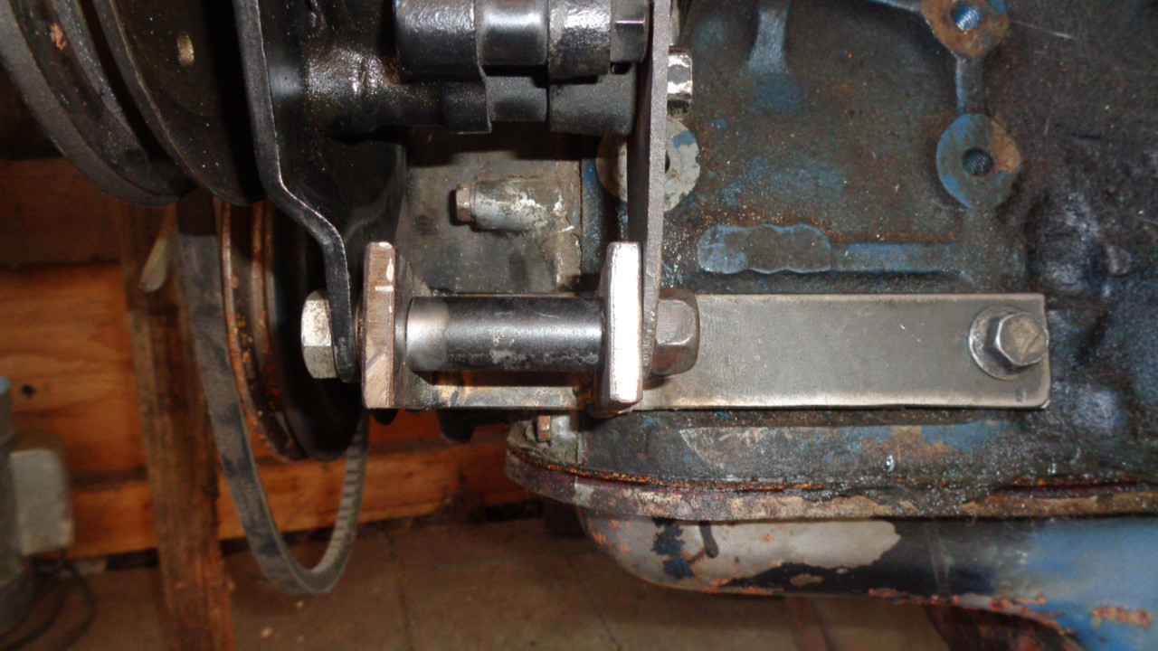

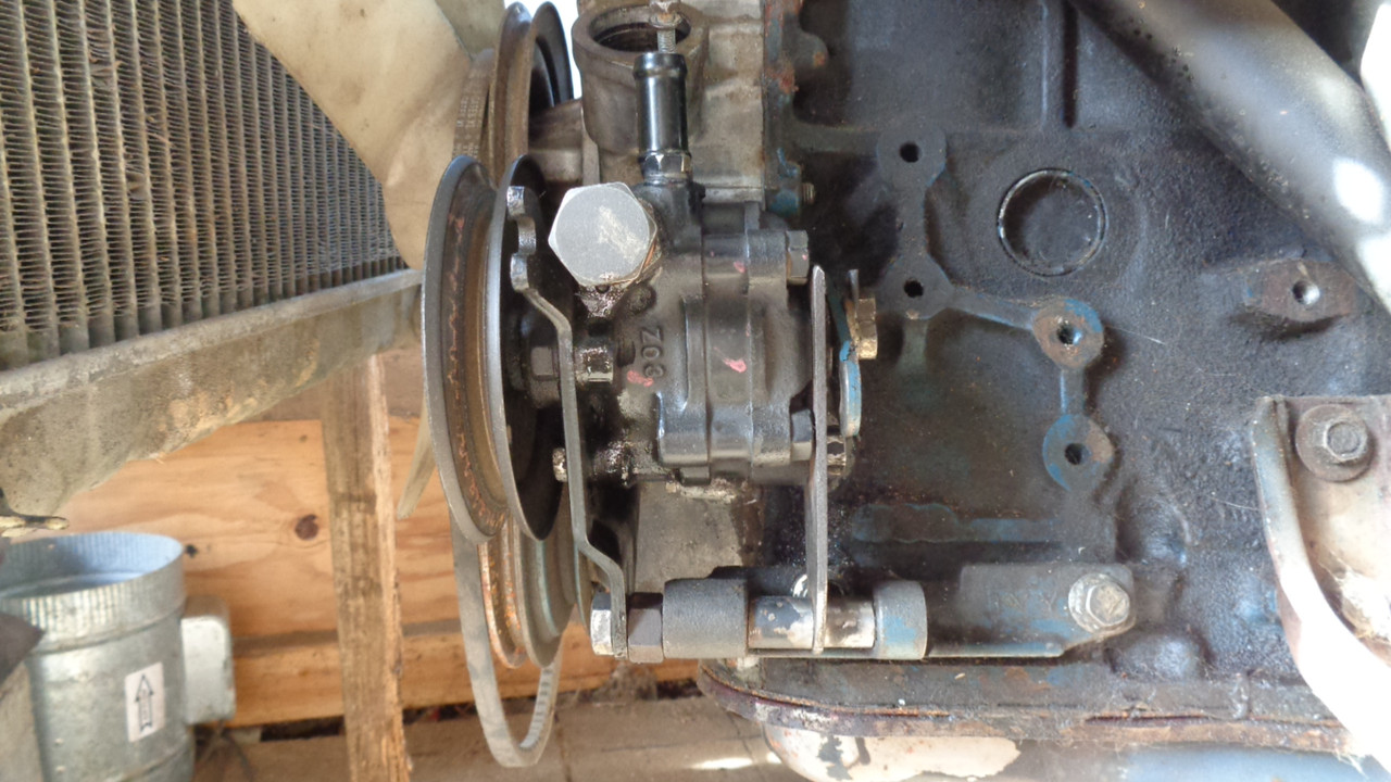

OK, so after my last post I decided to mock up the new to me power steering pump, the other one had so many back yard brackets put on it to mount it that I wanted something better, this is what I came up with, an early alternator mount from an L block, one bracket/plate on the back side, a modified alt. adjuster off of something and some shims with a long bolt on the bottom, I think it was worth the time to make, I believe this is way better than what is on the truck now.

Before I zoomed in on that 1st photo all I could think was, "Why the hell did Wayno stick a CV axle in the side of his block?"

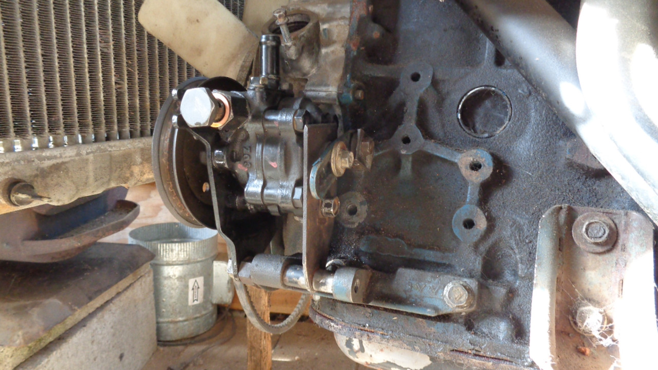

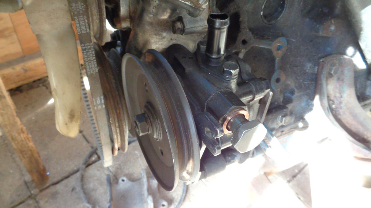

Well I didn't like how many separate parts held that power steering pump on so I made another bracket to hold it in that was way more simpler, a washer and a sleeve in the middle, it's way easier to make something when it is in the position you want it in already, I was off by a washer thickness.
This bracket was made to fit while the other I used sleeves and such to position the PS pump, this is another reason I changed my mind and made this bracket, after it was done I realized it is slightly higher, I hope this doesn't create an issue, the black drain connection pointed up will be replaced by one that points back towards the firewall unless it will work the way it is.

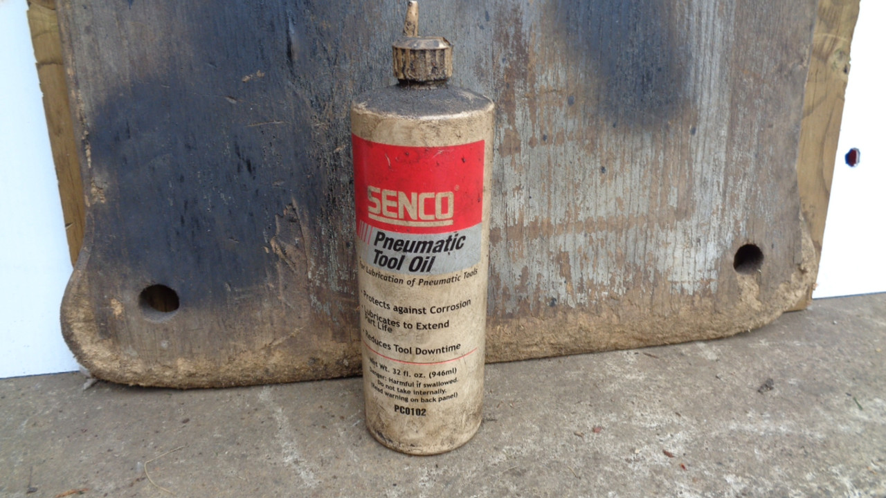

I put 2 or 3, or maybe more drips of the proper oil in all my air tools before every use and have since I bought an air compressor, this bottle(see photo) has had a lot of drips of oil in it but it is almost empty now.
I have used this stuff on all my air tools, sometimes early on I would fill the end of the tool fitting till it would hold no more then pull the trigger so it would flow into the tool before I connected the air hose, sometimes the air coming out of the tool would soak my hand with oil, it still didn't help them 3/8 drive ratchet wrenches, they just quit turning altogether or they get loose and only turn some of the time, I do not have trouble with any of my other tools, at lest tools that were not lent out.
