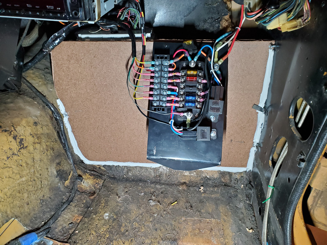

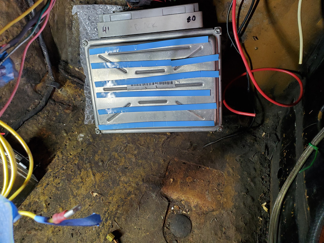

Several hours today. Dissected the harness and moved some things around as well as added a couple wires and removed a bunch of others.
Then I wrapped it up and laid it out just like it'll be in the car.
After that I fed everything between the heater box and the firewall from the right to the left, then the front half through a hole next to the gas pedal.
And that's where I left it. My O2 sensor and knock sensor wires were just a little too short so I'll need to lengthen each one. Then hook up the interior side, mount the PCM and build the accessory panel.

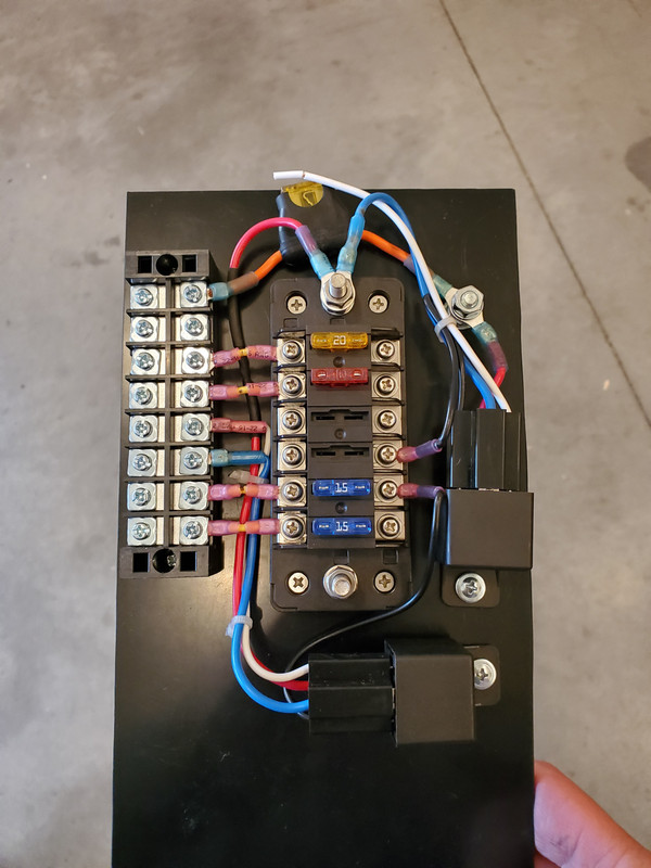

Nothing major today. Lengthened the knock sensor wire and rerouted the O2 wire to reach. Prepped the copper oil pressure tube and connected the engine end. Replaced the gauges in the panel and ran all the wiring to the area. Indicator lights are on order. Little things add up.

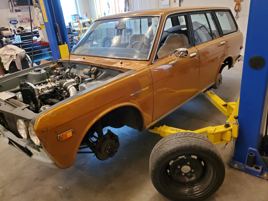

A little closer...

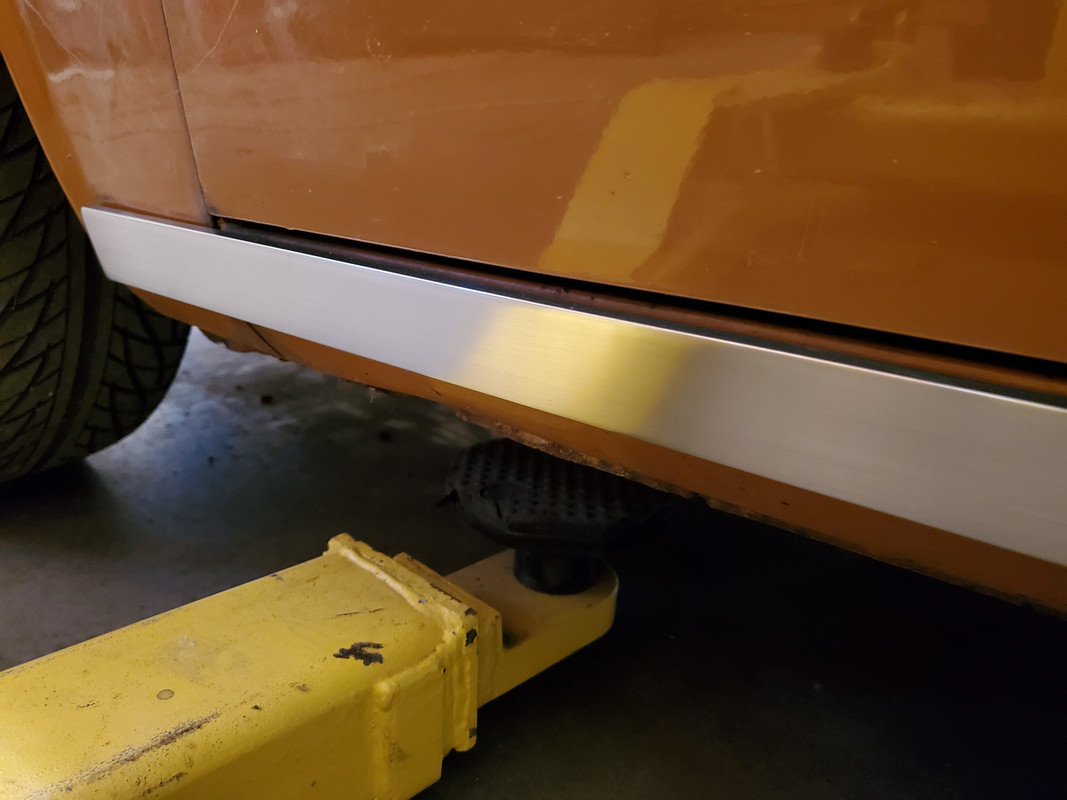

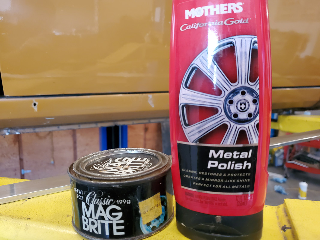

Moved on to the rocker trim. I bought 2 pieces of 1 1/2 x 1/4 x 6' aluminum flat bar off Ebay. Cut to length, profiled some curved angles on the ends, sanded, polished, and attached.
I found that Mag Brite in my dad's stash with a $3 price tag from GI Joes. It's probably older than I am. I honestly didn't want a mirror finish because I think it would stick out like a sore thumb. It's reflective but mainly I just wanted to cover the holes and add a little contrast.

So it appears that some Datsun 510 wagons came with trim there, obviously I don't know much about 510s.
It looks good. :thumbs:

That does look good! And super clean wiring too. It looks like a sleeper now.

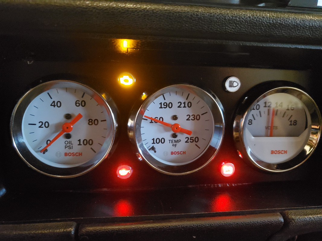

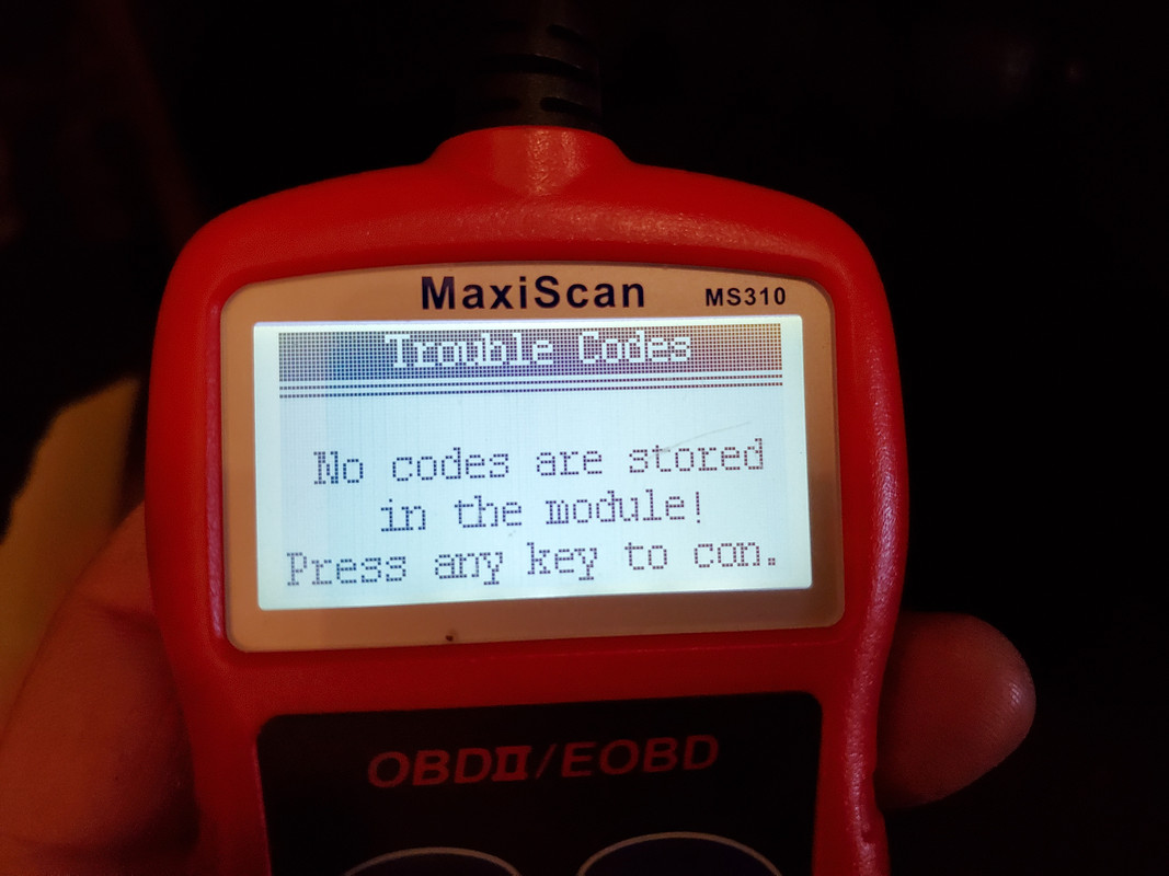

My indicator lights came in so I was able to put the bash together and fire it up long enough to warm it up.

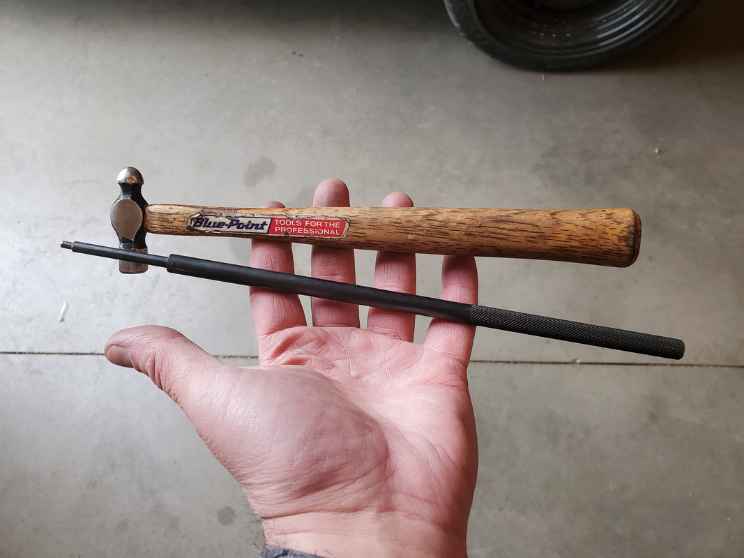

It still had the miss and eventually set a P0304 code and turned the fan on, so I know that works too. I took my stethoscope and put the probe on the top of each injector. #1, #2, and #3, tink tink tink. #4, thuh thuh thuh. So I took my dinkiest hammer and a long punch and gave it a few taps. The engine smoothed out, tink tink tink.
I ran it up to temp and the longer it ran, the better it ran. Ran out of energy and didn't get the clutch or brakes bled.

I like that gauge layout. The addition of the little lights helps it a lot.
Also that little hammer is adorable.

Not much to update. I went over today and polished off a couple electrical things. Got my charge light to work correctly. Apparently I needed to run my old warning light in parallel (behind the gauges) in order to make the new LED indicator happy. I also finally installed an oil pressure switch so that warning light works now too.

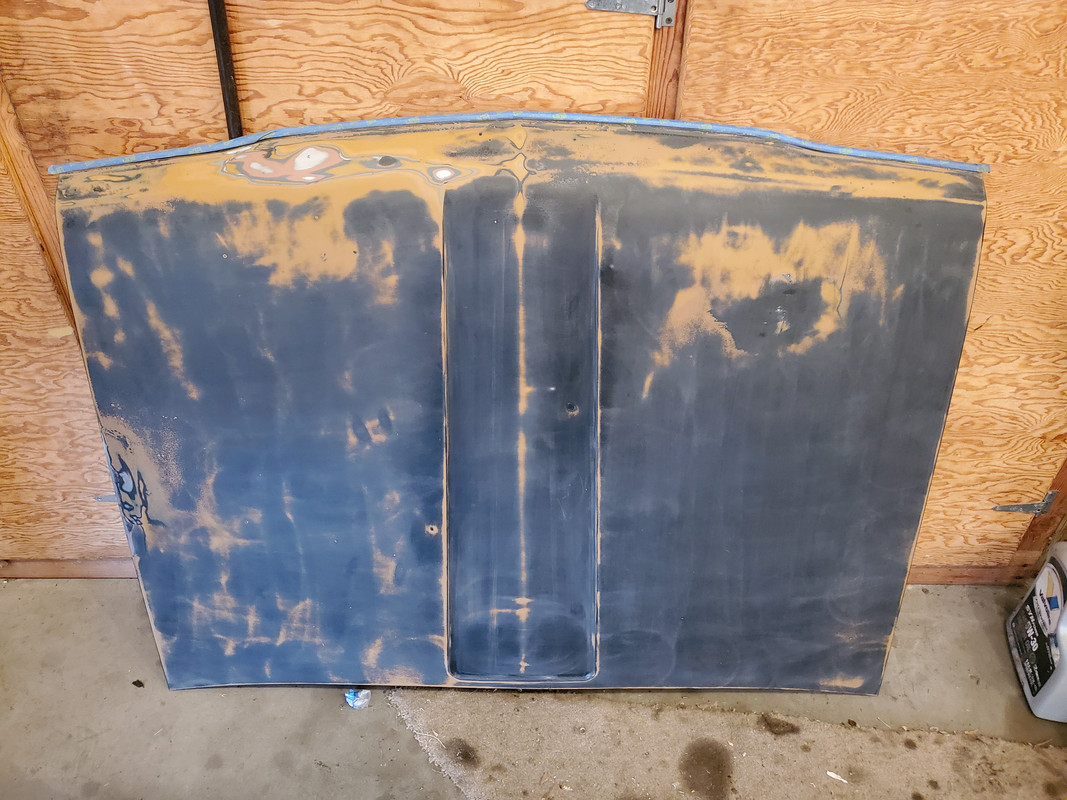

My dad must have gotten bored and sanded my hood down for me.
