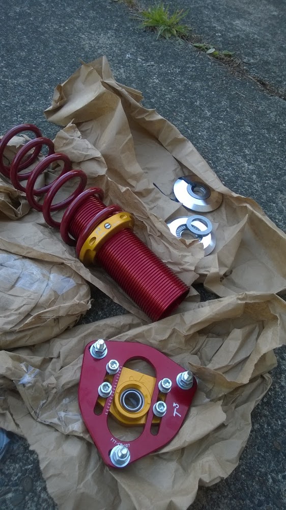

Well...

And you won't be using those BAD ASS camber plates?
