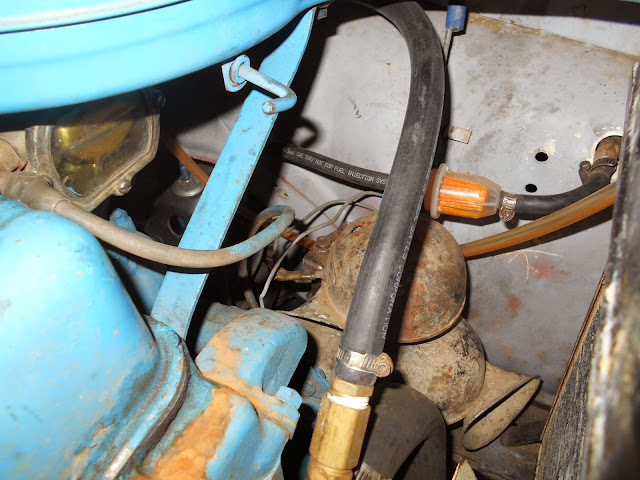

I hooked up that heater core this morning, it doesn't leak at this time, and it gets warm right away.
Firewall to rear of block.
Out of firewall to water pump outlet.
Now I am going to make an outlet off the bottom of the air control assembly, it's that oval hole, I need to somehow connect that hole to the defrosters, I have a couple ideas.

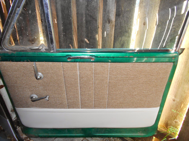

The drivers door is done, I used the clips I got from Todd today, they likely will work better than the double sided sticky tape I used on the other door.
I will likely take the cover off the other side and use clips on it also.

It's just temporary, just to get it to the Canby show, I am going to remove the passenger door card and use the clips, that double sided tape doesn't work so good.
The clips actually worked good, thankyou.
