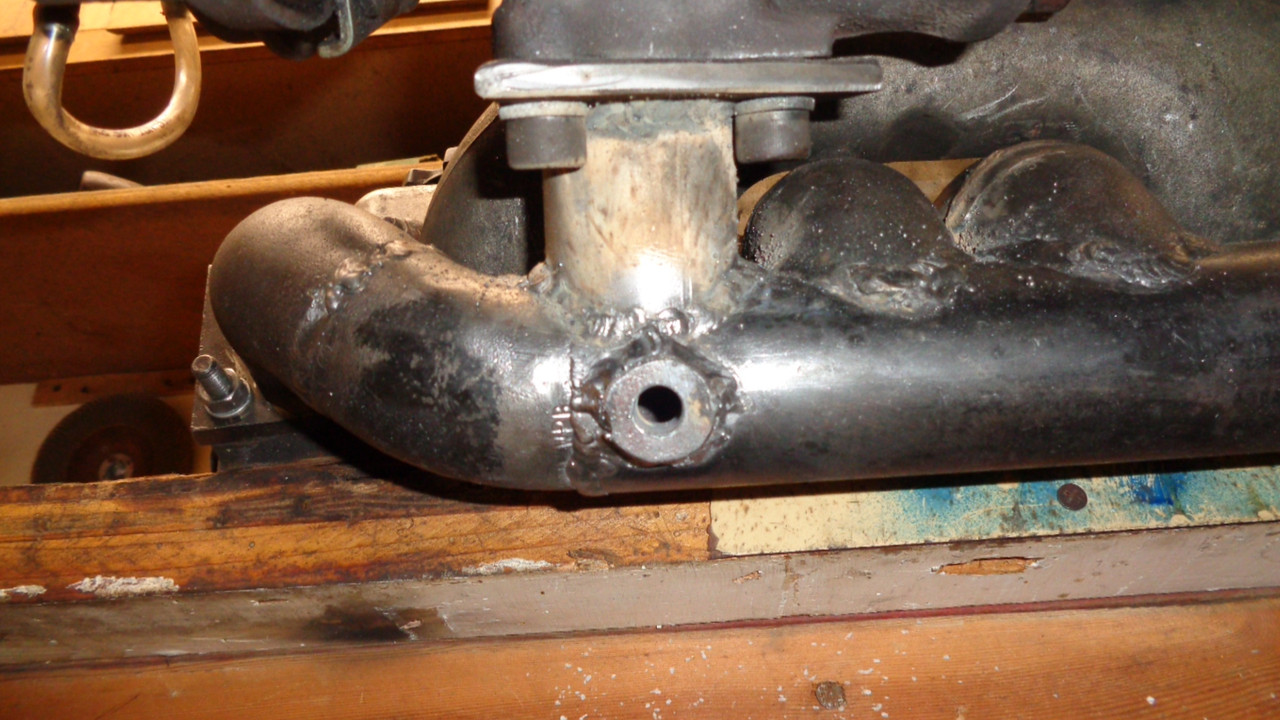

I didn't do much today, my wrist is hurting bad, I suspect it's arthritis, but I put the EGT probe bung in.
I don't know if that is the right place to put it, but the tube holding the turbocharger is thinner and it would make getting to the bolts harder and make it possible to break the probe if I slipped, so I centered it on the turbo mount tube.

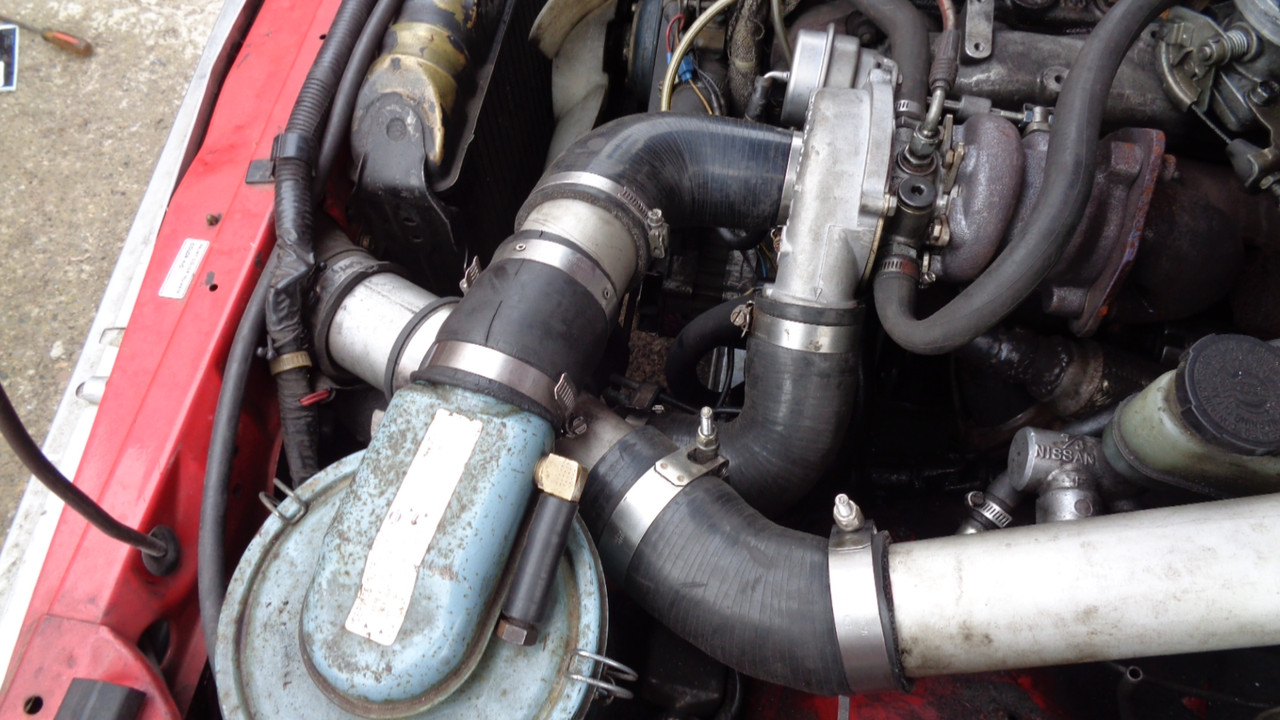

I did connect the inter-cooler into the system this afternoon after I got the vibration thing figured out, everyone knows about how I was saying earlier that the turbo was clocked wrong and how the waste gate was at a weird angle and how I fixed it by drilling a hole in the middle of the bracket, I had to do that to get the outlet of the turbo discharge connected to the piping going to the intake, well when I piped in the inter-cooler today I had to undue what I had done as it was clocked perfect for the inter-cooler, before I didn't think there was the room to do it, but I made it work, it's tight but I got it all connected and took it for a test drive.
The truck runs better than it ever has now on the 5 mile test drive I took it on, plenty of boost and quieter then has ever been, I gave it some pedal and got just over 70mph briefly(little tires) at around 8psi, and it never reached 1000 degrees(EGTs),and I seen 15psi a couple times getting on it, it was great, best it has ever been, but the 521 kingcab diesel is still better.

That's awesome! Looks good under the hood. Well laid out considering the amount of room to work with.

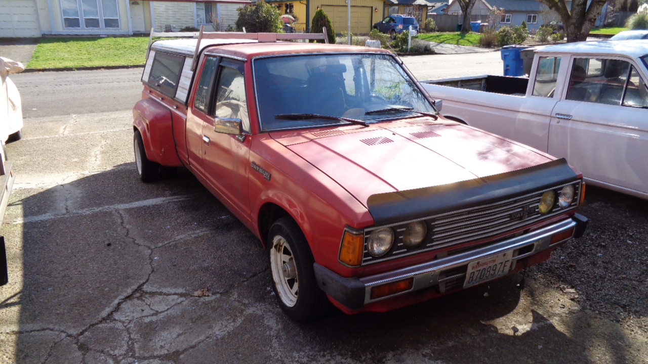

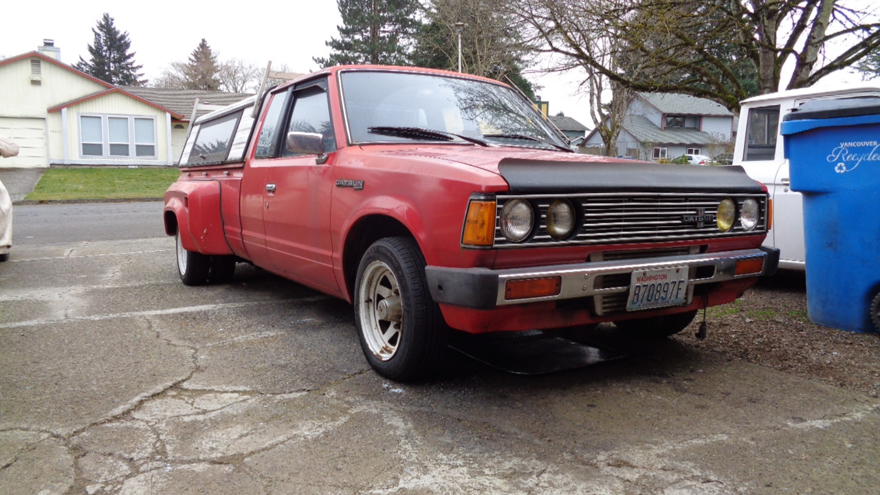

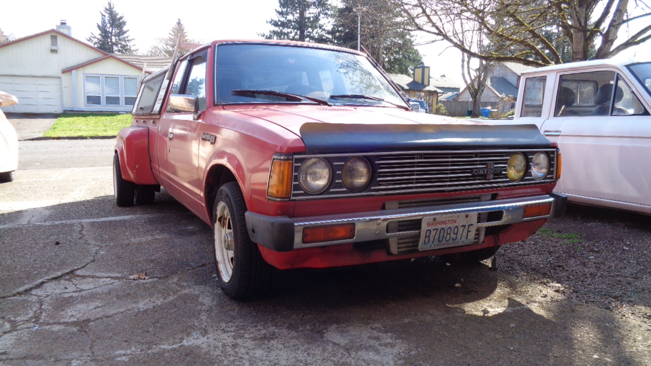

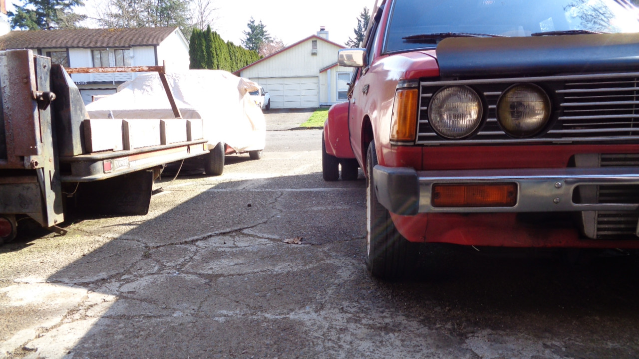

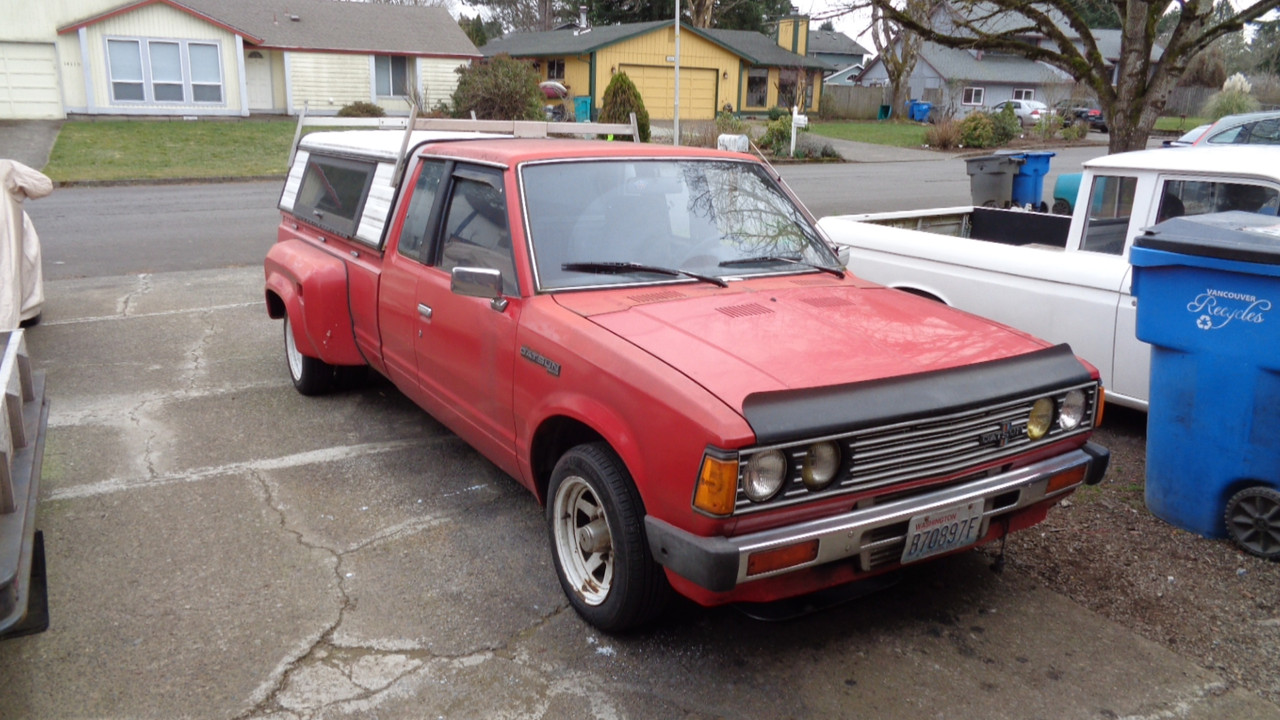

I was cleaning up the back patio and got an idea.
Does this look goofy or is it just me?
This is what it looked like before from a distance.
Am I so used to the rear wheels being 3 inches inside the rear fender wells that now it looks strange to me, here is what it looks like now, I filled it up with 6 gallons of fuel and it still doesn't rub, I can't fill it all the way up as it leaks if I do.
The only issue if it is an issue is it takes 3 sets of lug nuts to hold these rear wheels on now, the spacer, the inside wheel, then the outside wheel, I drove it and no new vibrations, here is what it looks like in the back, it is made for this, but not these rims.
I kinda wish they were 1 inch less wide, but this is what I have, these 4 spacers I have came with 13 dually rims, the problem is that they are custom rims and the USPS lost one of them for me and they were not interested in finding it for me, I kept asking and asking and they just wanted me to go away, so I have 5 rims instead of the 6 rims I need for a complete set to cover all 4 corners, but maybe I can get some kind of use out of the parts.
The back wheels are pushed out 4 inches farther than they were on each side, that is 8 inches total wider stance, I should have taken a before photo but I didn't, it just looks so strange to me.
