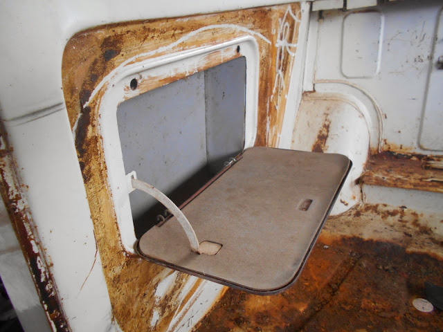

I am only worried about one area, the back seat side panels were just vinyl glued onto the metal, the material is very thin, so I am wondering if the ashtray and the section that drops will look stock with the cloth material on a thin board, this is the red drop down tray I am referring to, the tray is actually counter sunk a little.
And this is the rear ashtray that goes in the back, it's in really good shape considering how old it is.
I will tell Todd to look at these photos before dealing with making these rear parts, just to make sure he understands my description of the area.
