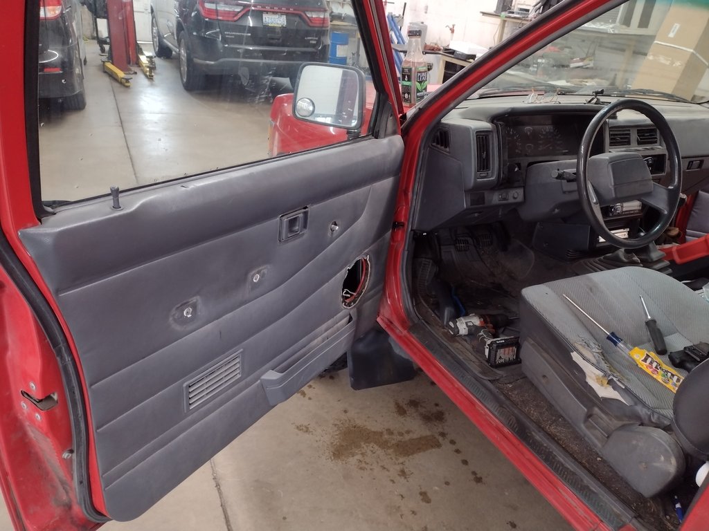

At the shop, preparing to install all the new window channel/door rubbers I hadn't gotten to.

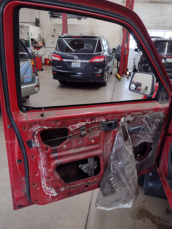

I was debating sliding the new rubber in past the window, but I'm pretty sure since it's nice and fresh it's not going to slide as easily as the old hard rubber. I'm going to do the proper thing and remove the glass.
I can't believe I was thinking I was going to be so lazy to not remove the glass because that literally took about 30 seconds to remove LOL.

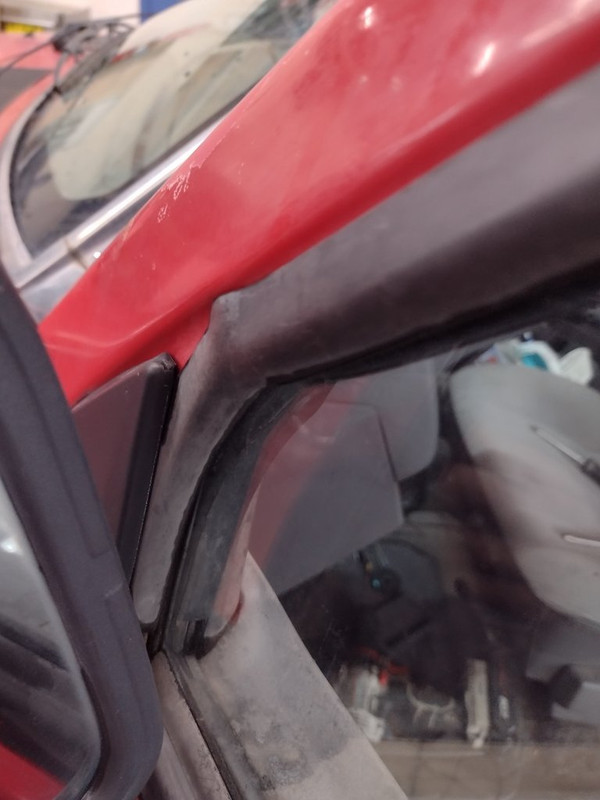

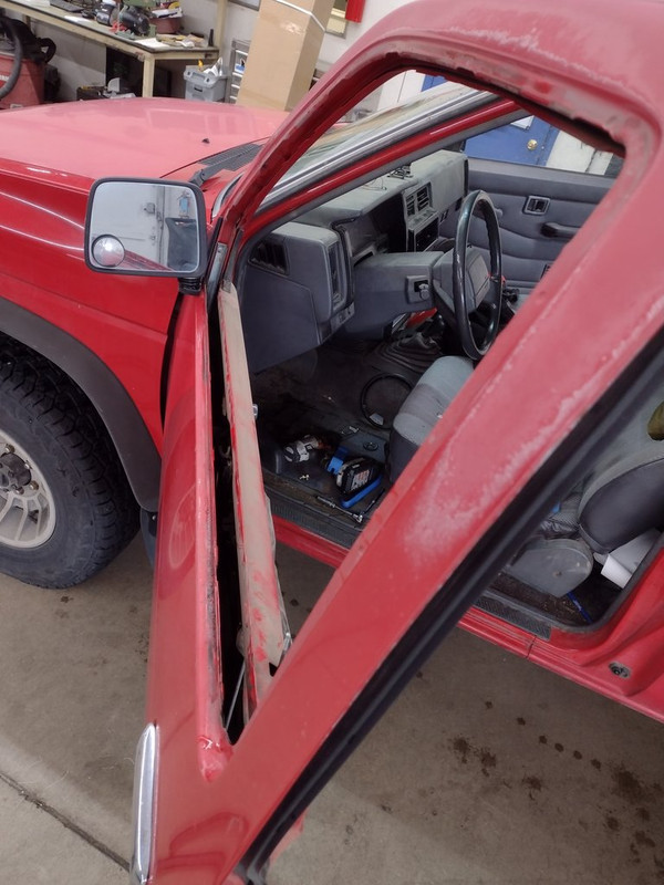

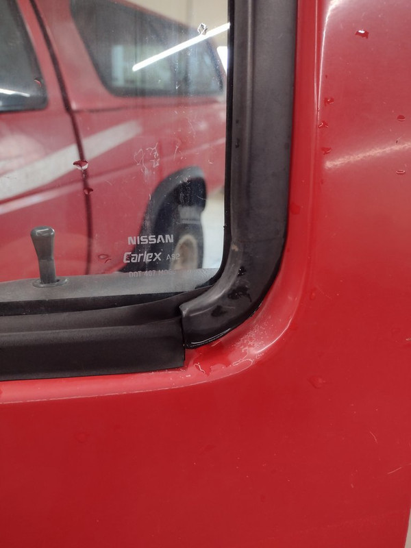

So I also got both the rubber scrubbies for the glass. The one fits on the door panel and has a bunch of little metal tabs that get pushed down so basically you pry them back up, pull it off stick it through and then fold over the tabs. I'm trying to figure out on this outside molding if I want to pull it off first or do the other rubber inside piece first.
And for the outside rubber glass edge molding it gets pulled straight up from the inside of the door channel don't try and get it from the outside because you'll ruin it. The metal the rubber is formed around deforms quite easily.
Posts: 2366
Re: Gracie II the D21
#158
Even trying to be careful it's hard to get these off without bending that strip. There are six little cutouts that anchor it in to the door edge. I'm thinking inside rubber goes first, then outside so it lines up correctly.

#160
