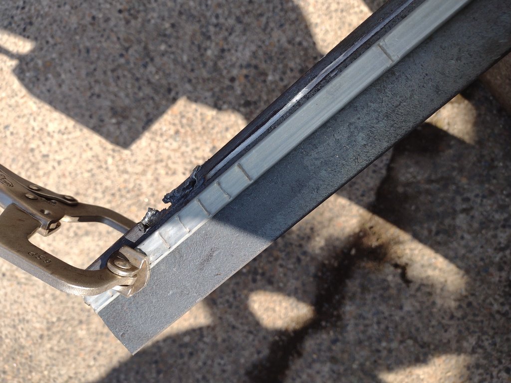

Well that took forever and a day and half a cut off wheel but it's done. Now I just need to make a couple other holes on the other side for vice grip attachment when using the bending brake.
Posted: Sun Apr 24, 2022 9:22 am
Did a test fit it's almost enough just going to take the grinder and grind down the inner edge.
Posted: Sun Apr 24, 2022 9:55 am
I need to remove the points but you get the idea. It's just about ready to get drilled and then put in the box van. And yes I could have just spent this piece already that I need to make but I've been wanting to mount this for so long I figured I'd just finish it first nicer than bending it in a vise.
