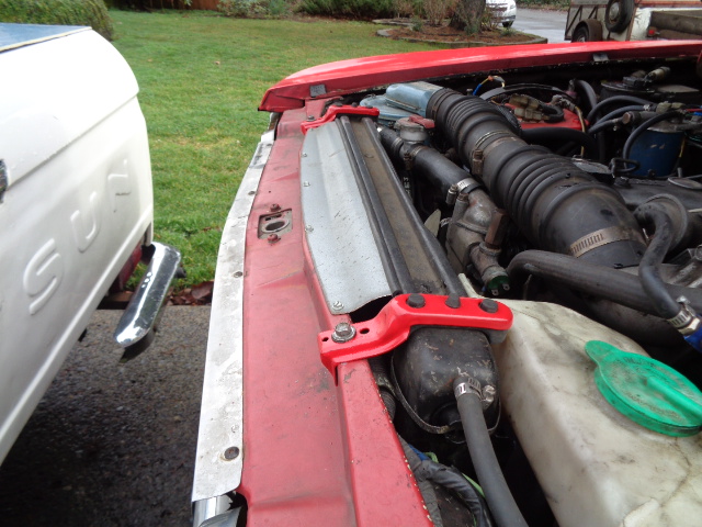

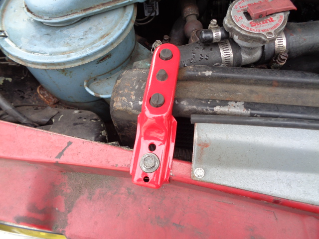

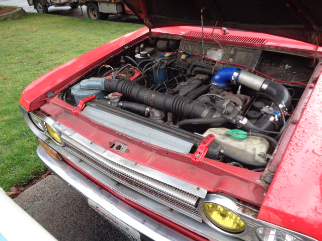

The second thing I did was make the radiator upper supports cleaner, the photos will show you what I mean, I did both sides.
I painted them but are going to let them dry overnight, I will install them between the rain storms tomorrow.
