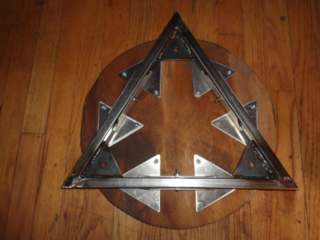

I should have bought this container of springs over a decade ago.
I paid just under $9.00 for the 200 springs in this container, right next to this box was a wall of packages of 2 springs that they wanted $4.99 for each package(2 springs, that is crazy) and it did not matter the size of the springs, tiny or large, $4.99 for 2 springs.
Here is what I used 3 springs for, to keep the triangles pointed a certain way.
I now have lots of SU carb springs.

I was checking clearances with what I have made so far and was unhappy with the mirror height, even though i was easily over an inch lower that my 16" dob I made a year ago I wanted it to be lower, so I made a new primary mirror frame to mount the mirror cell to, this one is 2" smaller.
I made a wood jig to hold my metal pieces at 90 degrees for welding
Here is one of my welds, I am using gas so it looks better than my flux core welds.
I ran out of gas and had no flux core, it was after 5pm and I was wondering what to do and I looked at my welder, I have an internal bottle that I have never used, it has no gauge so I did not know if it had anything in it, but I loaned the welder out over 5 years ago and it appears the guy filled it at some point, that was great and I was able to finish what I started.
Here is the finished base with the mirror cell installed, the old base is next to it so you can see the difference.
